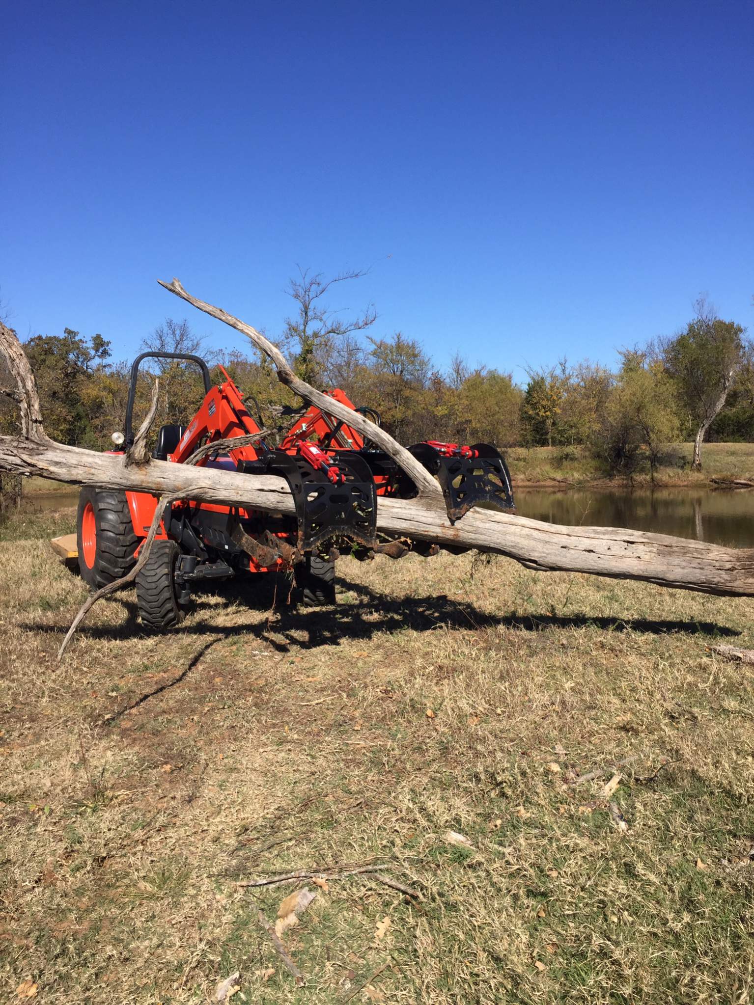

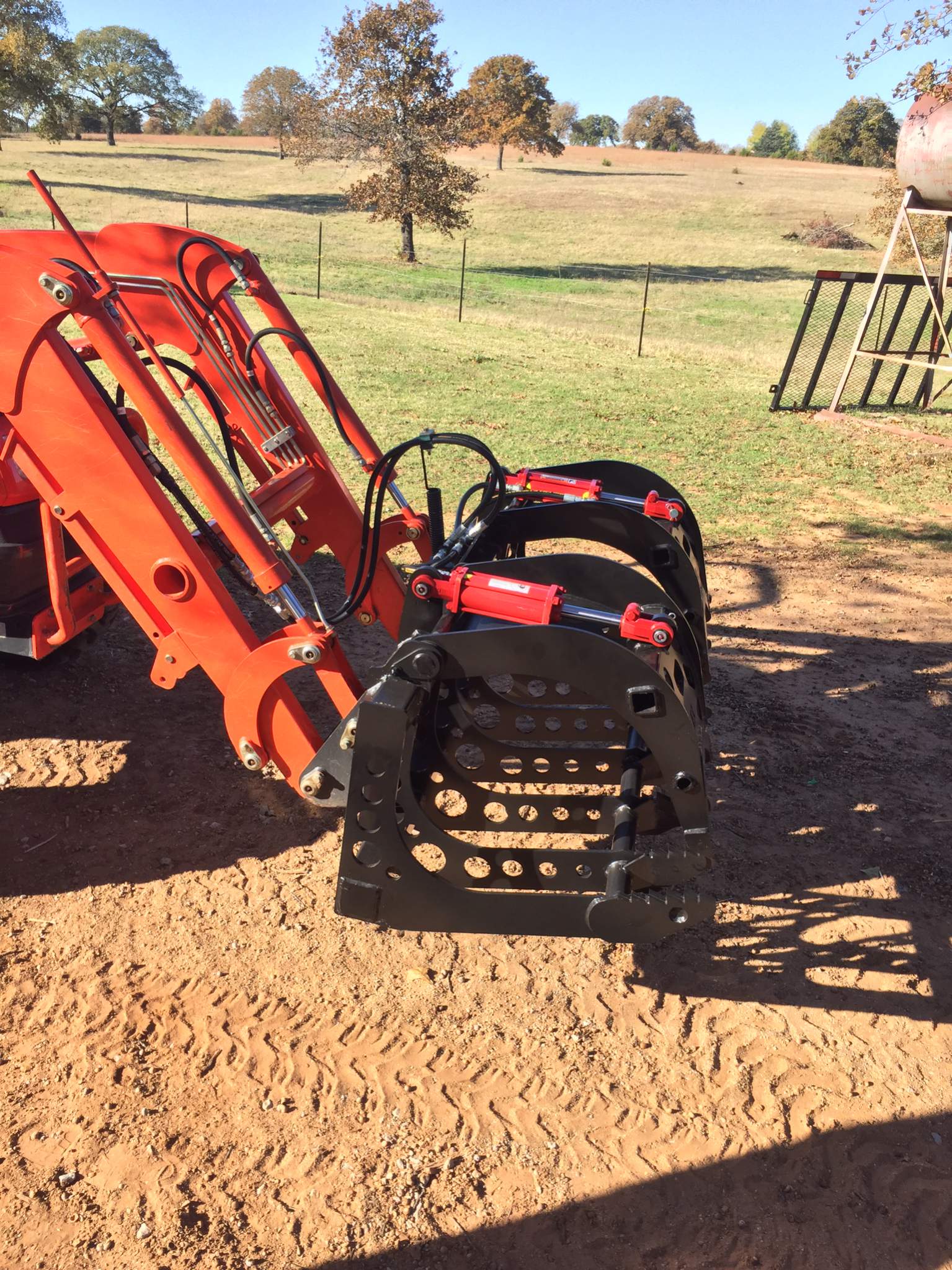

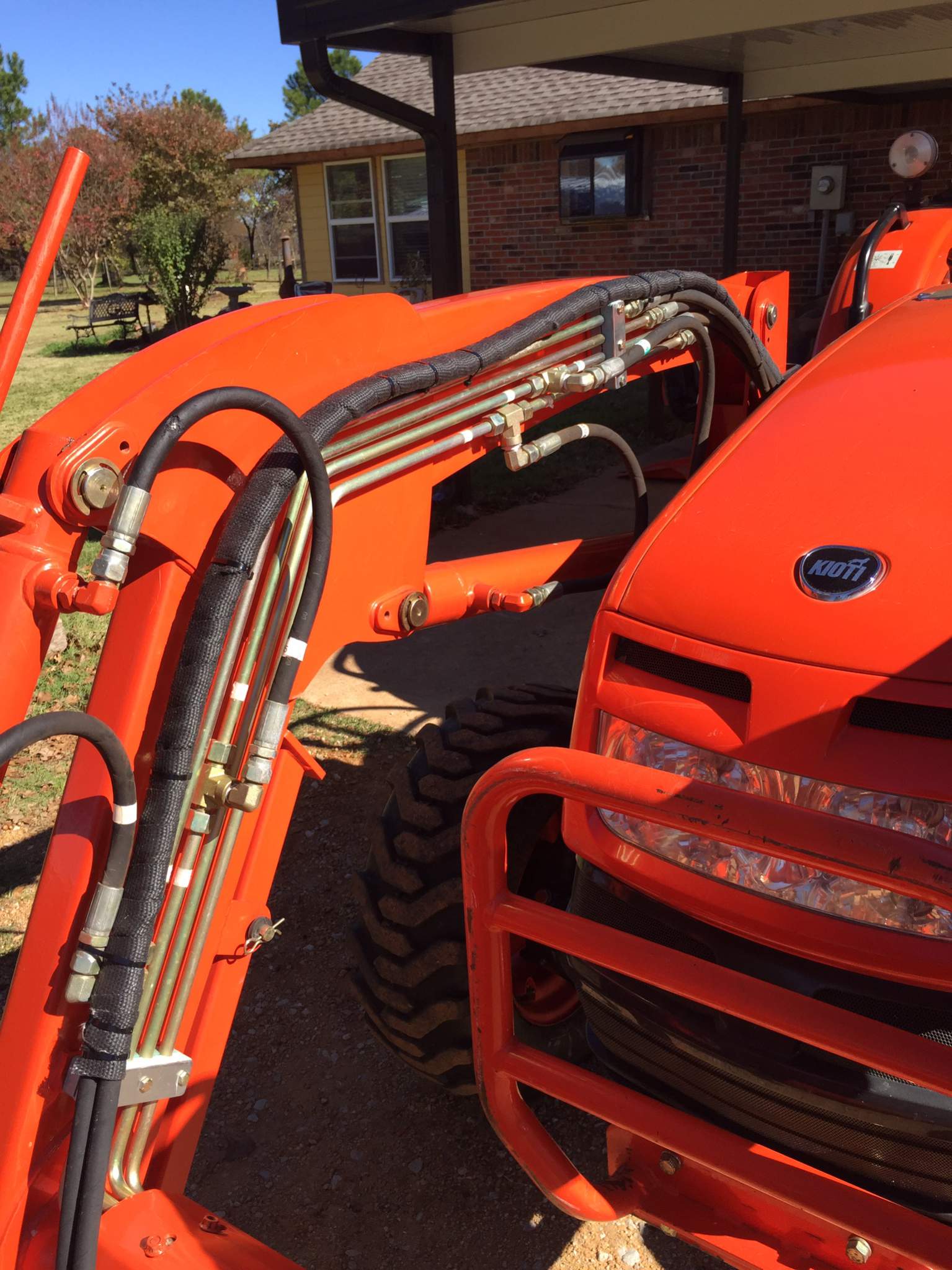

Just installed my new grapple and 3rd function remote from EA. Installation was not difficult. Customer service was great. Took a couple of ideas from folks here and did a few of my own installation tweaks. Most notable changes was I used heat shrink tubing on the wiring instead of the wire loom supplied. Looks great! I also bought some motorcycle exhaust wrap from Auto Zone to wrap the hyd hoses going to the grapple. Used it today to clear a lot of blow downs and brush. Worked GREAT!
Here's the but..... I took about an hour break, came back out and started the tractor and there is a 3-5 second delay in the 3 point raising. I'm not sure if this is an anomaly, or could have something to do with the installation of another valve. I sent an email to EA, so hopefully, it's something easy and not too uncommon when doing this mod.

In the first picture it looks like there is a badly worn lift cylinder hose. Thanks for the tip on using motorcycle exhaust wrap.
