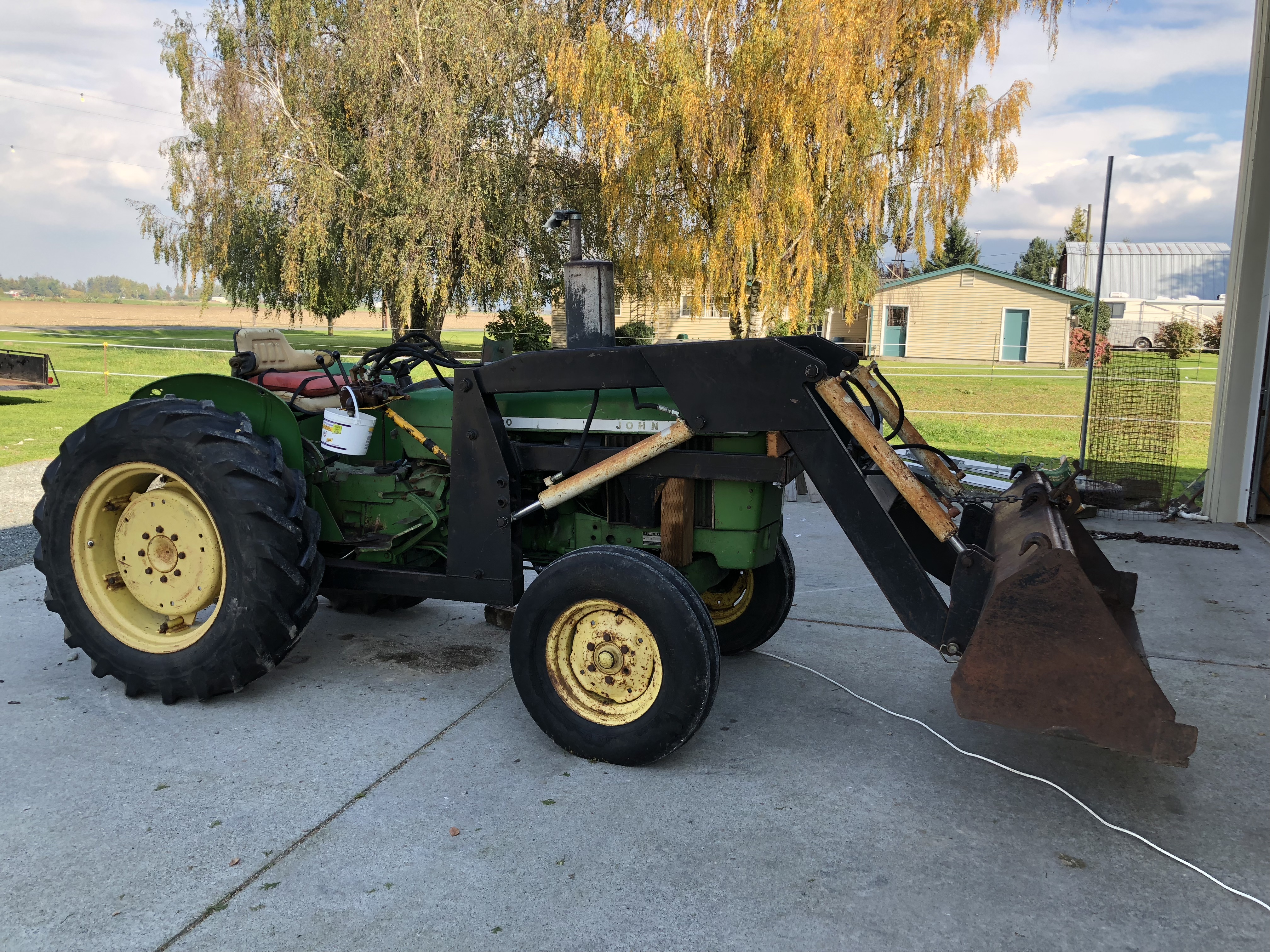

Inherited this tractor from my father in law, just added the loader this week, I am going to need some help figuring out how to get the hydraulics figured out... any suggestions? Thanks in advance!

Yes, I picked that loader up from a walnut farmer in Chilliwack BC. I just got it installed last weekend. I already have the service manual for my 820 but I don’t know much at all about hydraulics and the manual doesn’t go into details on that. I just posted in the hydraulic forum on TBN I’m hoping for some help there.
   / New guy from Washington #10
On the loader you should have 3 pipes. The designations vary a little but there should be an IN port which is the primary feed. There should be a TANK port which needs to be connected to the transmission tank. There should be a PYB (Power Beyond or Out) which needs to connect to the 3 point hitch hydraulics. Basically you interrupt the line from the pump to the 3 point. Take pump side to IN and 3 point side to PYB out. Then a 3rd line goes to the tank to expel what you use in your FEL.
THIS IS ASSUMING YOUR FEL HAS THE POWER BEYOND FEATURE for use in an Open Center hydraulic system. Power Beyond is a feature of the hydraulic spool valve and usually just a fitting that redirects out port hydraulic fluid. Likely you have this. What tractor was it previously on?
I am taking it you are up near Bellingham or Lynden area since you got the FEL in BC, Canada? Beautiful area up there.
