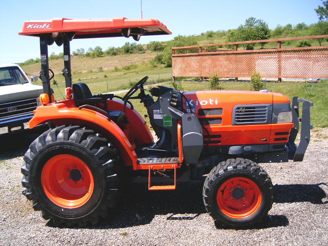

Thanks for all the info. I think the DK40SE HST would be my best choice. This way I know I can pick up any bail on my farm and lift it in the barn. How do yall feel about putting fluid in the tires? Will that void any warranty? Also do they sell a roof for the Kioti痴 that mounts on to the ROPS?:thumbsup: Great site for info.
   / (New Guy here) Which Kioti?????? #6
Kioti does have a canopy that mounts to the ROPS.
This is the one on my DK 35

Thanks for the information DK35vince
