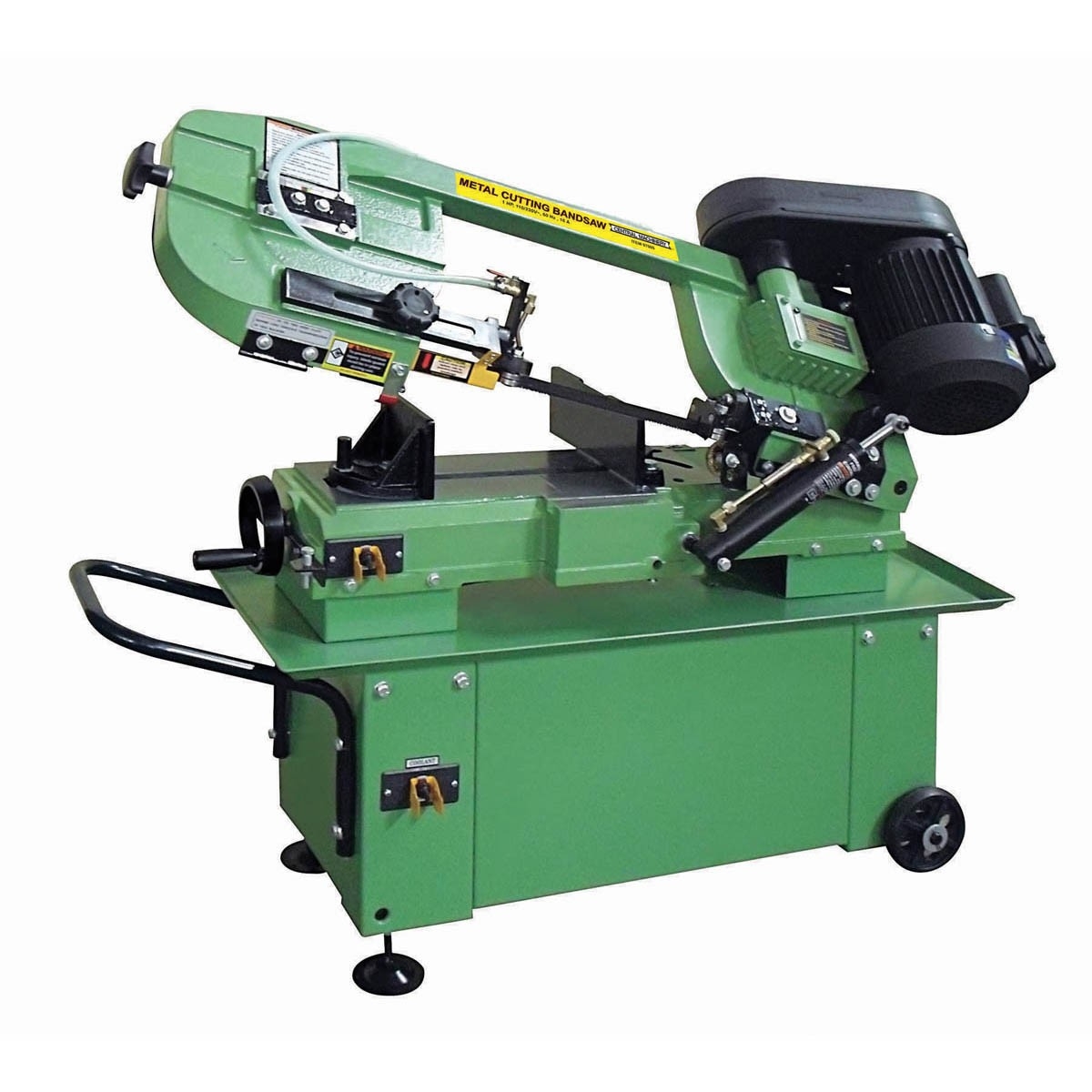

There is an epic thread on here " Harbor Freight Tools that don't suck". I don't have time to go through that whole thread to to find information about an item I am considering. That item is a 1HP Hydraulic Feed Metal Cutting Band Saw. It can be had for a little under $800.00 after tax and freight is added. I want to use it to gang cut some .125 wall steel tube. Anyone ever owned one of these? How long do you think it would take to cut 9 pieces at a time 1.5 X 2 inch rectangular tube?

The only negative comment that I have heard is that the electrics are cheesy. For instance, the limit switch that should stop the motor once the carriage gets to the bottom sticks or doesn't work, and the motors have a fairly short lifespan. The other things I have heard are positive.
If you are in an area with enough machinery for sale, Rockwell, DoAll, and other industrial saws are for sale used at that same price point. You might look on craigslist.

+1 on the Craigs list - I bought the Jet saw new about 1-1/2 yrs ago, paid just over $1100 - saw the exact saw on craigs about 6 mo. ago for $650, "lightly used", looked like mine did when I first took it out of the crate!!?! Called several friends with a heads up, none needed/wanted/could afford. SOMEBODY got a fantastic deal.
Nothing cheesy about the Jet, other than ALL these saws are made assuming you only want to move them in a straight line (4 wheels, NO casters, you "steer" by lifting the light end and moving it sideways)
"How long do you think it would take to cut 9 pieces at a time 1.5 X 2 inch rectangular tube? "
I keep a Lenox bi-metal 14tooth blade on mine because I tend to cut more thin stuff than heavy - but even the Jet might not like a 3x3 stack of material, because the vise tends to be slightly looser at top than bottom so it might let things slip a bit. To counteract that, you can clamp the bundle with an extra clamp if your pieces are long enough to get the aux. clamp away from the saw frame a bit.
Rough guess on your material size using a 14 tooth GOOD blade - probably around a minute, two at most.

if possible, blade should have 3 teeth in contact with material so thinner wall, higher tooth count.
Adjusting feed rate on hydraulic feed so saw isn't bogging down but IS cutting well - look at material volume being ejected at the cut. This kinda takes some tweaking.

I would just add that if you need to cut stuff like this regularly a fluid-cooled cut is a very durable if slightly messy improvement. +3 for Craigslist. People get rid of stuff for MANY reasons besides it being worn out.
