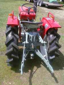

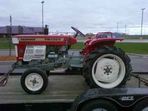

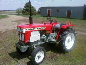

Hey all, I have really enjoyed reading on here and I have a couple of questions. I live in NW MN and there is a guy not too far from me that has listed a YM1500 and a YM1700 for sale. He is asking $2500 and $2700 respectivly and they have 600 hours and 1000 hours on them. I am really just looking for something to mount a snow blower on to clear a 100" driveway which is flat, and possibly add a FEL to do some light work around the yard. Is this a good price? Is there anyway to know if these are rebuilt? I have read enought to know that I don't want a vietnam rebuild. I talked to him on the phone and he told me they both came with the farm he bought a couple of months ago and he has no use for them. For what little I want to do is this a safe buy?? Any input would be greatly appreciated. Attatched are a couple of pictures.

Simple unfounded opinion: Those gorgeous paint jobs on 30 year old tractors makes it likely they are VN 'rebuilt', ie repainted. And with 3 digit hour meters, those hours are meaningless.
On the good side, those models are utterly simple and near indestructible.
And those would be good prices here. I don't know about there.
You need to appraise whether the one you choose is abused and worn out, or cobbled together out of dissimilar components. If you don't find anything to be alarmed about, I would buy one and expect many years of the light service you propose before it needs anything expensive.
Like any used equipment, reserve a budget of a few hundred $ for the unexpected and hope you never need to use it.
I think the 1700 will fit you better (larger operator area) and of course with more horsepower and weight is capable of a broader range of tasks. At that minimal price difference it's the one I would select. But if you need to maneuver around tight spaces the smaller one might make sense.
I would go ahead. You won't find another alternative anywhere near these prices.

If it has a very nice, almost perfect paint job on it, then it is probably a viet rebuild.
Having a fel put on it might wind up costing you more than you paid for the tractor. It's always nice to get one that already has a fel if you need one.

The seats dont look like a VC tractor.
Also, you will need a 4x4 machine to move snow, not 2wd.
