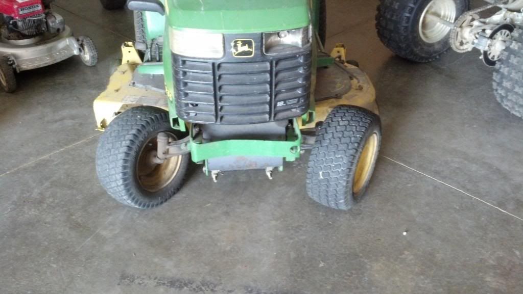

I bought a GT235 with 10 wagon this past weekend to replace the husqvarna box store mower i had bought with our new house. Well that thing was junk and i hated mowing with it.
The Deere is in good mechanical condition just not the best cosmetic, (broken headlight and scuffs, scrapes, scratches, and a nearly bald front tire)
It runs great and mows much faster than the husqvarna.
The question i have is about the steering. It turns really tight one direction but not the other. is this normal or is there an adjustment problem in the steering?

Let me clear up my original post. My front tires are nice and straight with each other so no toe mis-adjustment. I can turn the wheels harder left than right (steering wheel can make more turns to the left than it can to right).
I'm not sure why this is though i haven't really torn into it.

Ok, you got us, so you do know which end of the adjustable wrench to use...:thumbsup: good idea
does it feel like something is binding up and getting progressively harder, or just like it's reached an end stop?
and so should we not connect the dots from steering angle to one worn tire???
Have you been able to get it up on a lift and get under there to trace back to the steering tube?
Wonder if it might be something simple like a clump of mud or grass preventing the rack from going far enough in one direction.

It feels like a hard stop in the steering wheel.. it doesn't get progressively. harder just an abrupt stop. ill take a video tonight and upload it to youtube. that oughta help you guys. ill get it up on a stand and see what it does also.

Here are the pictures I took last night. you can see how much tighter it turns left than right. I put it up on the jack and it turns hard right also. I took a closer look and i think its a combination of worn bearings in wheels and spindles; and worn ball joints all over. I'll probably get some of these parts ordered next week and then see if greasing bearings helps at all before buying new ones.

The 425,445,455 all turned tighter to the left due to engineering of the steering cylinder system so I would guess this is likely normal.

as familiar asi can be with my friends 345 its the fact that the cylinder is on the left side and pushes on the kingpin. and since cylinders have more power pushing than pulling it is plausible that it get to max extended but maybe not max retract.
   / New here and to JD's #13
You normally trim around a tree on the left side so the turning radius needs to be tighter to the left.
