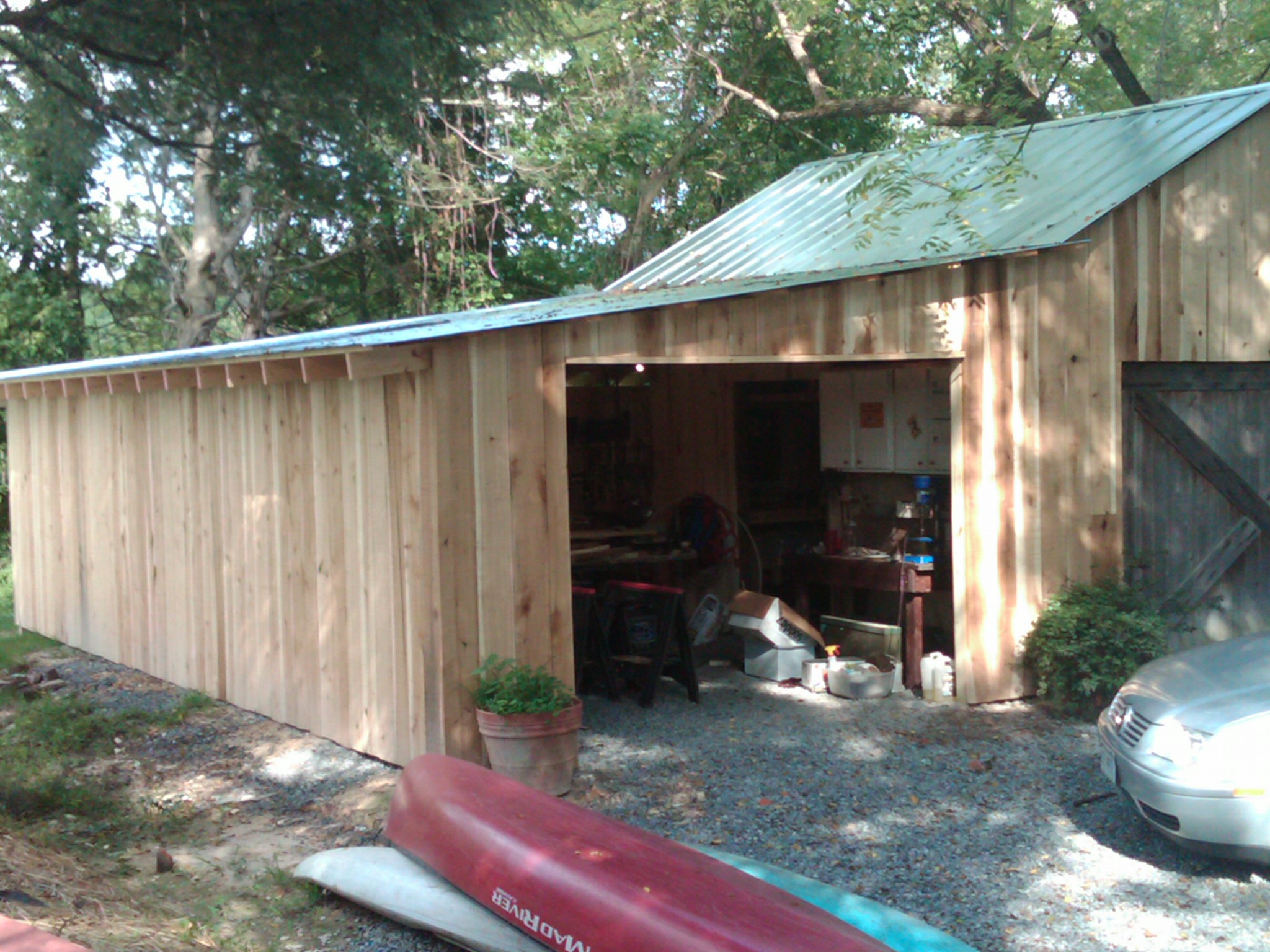

4x4's on 7 ' centers, diagonally braced in the corners. 2x8 at top of span between the 4x4s. 2x4 near the ground and halfway up each 4x4. 2x6x16 rafters. 2x4 @ 24" spacing for roof.
Holes were @ 36" deep. 4 inches gravel in bottom, fill dirt, compacted. 80lbs bag of quikrete at the top of each hole.
Had about 2.5 feet of snow on that low pitch roof this winter. No problems. Used joist hangers on the top side of the rafters. This particular shed addition required one 2x16x24 for the hip rafter, which got some pretty serious gusseted on each end.
Shelving was very economical use of material. It's just 4x8 sheets ripped in 2' sections that comprise the shelves and vertical end pieces. I erected it all myself. Extremely strong shelving design and connected directly to the 4x4s.
Gravel floor. So far, works great! Let me know if you have questions.
