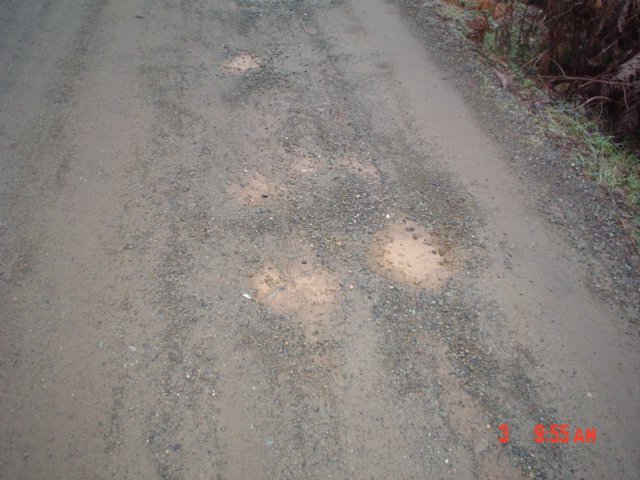

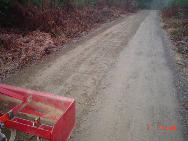

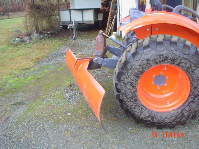

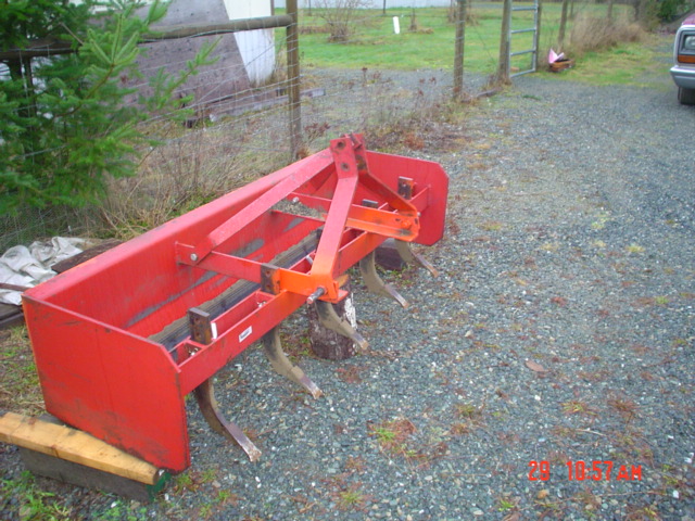

I can tell you what I use for maintaining my driveway. I have a CK35 and use a 6 ft box blade. Bought it for a reasonable price but really should have a 5 ft. It seems the rule of thumb is that a box blade or back blade should be just wide enough to cover your tractor tire tracks. I have a 7 ft back blade, again bought reasonably, but should be a 6 ft. I have only used the back blade a few times. The box blade does a great job for me on the road. If you get too big a box blade and it fills up with gravel your tractor may bog down as it just can稚 pull it. How wide does your tractor sit, outside tire to outside tire? That should be your guide for side of implement. Hope this helps some. :)
