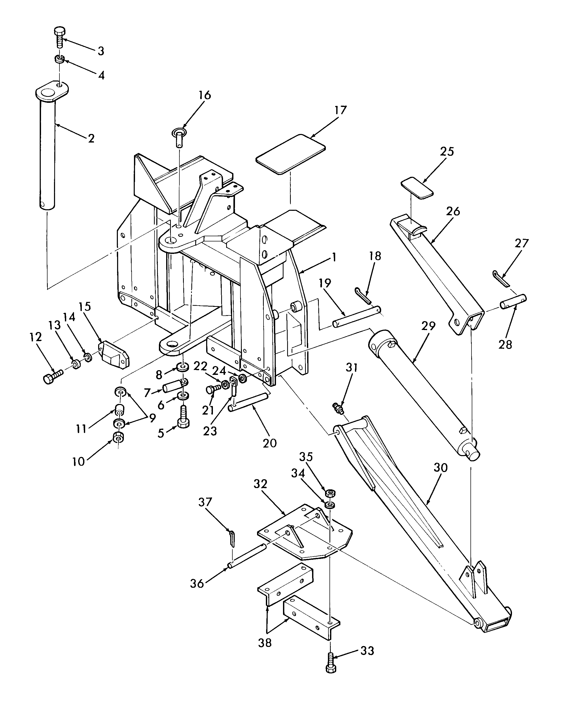

Hi guys. New to the forum here.. I have a 1997 New Holland 1920 that I'd like to get a backhoe for.. a friend has a Woods bh90x that I could use but I'm guessing it would need a subframe that may be hard to find.. that was on a Kubota .any advice? .. Or the alternative is I've seen a New Holland 759c backhoe for sale a couple hours away with a subframe that was on a 2120.. anyone know if a subframe for a 2120 would match up to a 1920? Not seeing much info out there. Thanks in advance, JE

I think you would be best off contacting Woods to see if they have a subframe for the bh90x that would fit your tractor. Same goes with the 759c. I would again contact the dealer and see what they can come up with. I did com across something at the Messick's site that might work. They are invaluable for referencing parts and diagrams.
I hope this helps!!
Here is their site and the backhoe mentioned is a 758b which apparently fits both 1920 and 2120.
Thanks Loggin.. much appreciated!
