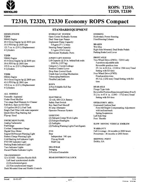

I am looking at the 2310 the question is I haven't seen one in a shuttle shift. The hydro comes with telescopic links, tilt and telescoping wheel and swivel seat. I looked at Case and the shuttle shift does not include these options you can get the adjustable links but not the seat or the tilt wheel or floor mat. Is this true for the New Holland also. New Holland dealer says they are included on the New Holland shuttle, Case dealer says the Case and New Holland come down the same line and they are not included on either one. I am also looking at Agco tractors I can get a 40 hp with a mid mount pto. It is not offered on the 40 hp New Holland. Would it be a mistake to overlook this option. As with anything I like some of the features on each model. Tough decision right now.

Here is the NH description of the T2000 series ROPS economy tractors. If you look at the Operator's Area, you will see there is no padded mat and only one step on the left side. The Steering section also clearly says a fixed steering column. I think your NH dealer is incorrect and your Case dealer is right.
