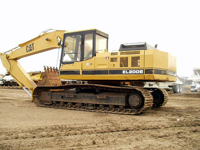

   / New Holland 555E #2
   / New Holland 555E #3
Hi My brother and i own and operate Ford backhoes daily, they re real good machines and parts arent that expensive I cant recall the age of the E series i run one partime with 4 wheeldrive and a 4in1 bucket for a friend and its a hoss fo septic work. Id go with the excavators in most clearing cases but around the house the front end loader and the small size is a must. The excavator is rough on an undercarriage it yi have to tote a load acros the property and such. You can put a thumb on the hoe and do some pretty good clearing just be weary of your limits and take in the fact its not a 988 Cat. Ive cleared alot of right of ways for utilies when i hepled my brother with his 455. One word of cautions is to check the torque tube on the front of the 555 loader the underside will have cracks if its been mis used or confused for a 988. Over all there pretty good machines i use my old Ford 3550 every day around the house.
