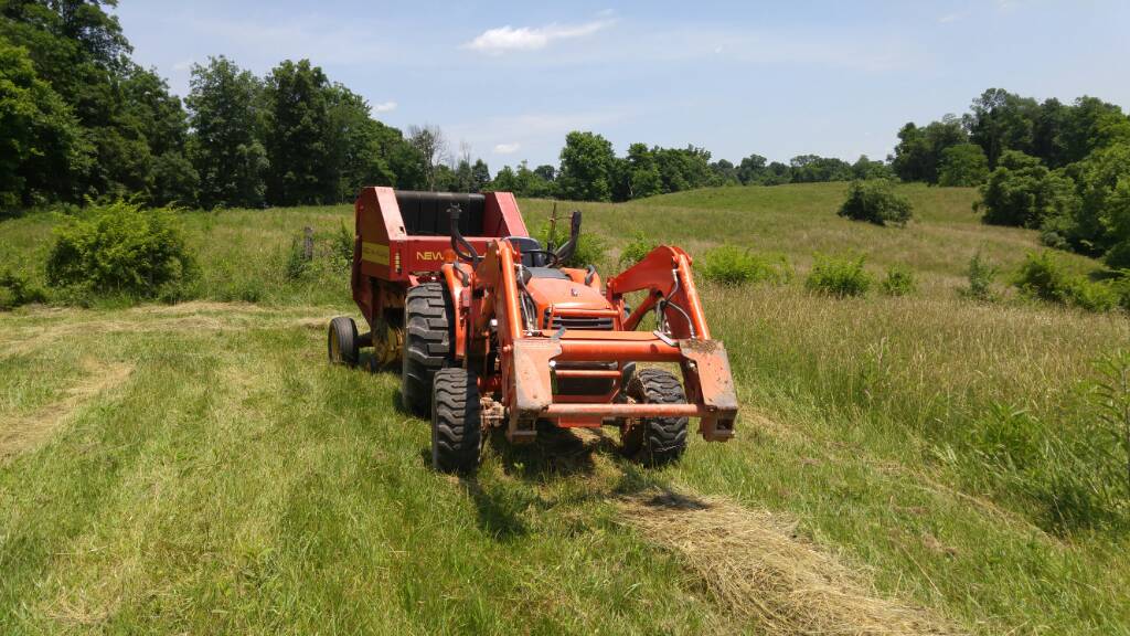

I bought a 630 last yr for my dad. No problem on hills with 50 hp tractor. 0616181331a.jpeg

Picked it up yesterday. It is a little rough around the edges, but I think she'll be fine. Very simple machine.
