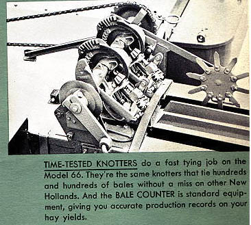

I was given a New Holland model 66 baler that sat outside for many years. I put a new tire on it (the other was fine), greased the hubs, and pulled it back to my family's farm. When I got it back I started working on it. I greased everything, there was acuually still grease in all the moving parts. The plunger was stuck so I put a wood handle in the flywheel and started working it back and fourth until I got it all moving. I got the whole operation freed up and then started looking at the knotters. They weren't doing anything even with the measuring wheel tripped so I looked everyting over. The sheer pin in the drive sprocket for the knotter was broken so i replaced it and turned the knotters with a pipe wrnech. It turns out that the sheer pins in the small gears that drive the twine disks were sheered also so i pulled the twine disks apart and cleaned them up and replaced the pins. Now everything is working. I ordered a operators manual and a parts book for the baler so I will have some more info. As of now I can turn the baler over by hand and trip the bale measuring wheel and the knotters will do all that they are supposed to. Is there anyting that I shopuld know about the baler? I have heard both good and bad about this model. I am wanting to start baling a little hay, selling to my aunt, and also sell some to others down the road. I know this is no large baler but will it be reliable? I don't mind taking it slow, hell, all I have as of now is a JD model 39 sickle bar mower and a old lime green no-name parallel bar rake. -Phillip

I've always been fascinated with balers but will likely never have a need for one. Any chance you can post some pictures of some of the mechanisms inside. The knotters are particulary interesting sounding /forums/images/graemlins/smile.gif

Attached is a picture of the knotters from NH 66 sales brochure.

Here are a few tips, if its been sitting outside a long time I would replace the twine cutter knives.
Also take some emery cloth and polish the bill hooks on the knotters to keep the twine from catching on them. Some PB Blaster might help too.
You might also want to polish the path where twine goes thru the needles as well.
Also some PB on the chains wouldn't hurt anythign as well.
