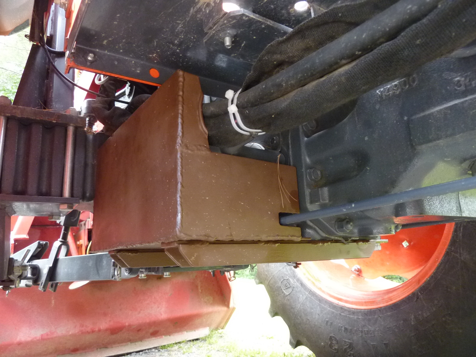

I made a box type shield for the filters on my M5640 Kubota. Used some threaded holes on the bottom of the transmission as mounting points.
Do a search - I have seen quite a few threads here of people doing similar things. RustyIron is one guy that put a complete guard under his tractor. Plenty of ideas in that thread.
