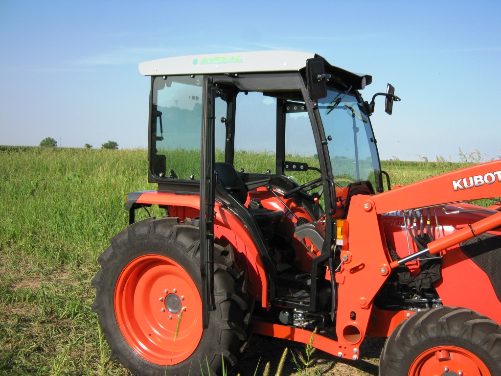

Don't have experience w/ Boomer Class tractor but the MX is a formidable machine. Mine is sturdy w/ ample power. If choosing a Hydro Trans, it is the basic version, No tilt wheel.
But does have adjustable pin style stabilizers and extendable lower links. Hydraulic Remotes and rear work light, additional. Seat is poor quality, replaced mine w/ higher back, side bolsters, 6 way adjustment, suspension, better cushion.
Depending upon your location, if a cab is desired, there is a very nice all glass aftermarket product available. I use a 9 ft-2 inch finish mower behind mine, mowing semi-tall pasture grass w/ no issue.
I do NOT have the DPF but still would likely not hesitate to purchase another MX.
Good Luck.
