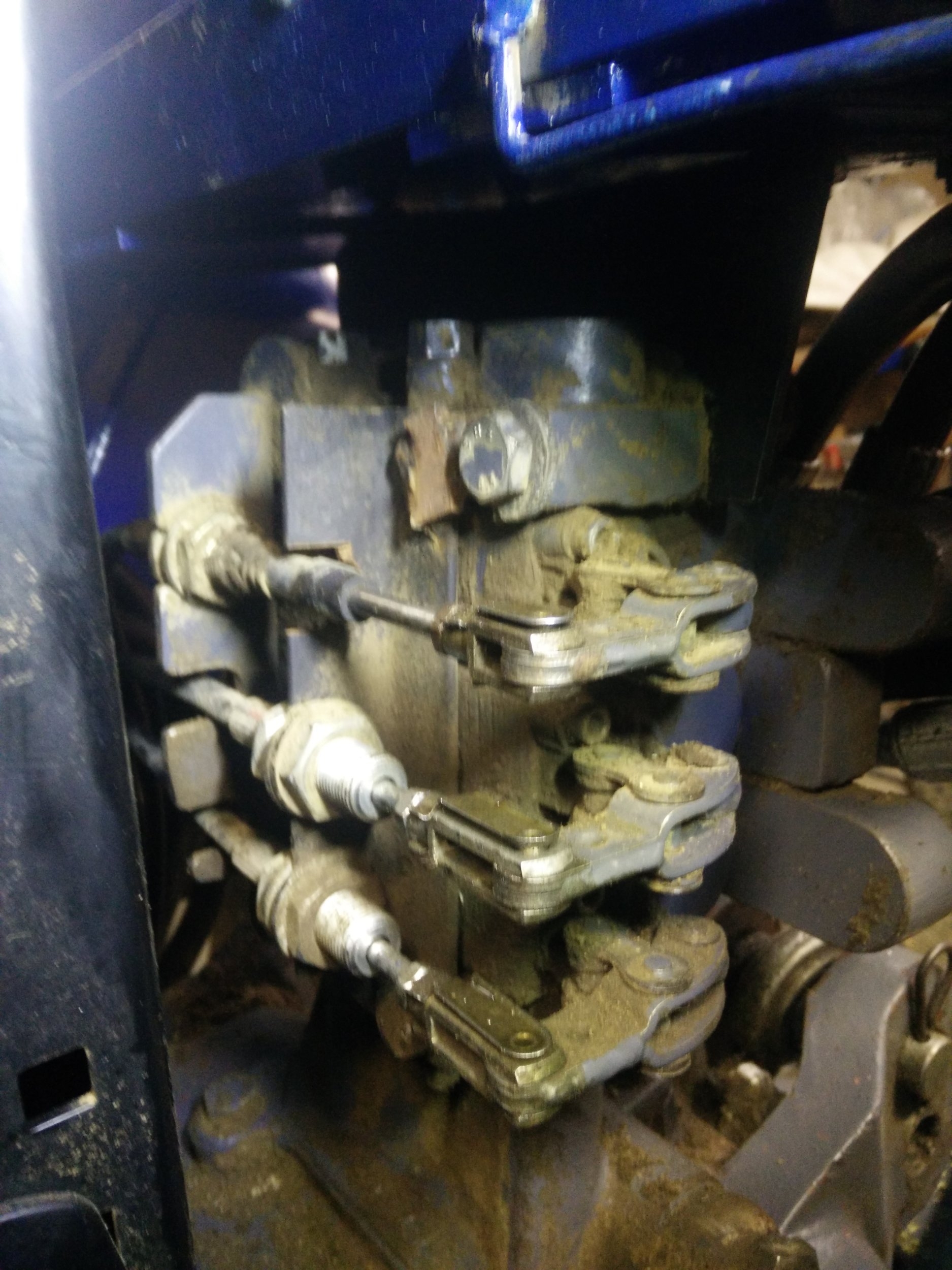

This is not rocket science. Forget Load Monitor; It is not available on a TN tractor. A 2000 model year TN won't have a mid mount valve, only rear remotes. The rear remote valve coupler pairs are oriented horizontally as are the valve spool slices that supply them. Kneeling facing backwards in the seat, observe the valve ends of the operating cables and the levers thay attach to. These parts are located on the front side of the valves, opposite the couplers which are on the back. Move the long lever mounted to the fender forward and back and determine which valve spool is moved by which cable. Do the same for the fore and aft movement of the joystick, then the side to side movement of the joystick. Attach the hoses from your attachment to the coupler pair you prefer.

TN75 - Does anyone know how to eliminate joystick excess play when connected to the rear remotes?
   / New Holland Hydraulics #9
Joystick play, if the joints at the valve and the joystick connections are not worn, points to the joystick itself. Remove the boot and look at the ball joints of the joystick.
Most likely need to replace the joystick as an assembly as repair parts for the joystick are not available.
