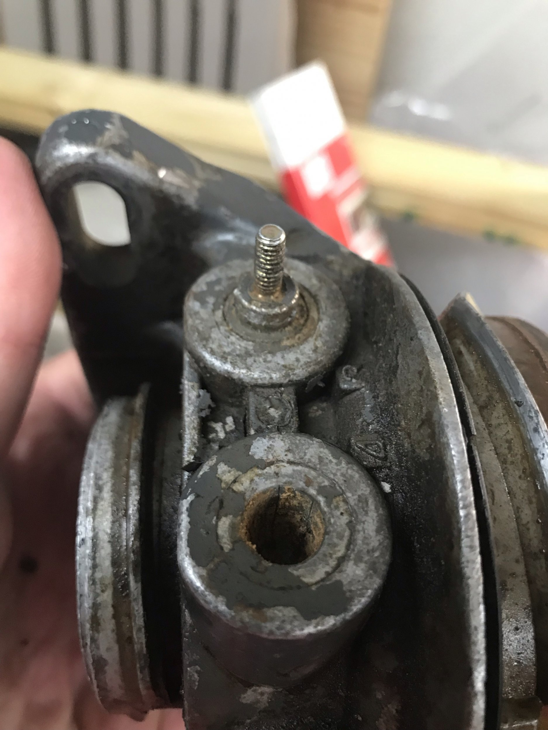

Can anyone tell me the correct name or part numbers for the threaded stud and the plug below it on my fuel filter head. Or tell me how to remove them. I’m stuck
   / New Holland LS180 looses fuel under load #7
They look like they are pressed in. What would a new filter housing cost? Sometimes it is just better to start fresh with a new part and be done with it.
Yeah I got a new one ready but was unaware of those parts. I was thinking the same thing about being pressed in. I know the stud is for a ground or power for the fuel pump. I’m guessing the other is just a plug.
