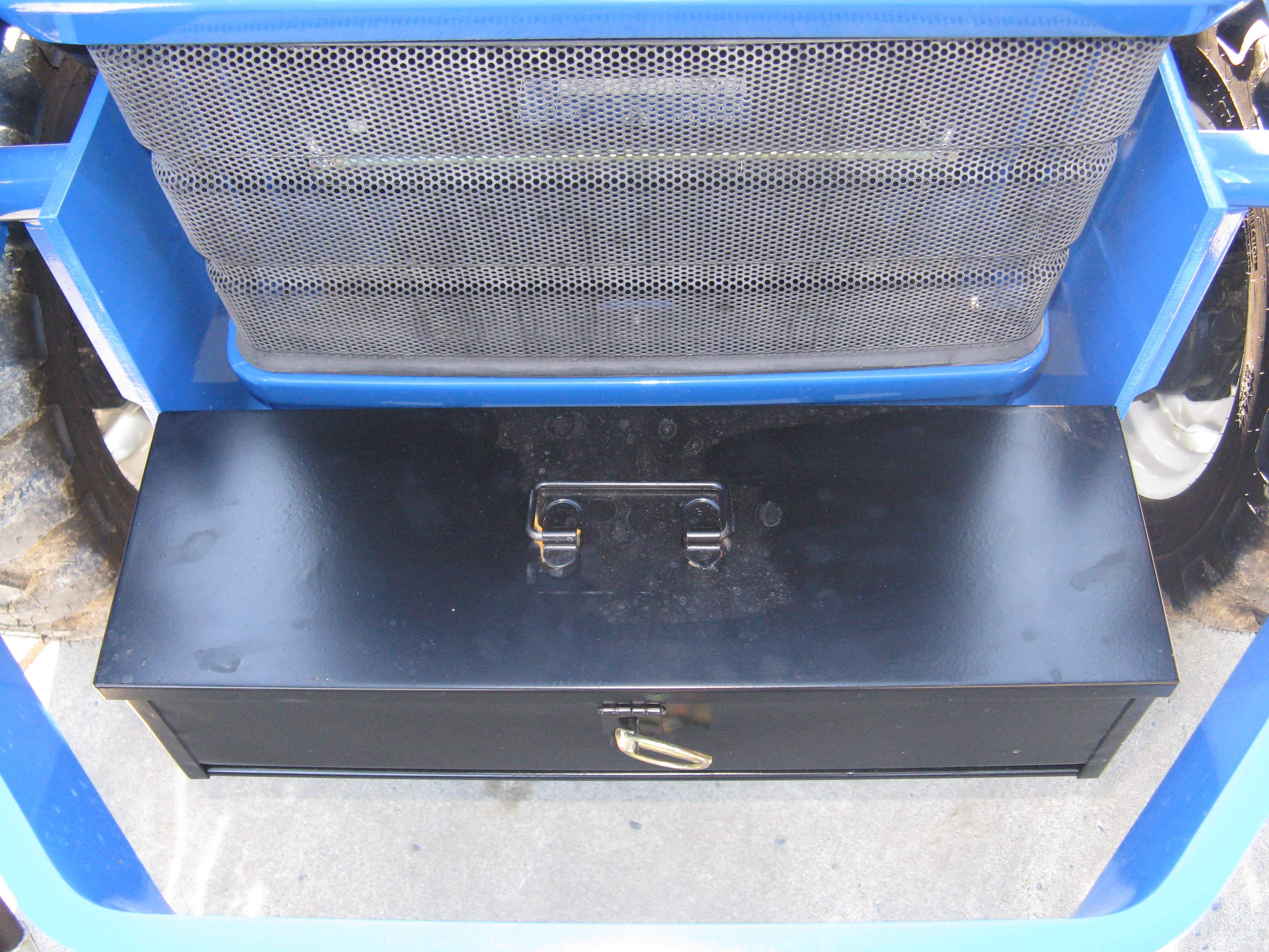

I bought this box and the bolts for under 20 dollars. Works great. Drilled and tapped the "front support" the box sits against, and it rests on the piece you see. The loader never gets close to it, and it's a LOT cheaper than the factory box. I keep a few wrenches, a chain, and a few draw bar pins in it. Just an idea.....

I do like all the toolbox options for storing larger tools or just more tools (haha) never considered the front box, guess because my tc hood had to have plenty of room to swing up..I got a few extra older metal tool boxes and one of them may just find a new home up front...whats the worst it adds extra weight.
