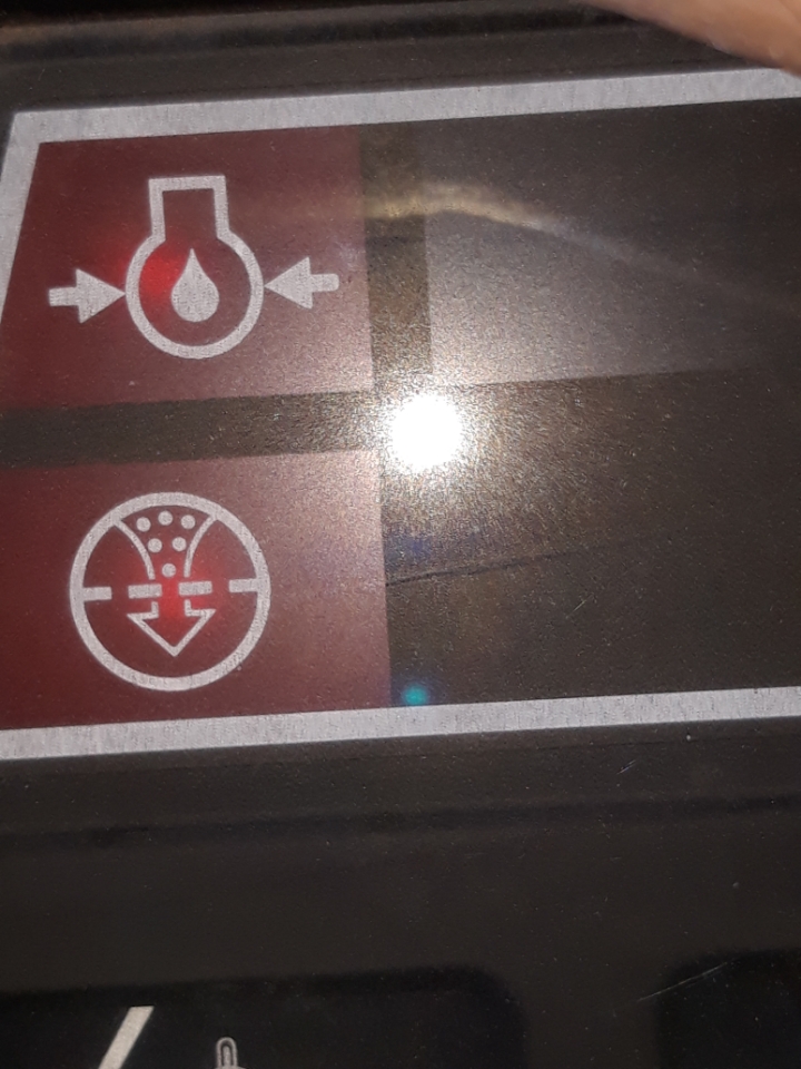

Tractor was running fine then next day would not start.Instead of glow plug light coming on when i go to start it,the light to the left comes on.I have put new air cleaners in,changed oil and hydraulic fluid,checked wires for being broke or seperated and don't know which way to go.Any ideas?

Does anyone know what the symbol on bottom left means? Resized_20200502_174245.jpeg
   / New Holland TC 30 won't start #3
My guess is a fuel supply warning light.
   / New Holland TC 30 won't start #6
Water in fuel sensor light. Running the same or rougher than before or maybe a hiccup in running.

Air cleaner reset was the problem.Took battery cable off for 5 minutes after taking sensor off and blowing into.She started like a new one.Thanks to all of you for your helpful info.Could not have done it without you guys :drink:
