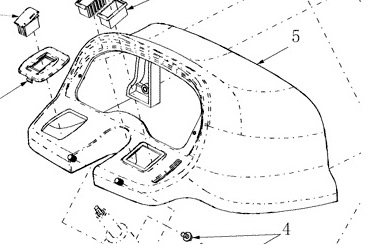

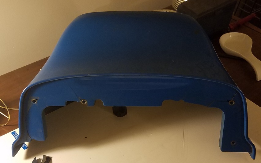

I'm looking for the instrument panel hood for my New Holland TC33d. The original part number is 86401982. This panel is the same for New Holland TC25, TC29 and TC33 from year 1998 through 2002. If anyone can suggest where I can locate one, I would appreciate it. The retainer bolts in the panel have a tendency to break and crack when they are removed.

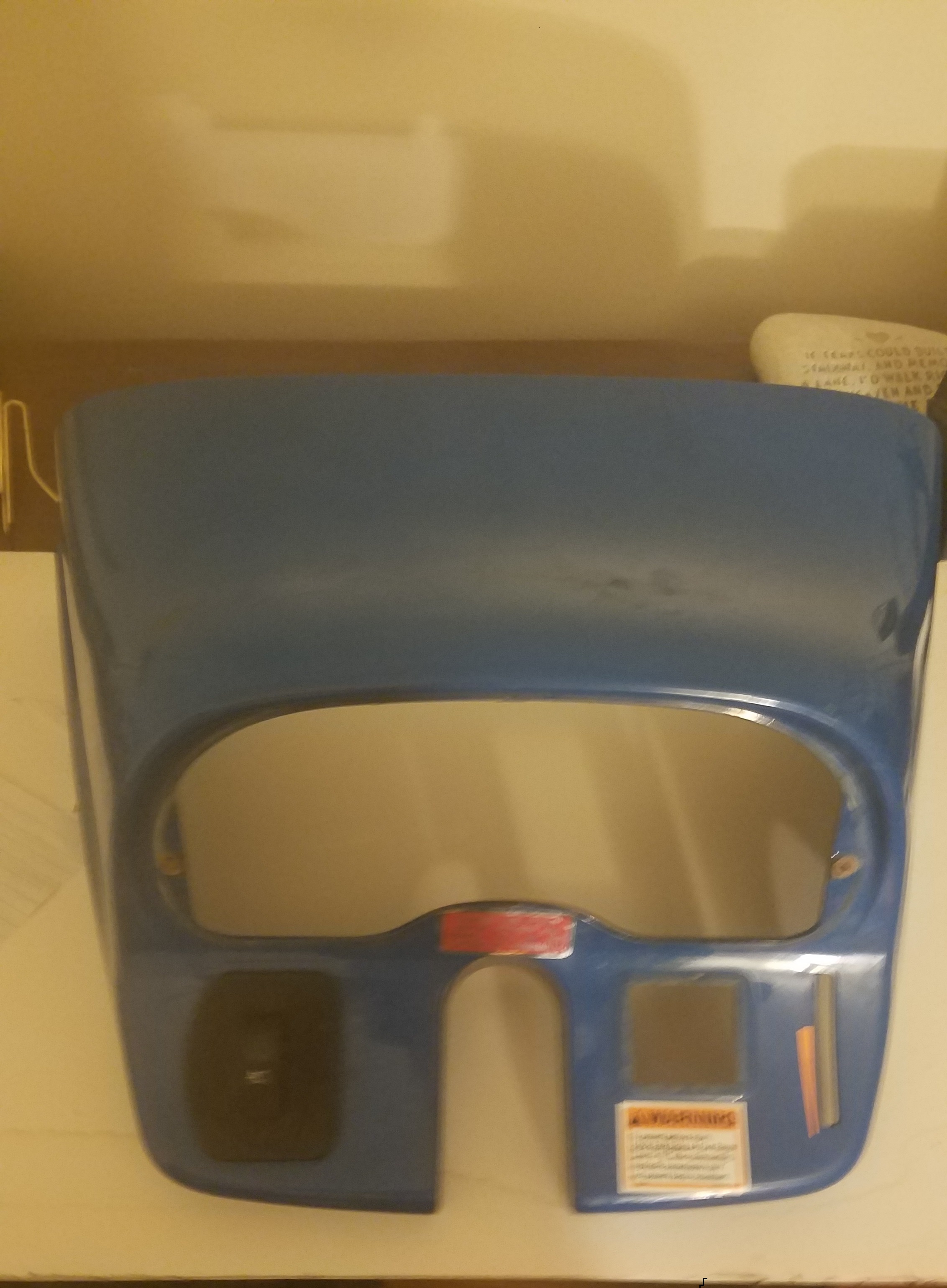

I did call All States Ag parts and Weaver Compact Tractor, the ones they had are all broken up. I will try Nampa. I really appreciate all your suggestions. The problem occurs when they try to remove it, and the plastic breaks where the retainers hold.

Yeah, I had a similar issue on our TC40D with the side panels... I wound up using JB Weld & forming up the repair area with it & inserting the brass tread inserts into the it.... Still holding for now...
   / New Holland TC33d ( Instrument Panel Hood) #5
Try long lane tractor in pa it's a NH grave yard . Stones throw away from Messics. Otherwise try a nutsert or glass it in and retap the hole.:drink:

Thank you Spitter, I did call Long's. The ones they had were broken. I never heard of a nutsert before. Who says you can't teach a old dog a new trick!! Thank you again.
