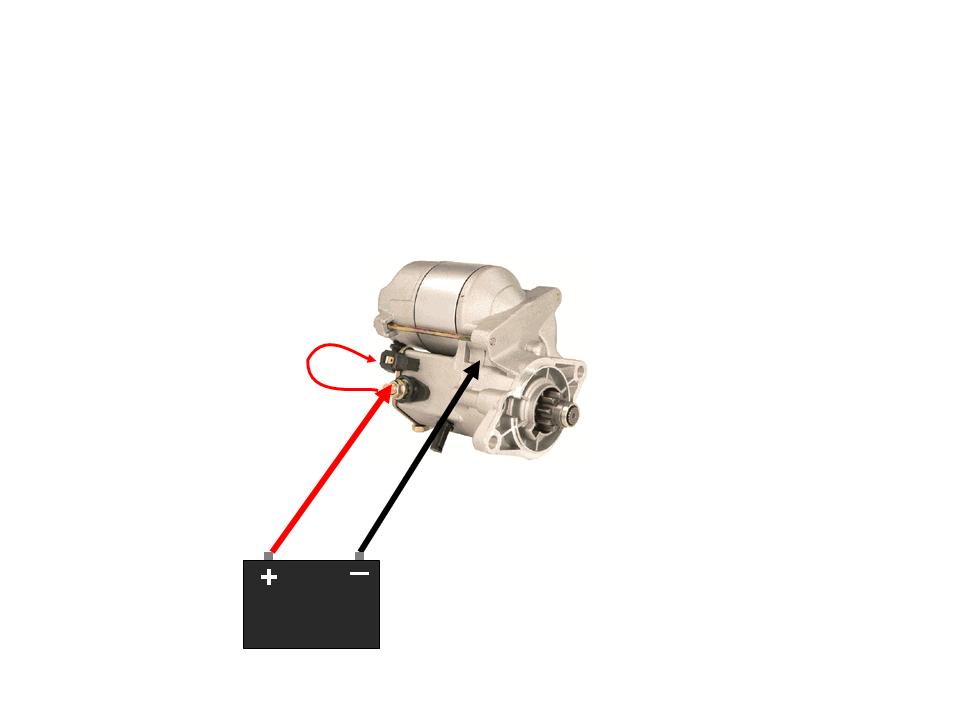

Look at the diagram below. To give your starter and wiring from the battery a real test, jumper between the big terminal and the small terminal with a 12 gage or larger wire. You'll have a little spark and the starter solenoid should engage and the starter spin the engine. If not, you may have an internally corroded battery lead that you can't see because of the insulation. Normally it corrodes under the insulation very near to the battery. To test this, jumper a battery to the terminals as shown using jumper cables, and try again. If neither of these tests work, you probably have a bad starter.
EDIT: You don't need the ignition turned ON for either of these tests. It's better not to turn it on because the engine might start if you have the ignition ON. With the ignition OFF, just the starter works.

Hey , I really appreciate your helping me out. I have done all of this with ignition on and off. the only difference from your diagram is the negative cable was on a bold head from frame and not on the body of the starter? would that make a difference? I want the machine to start so I can get er on the trailer and have it fixed. So it is possible that I had the starter checked and they say it's good, and that it can still be bad. That would really get me aggravated, so much time trying to check other things. uhggggg!

If you put a battery directly on the starter and it won't turn over, then yes, the starter is bad. You just have to make sure the jumper clips are very clean and making perfect contact. If you could conveniently attach the jumper to the body of the starter, this would be good. Otherwise, ground to one of the subframe's big bolts or similar that you are certain will be a very good ground. If that does not work, I guess you need to pull the starter and check it out of the tractor. Is it possible you have it in crooked and in a bind? BTW: If you have to buy a starter, you can buy them much cheaper than from New Holland. I've seen rebuilts as low as $100 online and new around $160. NH wants over $400 for theirs.
