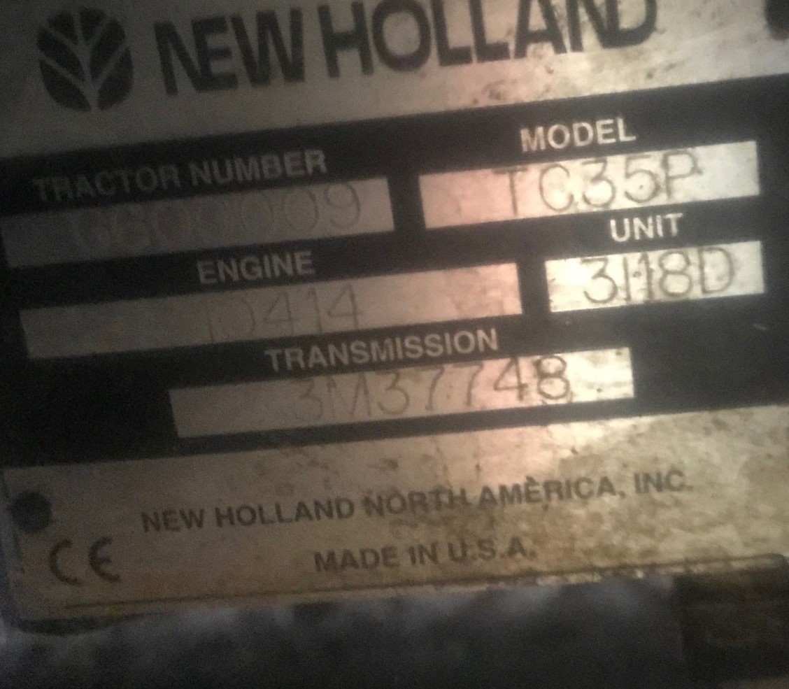

Hello all,
I have a 2003 NH TC35P or that is what the tag shows NH stated that they never made a TC35P that it is a TC35P, okay so on to the question have had no problems with this unit till now, the PTO will not engage the light comes on but no rotation does this unit have a some sort of electrical safety or fuse?

If your tractor has an independent PTO (see your operator's manual), there is a hydraulically actuated clutch that engages the pto shaft to supply power. Either the pressure line is leaking, the valves is not working or the pto clutch is worn.
   / New Holland TC35 PTO
Jerry,
thanks I will check that out. The unit I have has a single lever to the left of the operator that rotates a shaft in small Hydraulic valve.
What I find odd is was the bush hog was on and working put hay fork on the switched back to the bush hog and the PTO was dead just all at once.
all the other hydraulics on the tractor work fine.
thanks.
