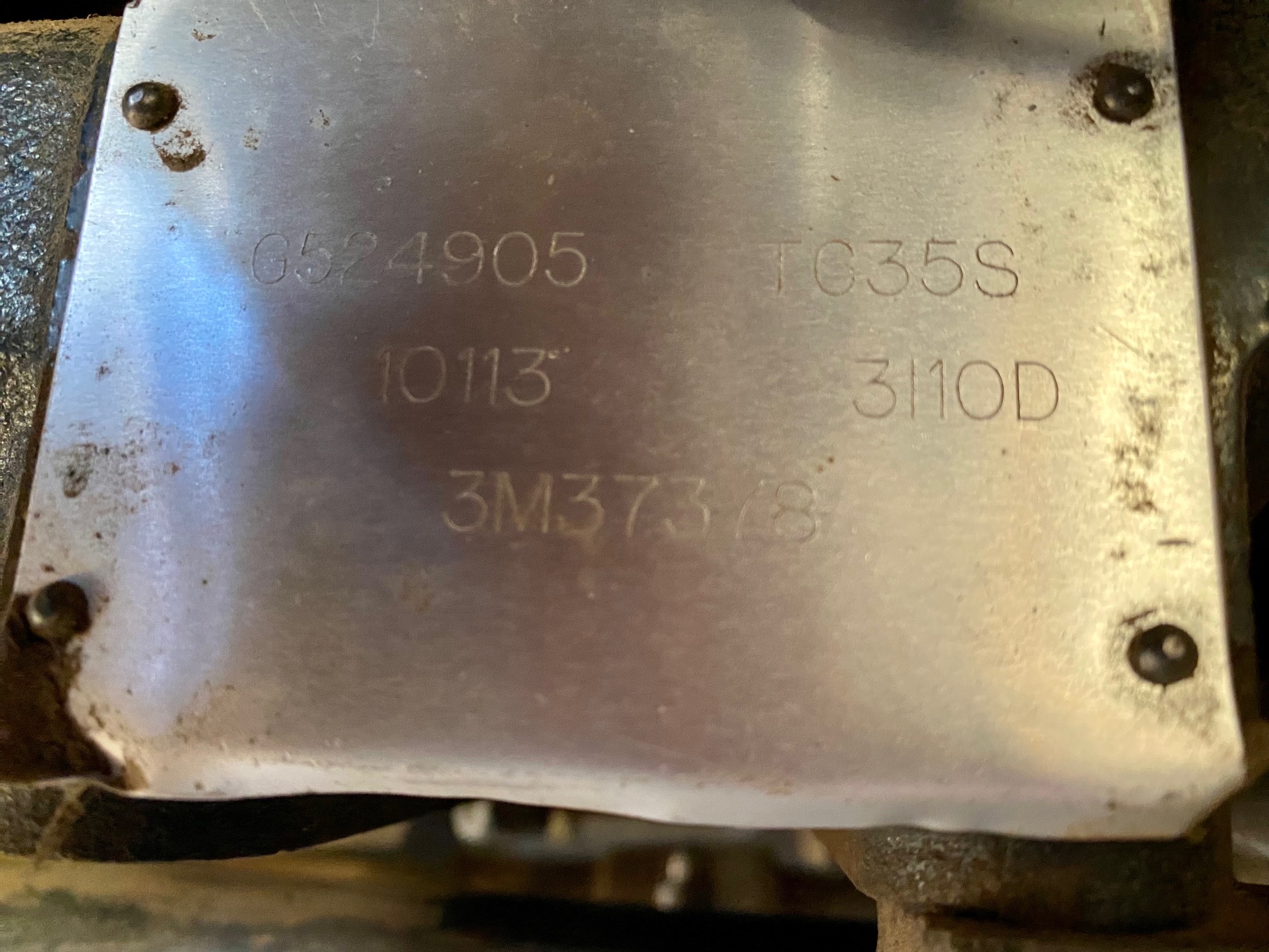

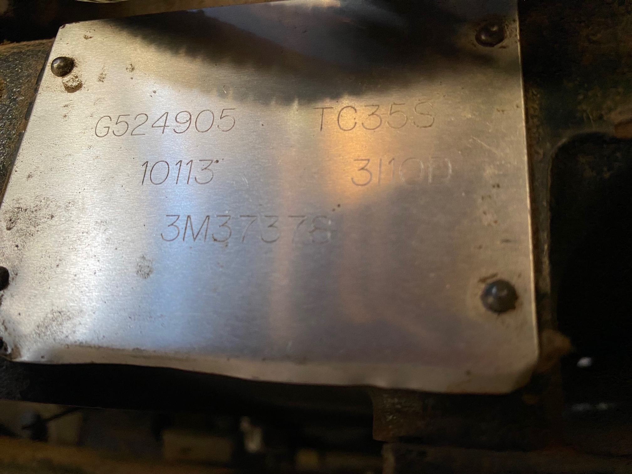

Just to make sure, it is just a TC35, not a TC35D or DA? It does not have Supersteer, just a regular front drive axle? Reason I ask, the Supersteer is a much harder axle to steer and has two cylinders, the regular 4WD axle has only one.

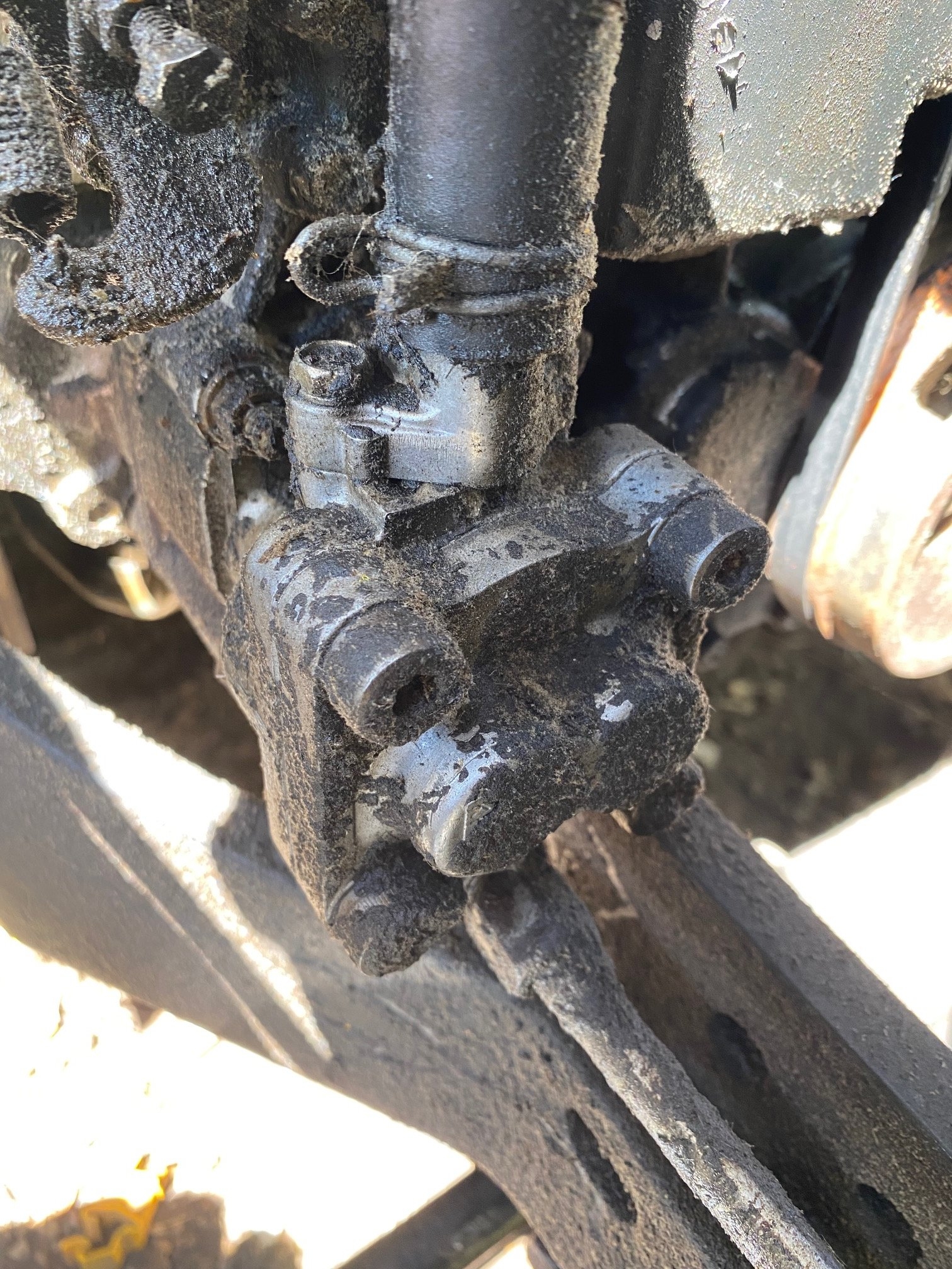

TC35S see the attached plate - the oil on pump is what is leaking from power steering, which im trying to find first between thunderstorms. I did not see a cylinder on the drivers side when lifting the tires.

Okay, you have a TC35. The plaque pictured is not the model plaque. That is located under the LH step, but no difference.

As far as the leak goes, I can't tell from the pictures, but is it leaking a lot when it is running?

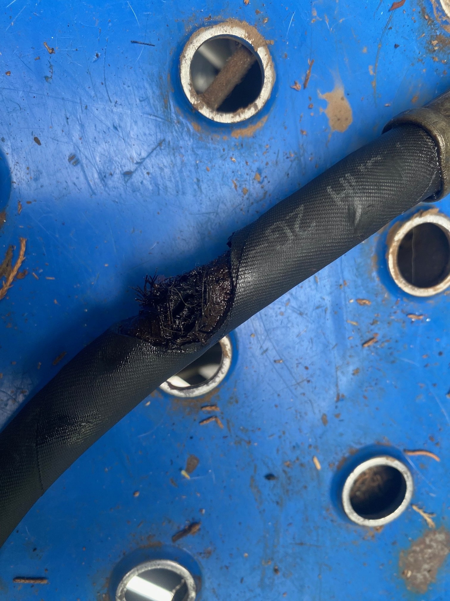

Thanks for all the help, between thunderstorms yesterday I had a buddy out who helped me trace for a leak and found a big one. It was hidden in loop on top of the front axle, impossible to see but once we saw where it was running out, I felt around till I found the hole. $70 later everything works perfectly.

Okay, that would do it. Glad you are back in business.
