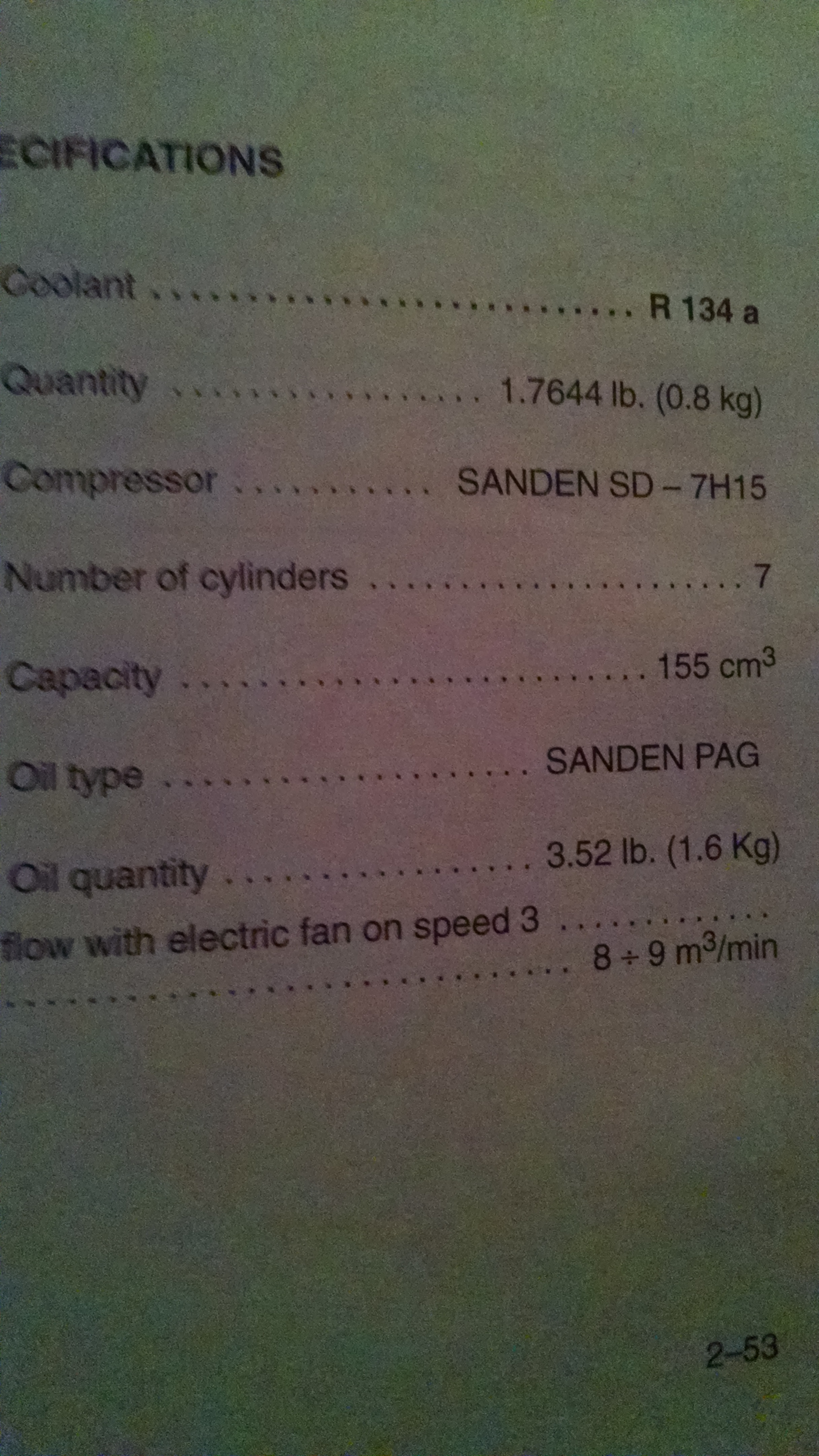

Anybody know how much oil goes in the refrigerant system on a new holland tl100
   / New holland tl 100 ac refrigerant oil spec #2
3.52 lb according to my manual on a TL100 A
   / New holland tl 100 ac refrigerant oil spec #4
I can't get the pic to post from phone tonight.
Coolant r34 quantity 1.7644#
Oil type sanden pag
Oil quantity 3.52#
So I answered him with what the Manual States . I will post the pic tomorrow from my PC
   / New holland tl 100 ac refrigerant oil spec #5
It would be informational if we knew why Byrd needs this info. 3.5# is a half gal (aprox). That is a lot oil for a system for which the oil charge is usually measured in fluid OZs. Manuals do have mistakes in them once in awhile especially when translated to english by a foreign engineer. The R4 sounds reasonable for a critical charge type system. Refrigeration is not a good DIY endeavor; too many nuances and technical stuff like thermodynamics. Too much or too little of either refrigerant or oil can cause heat transfer problems or compressor failure.
Very little oil is lost through a leak. Compressor manufacturers provide info with with instructions to assure the proper oil charge is added during a change out. Those little compressors have no sight glass or test cock to check oil level. I always hated getting stuck with the bosses friends auto systems when I was a AC&R Tech as they were out of our industrial league.
Ron
   / New holland tl 100 ac refrigerant oil spec #6
Oil type sanden pag
Oil quantity 3.52#
That info is incorrect. Either on your part, or the part of the manual's publisher
   / New holland tl 100 ac refrigerant oil spec #7
The info may indeed be incorrect but I did not write the dam book
   / New holland tl 100 ac refrigerant oil spec #8
I would assume 1.7644 pounds R34 and 3.52 ounces of oil. Unless the system had a total blowout or massive damage somewhere, I wouldn't add more than 1 ounce additional oil when recharging the system.
