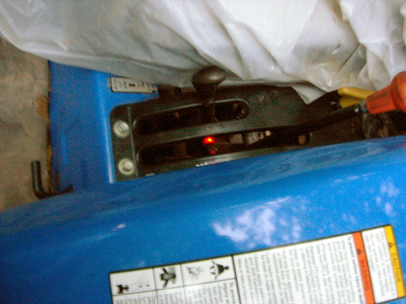

Just noticed today that under the seat of my NH Workmaster 40, there is a tiny red light that is on when the tractor is running. It's located under the seat, to the right of the range lever linkage.
Anyone know what this is??

Could be the proximity switch for the range lever, so it knows when it's in Neutral. Most proximity switches will have an indicator light in back of it.

Here's a photo. It's getting dark, so it's a lot more noticeable now.. The old camera focus ain't so good, but it's really small, like the size of little button LED. It's on whenever it's running, regardless of the range or neutral.
I wonder if it could be the brake.. I have to jump on it and see if I release the parking brake it goes out. I doubt it, but worth a shot. I don't think I ever looked without the brake being on.

Well, I emailed the dealer and it is for the mid pto. Don't know why it's always on, but he says it's for the mid pto, and nothing to worry about.. Next time I'm on the tractor, I'll turn the mid PTO on, and see if maybe it goes out..
