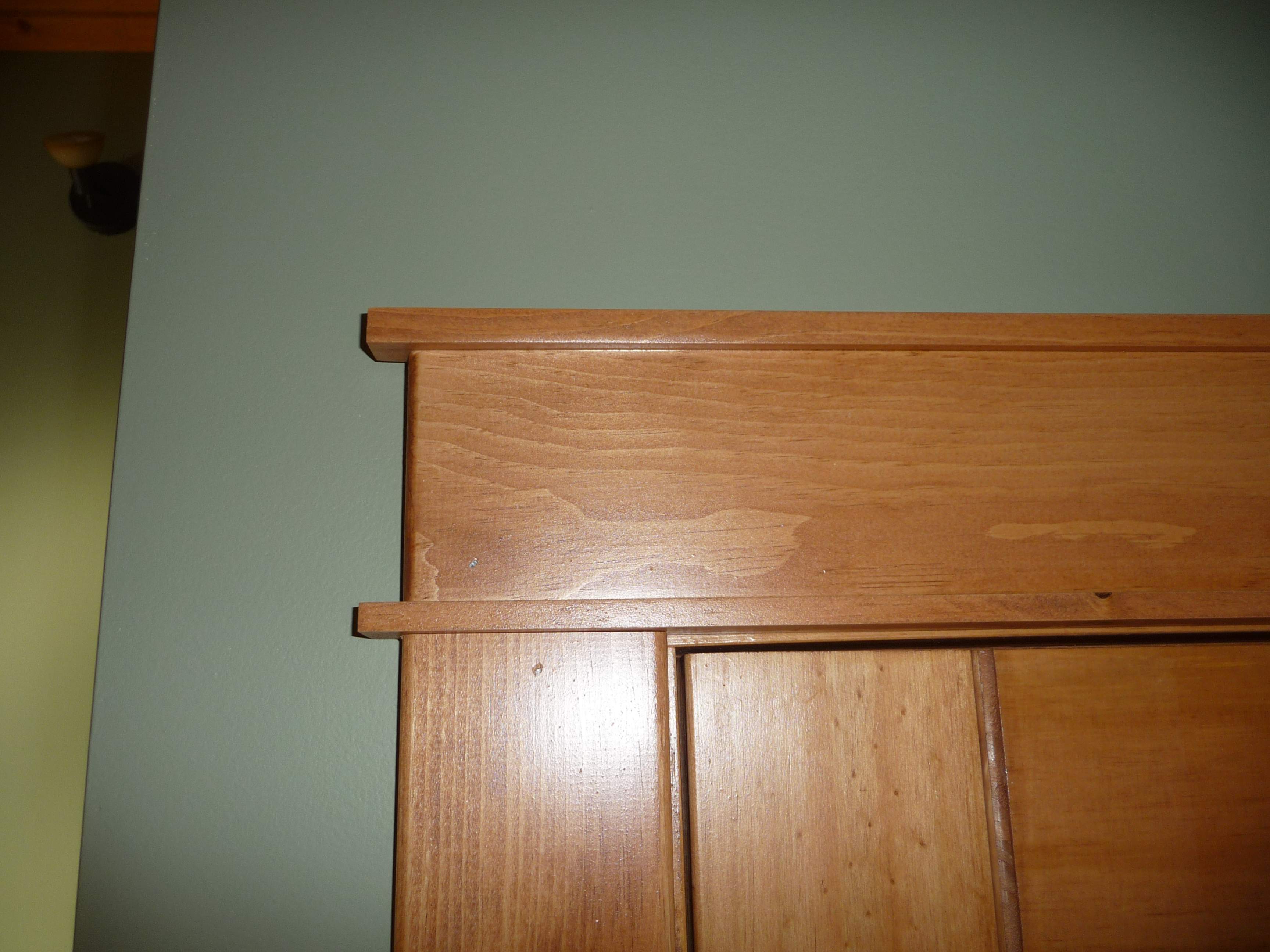

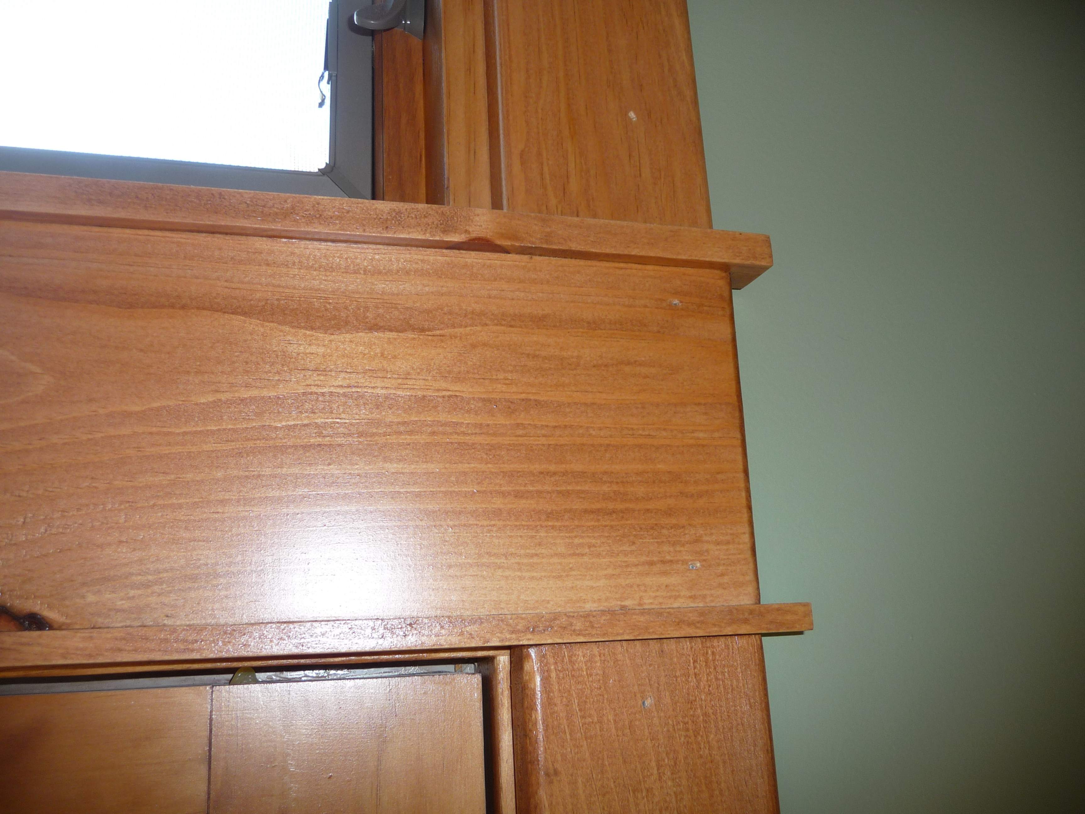

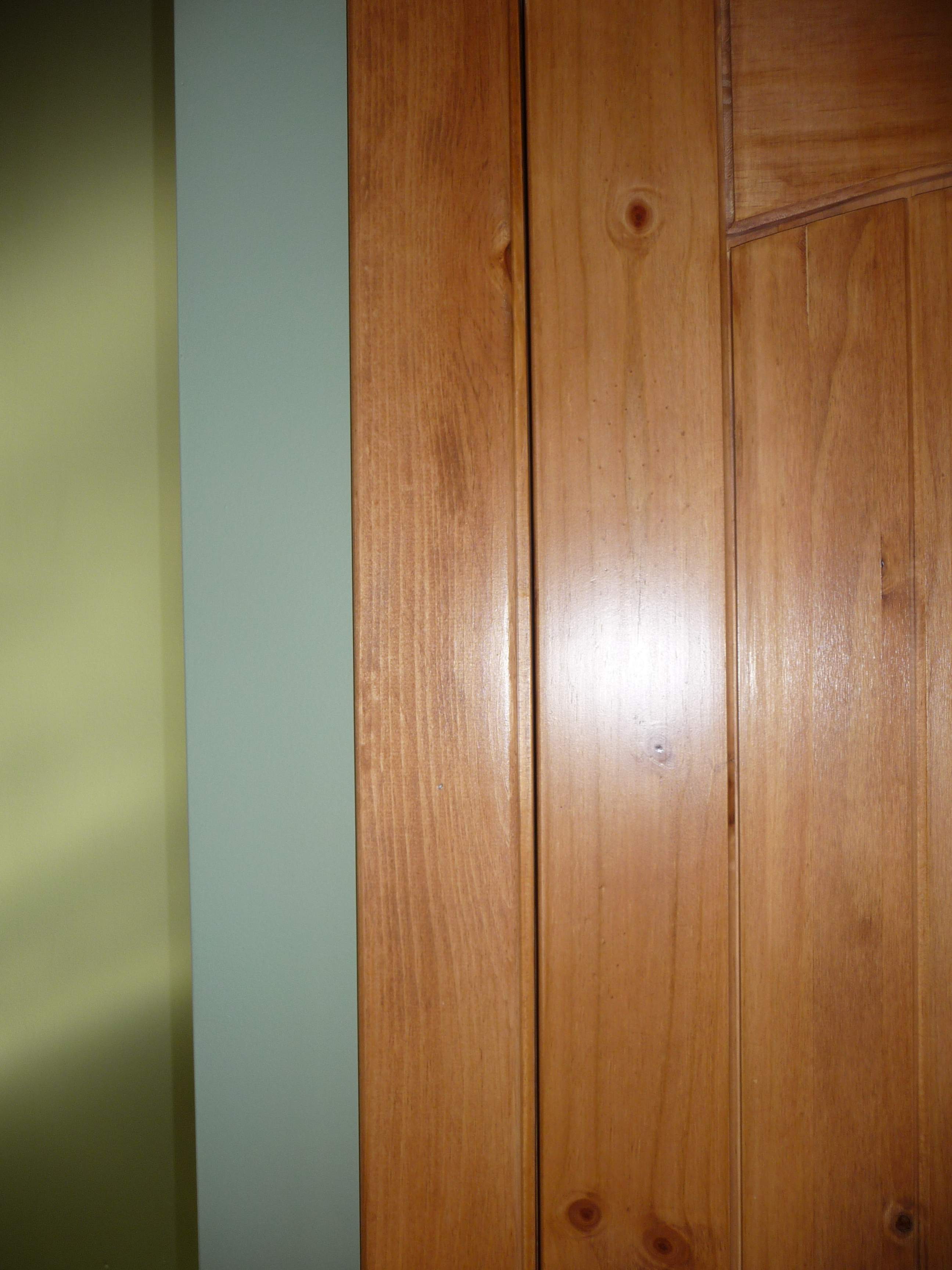

Your window casings and tops look pretty nice. Can you tell me how you made them? Do you have any more pictures of them? Thanks. Rick
   / New Home Begins
#636
Rick,
The window/door casing are 3 1/2" wide. The stiles (verticals) have a 1/4" radius round over on the long sides. The door casing are installed first. I then measured the width from outside edge to outside edge of the casings. This gives me the length of the head stock piece so that it matches the casing width. I rounded the short sides of the head stock.
I then cut 1" x 1/2" x head stock length+1" for the attach to the top and 1" x 3/8" x head stock length+1" to attach to the bottom of the head stock. These pieces extend beyond 1/2" on each side. The 1" gives us a 1/4" reveal (projection). The three pieces are glued and pinned together and finished. The unit can be simply placed on top of the casings as a unit and nailed.
I hope this answers your question but I will post close ups tomorrow.
Rick. Here are a few closeups of the moldings. I have not filled the nail holes yet.
