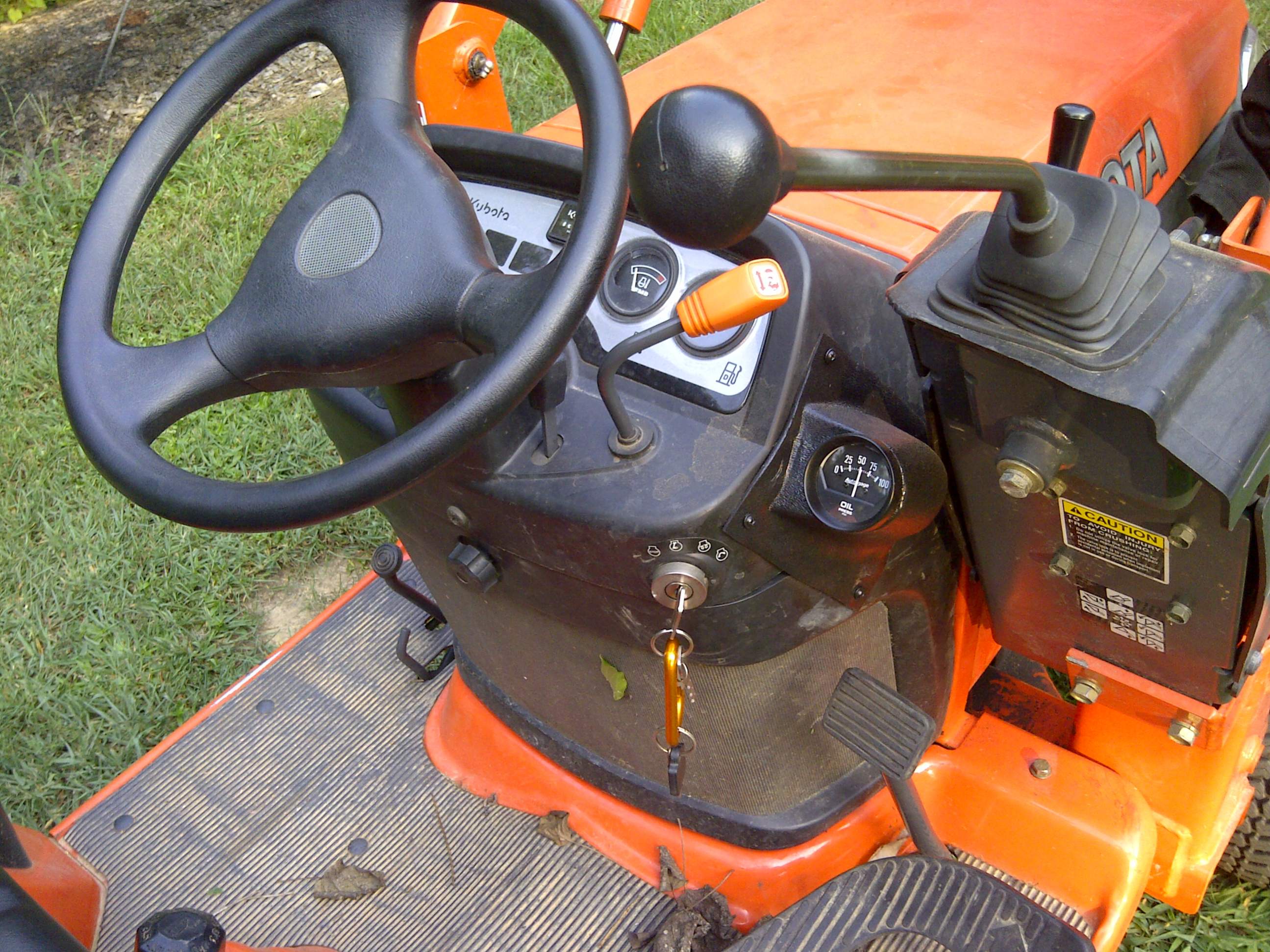

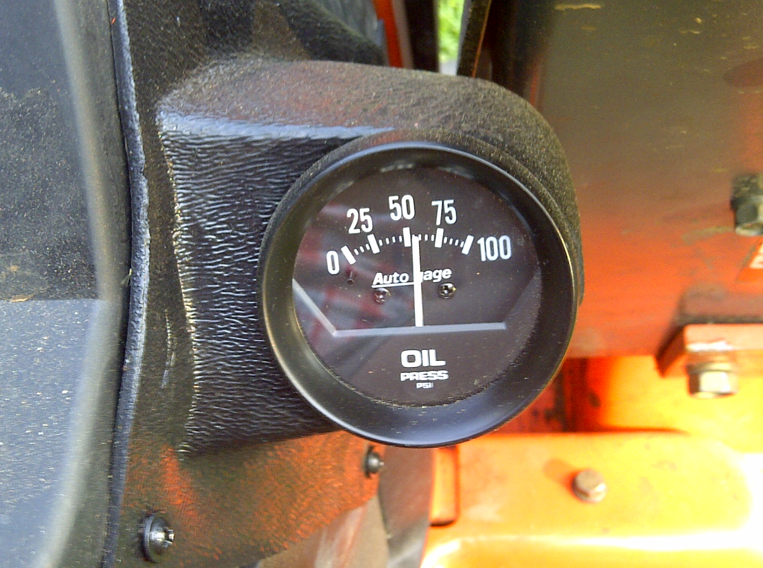

So saw the best sight today, my tractor running, showing proper charge pressure, and driving like its new with full power. Yes, after three attempts I installed an HST correct. My advice if anyone follows is take pictures and bag everything in labeled bags. The work shop manual is OK but lacks the detail you need to ensure everything is 100% clear.
I also have my gauge installed, and it monitors charge pressure. Off the top of my head the range per the WSM is 42-70 psi. If I see the gauge drop the HST isn't getting hydraulic oil. I'm 99% certain this gauge would have saved me $1500 in parts and a lot of downtime.
For those who are interested here's the parts you need:
Oil Gauge Kit - can get from autozone or amazon (mine) Amazon.com: Auto Meter 2360 Auto Gage 2-1/16" 0-100 PSI Mechanical Individual Panel Oil Pressure Gauge: Automotive
1/8" to M14 adapter (goes into test port next to HST filter) - amazon Amazon.com: Auto Meter 2267 1/8" NPT to M14 x 1.5 Oil Pressure Metric Adapter: Automotive
a 1/8" male to 1/8" female elbow - from home depot, makes it so the line doesn't go straight down out of the test port. The elbow makes it much less likely to snag.
corregated wire wrap from autozone to help protect the 1/8" line from the port to the gauge
2" or 2 1/16" gauge pod from autozone or amazon. Can sand to fit the gauge into the opening.
To install I put the M14 adapter in, added the elbow, and ran the included 1/8" line under the chassis with the wiring harness. I came in through the battery area and mounted the gauge in the pod between the dash and FEL controls as it seemed like a protected spot. I split the backlighting line for the gauge off the headlight switch (if you want backlighting for night). The pod was shaped for a pillar on a car but I just reshaped it with a heatgun, very easy.
The total for all parts was about $50.
Happy trails
Matt
