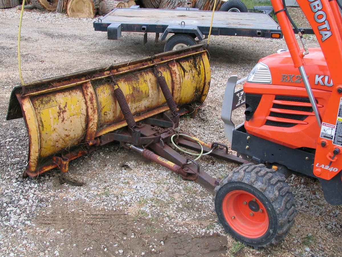

I bought a Meyer 6.5' plow on eBay for $100 last spring and I am just getting around to fabbing things up to make it fit my Kubota.
I struggled with whether or not I should remove the FEL to plow and in the end I just decided as you said to use the "roll" hydraulics to swing the plow left and right and the FEL arms to raise and lower the plow.
Not sure if you have the means, but about 2 hours of building a bracket would have you up and running for any Meyer or other style blade you can find used. For me I plan on leaving the blade that wide. It will be too wide for heavy storms, but 80-90% of the snow storms we get here in Indianapolis are 2-4"s. If it proves to be too wide I can always cut it down. I am repainting and cleaning things up right now, but here is a shot from last summer.
