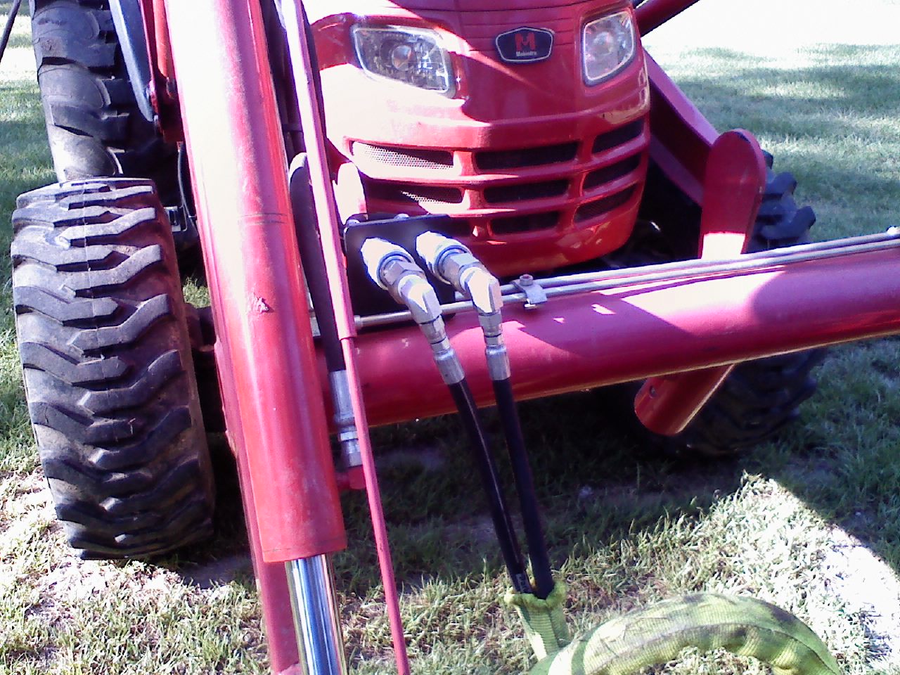

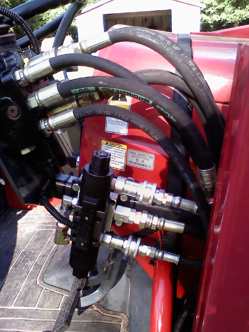

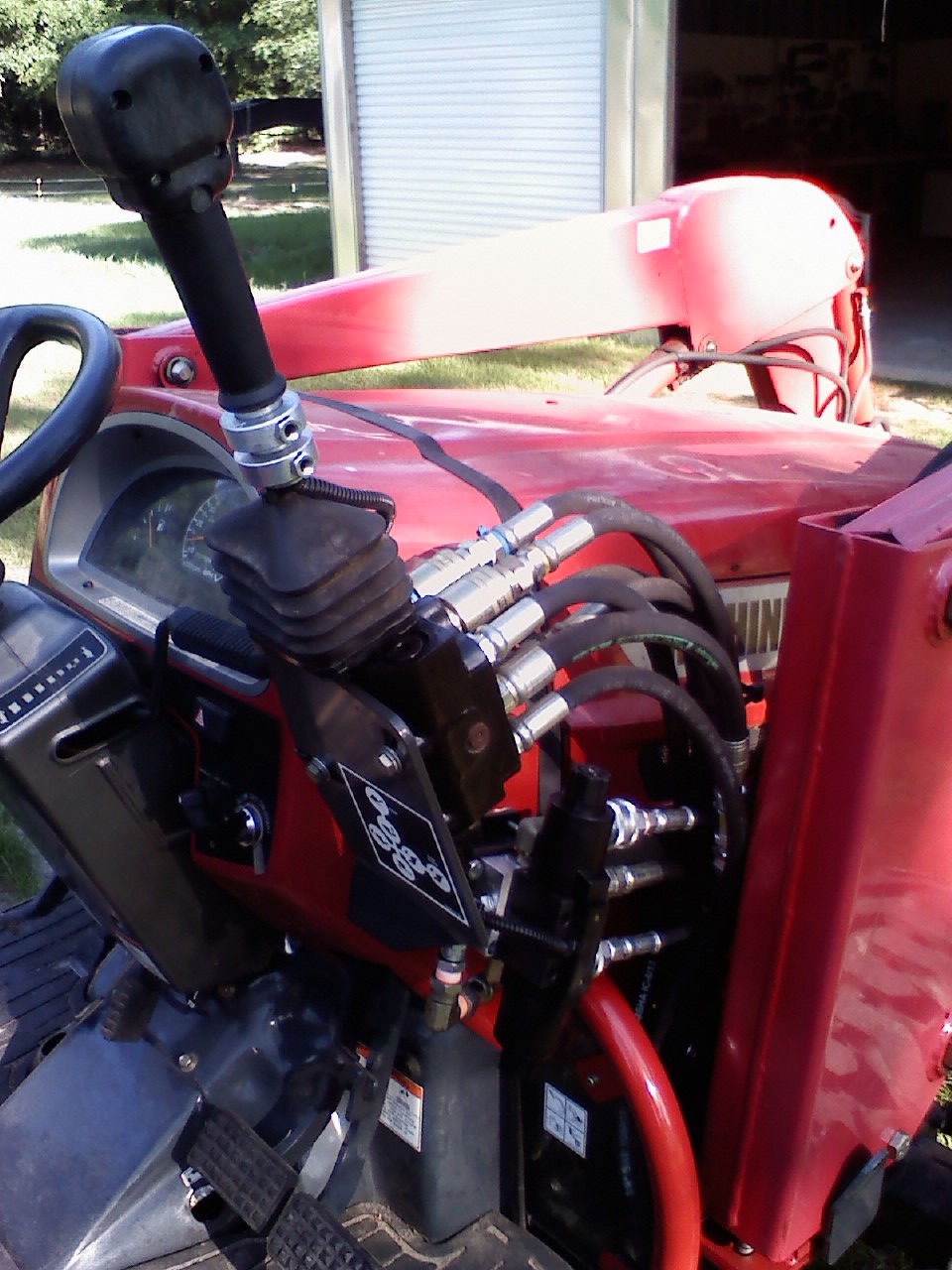

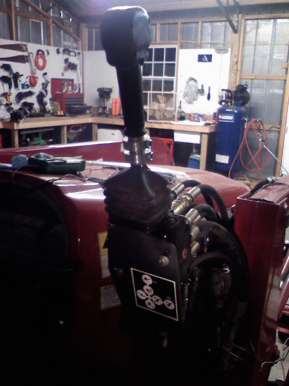

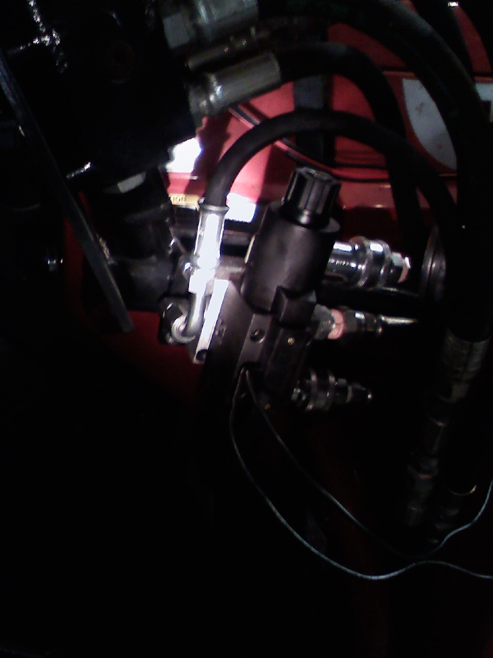

Hello all, I have been running my grapple off my rear remotes and decided to get a hyd top link and needed to free up them rear remotes for it, so I bought a WR Long elec over hyd valve kit to add front remotes to my Mahindra 4110. So far the install is going good have got the valve mounted and the plumbing done still need to do wiring and weld the front QA bracket. I have a question the instructions says, Using the 3/8" hose provided in the kit, connect one end to the "T" port on the WR Long valve and the other end to the bulkhead fitting where the power beyond hose was before. The problem if it is a problem is the only hose that came with the kit that would fit the "T" port fitting was a 1/4" hose. Is this going to cause problems being it is a smaller hose? The original hose was 3/8" will post a few pics of progress so far, it was dark out so the pics are not the best. Should get the wiring done tomorrow so I can test it out. Thanks Mike

1/4" hose is to small for your machine...Call WRL and get the correct hose.
   / New install elec. over hyd valve kit ?
Thanks for the reply, I will change it to 3/8" hose......Mike

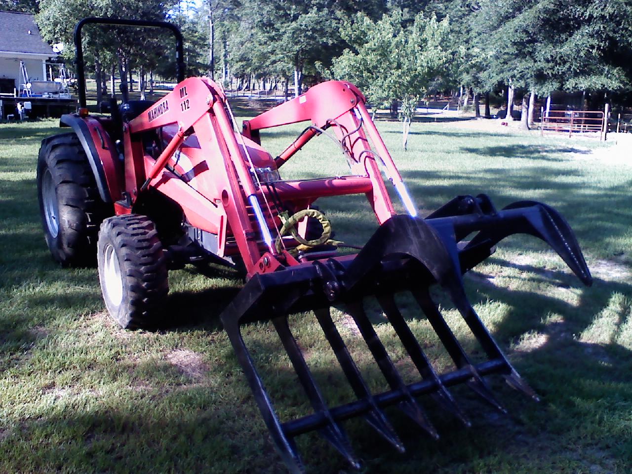

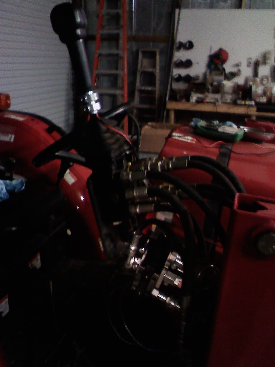

After getting the right JIC fitting for the "T" port the 3/8" hose was on and the grapple works great, some more pics.....Mike
