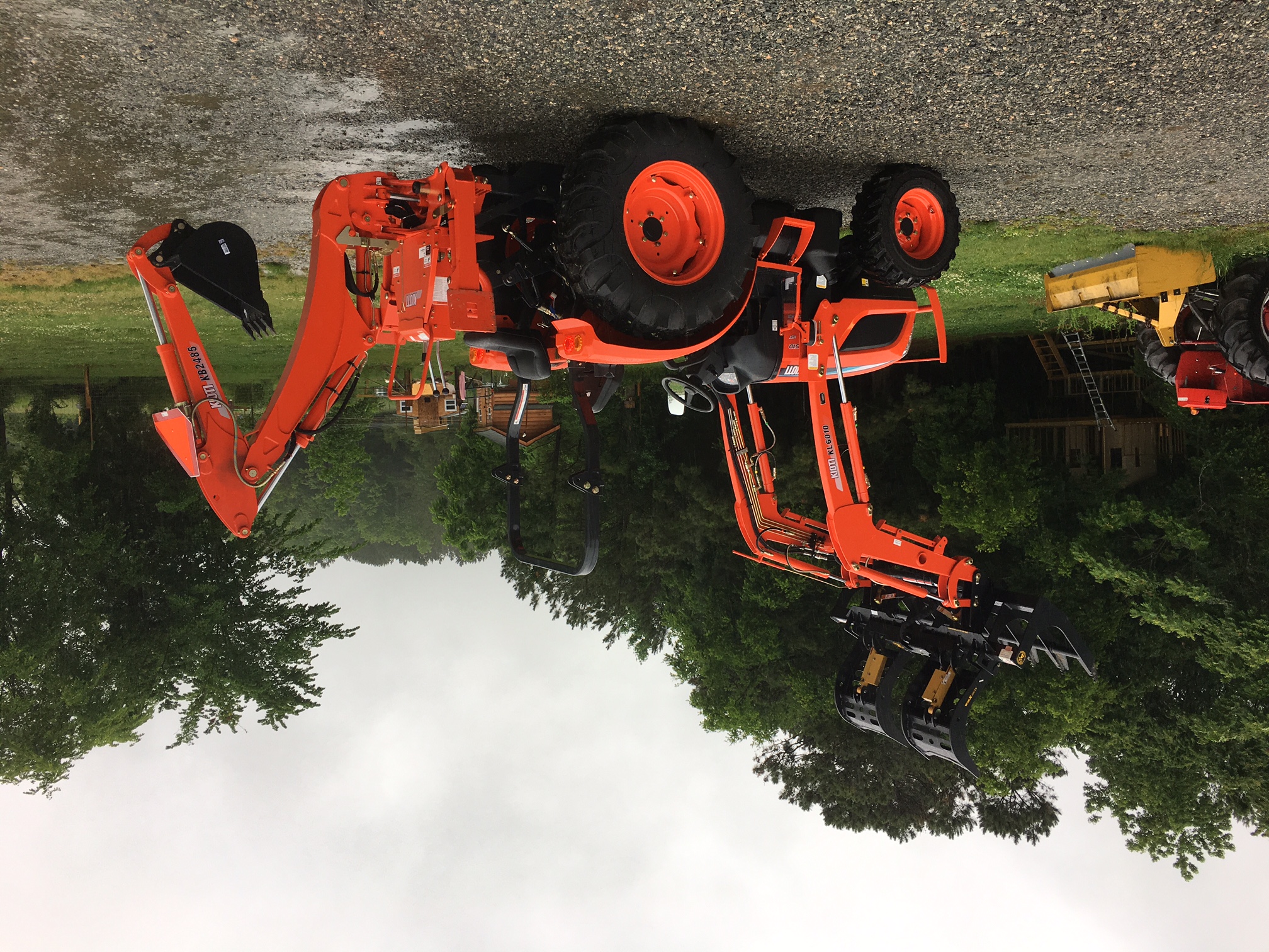

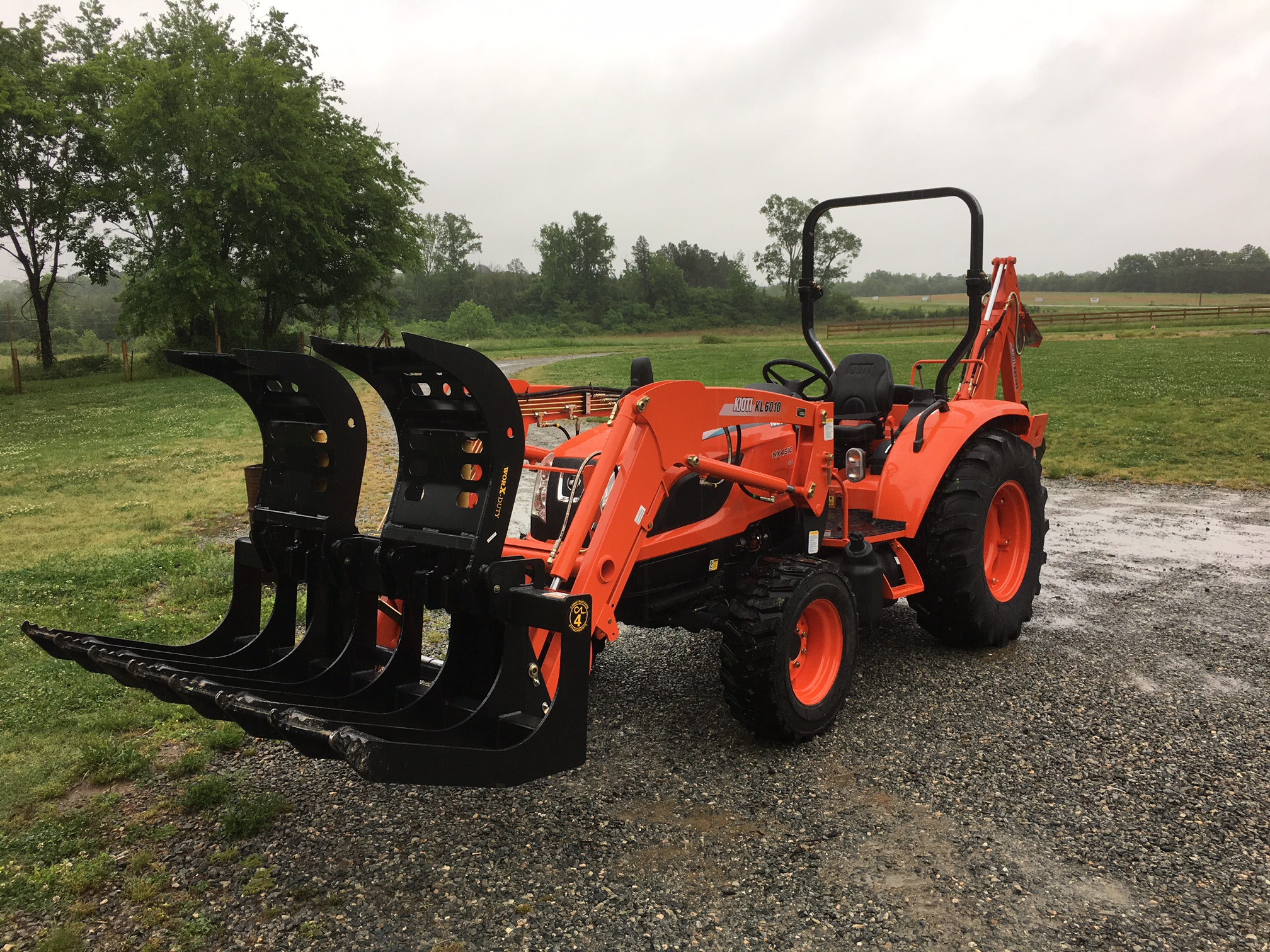

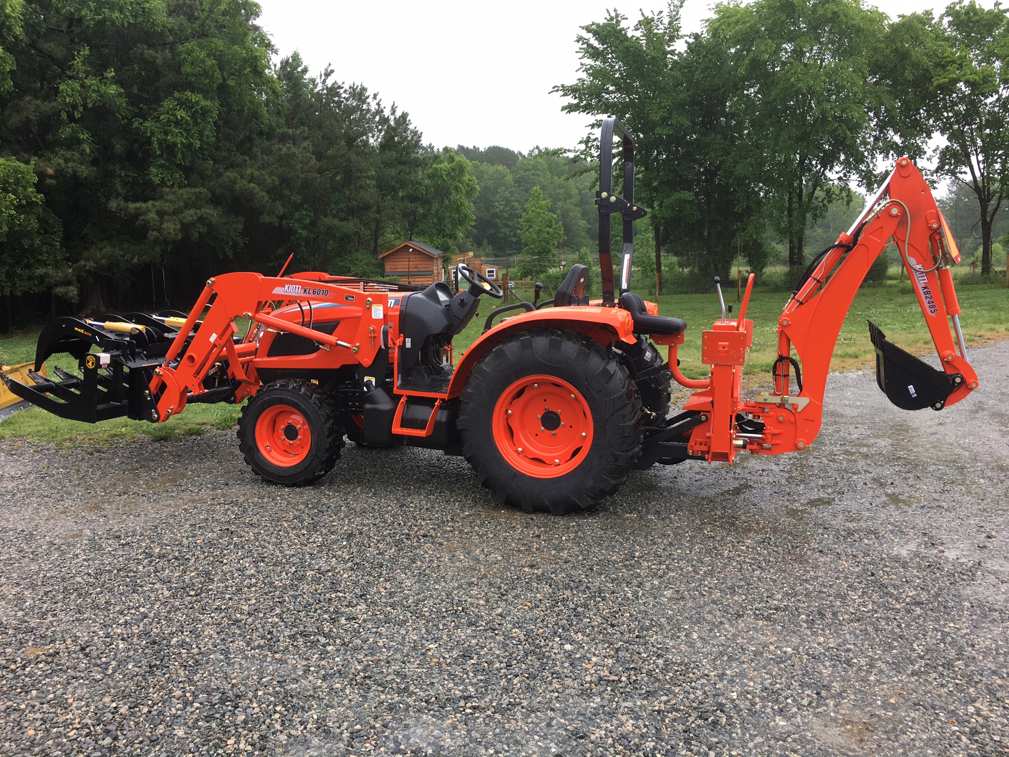

After two weeks of waiting I received my Kioti NX4510 HST today, along with the grapple, loader and backhoe. Its been raining for the last 3 days so I was unable to really work with it. I did all the arrival checks you guys above kindly advised (so far as i could) one god thing about the rain I had plenty of time this afternoon to familiarize myself with the unit in general.
Hopefully this weekend when the weather clears I can get started actually using the machine.

I not only put locktite on the nuts holding the loader level indicator tube in place, but I staked them in place with an automatic center punch. One of my favorite tricks for holding a nut on a thread. Lets see them sum britches come off again. And they haven't in 5 years of use. The factory tightening lasted about 4 or 5 hours before they came loose, and I wadded up the indicator rod.

Don't forget those loader level indicator rod tube nuts.
