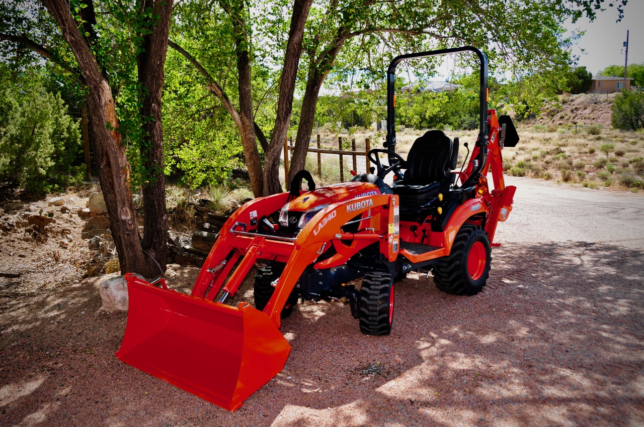

I was deciding between an LS MT125 and this Kubota BX23S. I bought the Kubota BX23S on Monday and it was delivered today. There wasn't much sleep loss here. I ordered it with a canopy and work lights but decided to just get them elsewhere so I did not have to wait up to 2 weeks for them to come in. This is an upgrade to my 2008 BX25 and I love it!

2. The wheels are a little different tone of orange compared to the tractor (see picture). Is there another tone of orange being used?

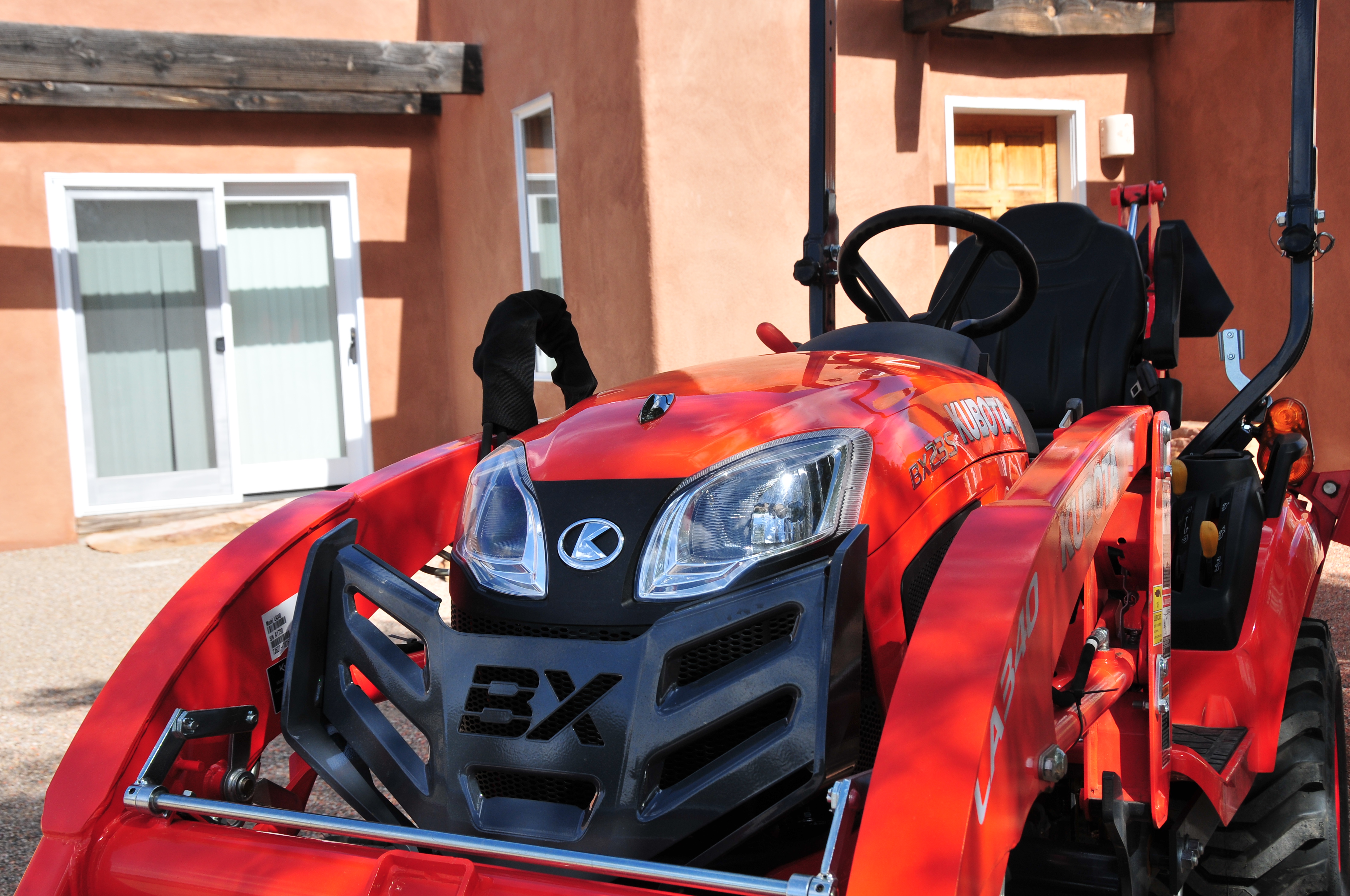

3. I don't like the loader hoses sticking up so much above the hood. See picture of my old BX (the one with the canopy). It looks nicer with the hoses not so prominent above the hood.

5. Oh, and HELP, I can't open the hood. I haven't looked at the manual but is it a pull (per arrow) a push down. I think it's stuck (not good Kubota).

I think the loader line's stick up so to allow slack for the whole loader removal. Looks a lot like my set up. The tires/wheels are (I believe) from a 3rd party and the paint may not be an exact match.

For the hood, push down on the hood slightly right in the middle, by the latch. Then it will slide easily. :)

The hood latch is an odd arrangement. Basically, if you are standing at the side of the tractor, squarely facing the latch, you simply lift it slightly, and pull horizontally straight towards you. Easy once you do it the first time, but awkward initially to figure out, based on the silly arrow.
That worked. Awesome! Are they all like that? It's like opening one of those secret boxes.
