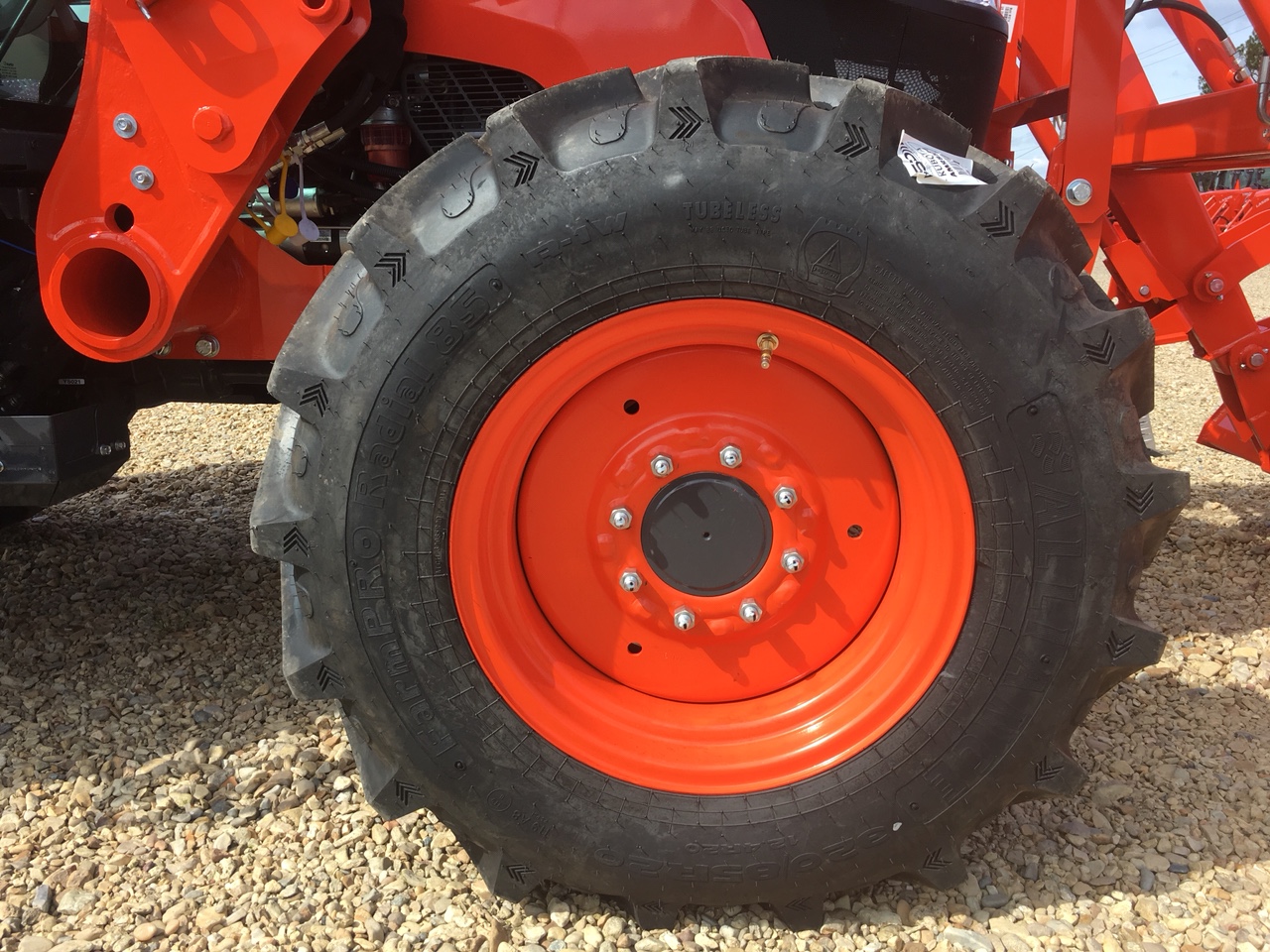

Could have ordered it with optional radials.
Yesterday, I looked at an M6060 at my local dealer with optional radial tires. The fronts were at least as wide if not wider than the fronts on my M9960. Certainly a much better looking and, no doubt, functioning alternative.

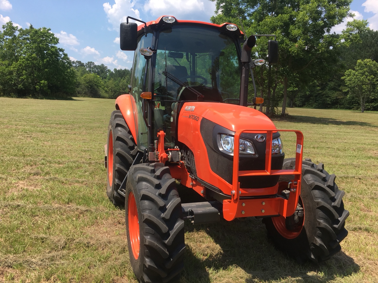

Hello and welcome. We took delivery on our M7060 this spring. I also didn't like the pizza cutter front tires. We ordered it with the 320 radial front tires and 480 radial rears with cast centers. The cast centers and loaded tires make the machine very stable. Since you mentioned the hilly terrain, I'd definitely recommend loading your tires with Rim Guard. If you didn't get the the cast centers, I would also add 2-3 sets of wheel weights.
Changing tire diameters on a 4x4 tractor can be expensive unless you can keep the same ratio between the front and rear tires. If the ratio changes, you also need to have the gearing in the front axle changed.
My only real complaint with the tractor is the Teir4 emissions. We are a small acreage farm and don't have a lot of tasks that take hours to complete. After 49 hours on the machine, it is getting ready its 4th regeneration. Not a big deal, but its kind of annoying when you are in the middle of a task that can't use full rpm.
