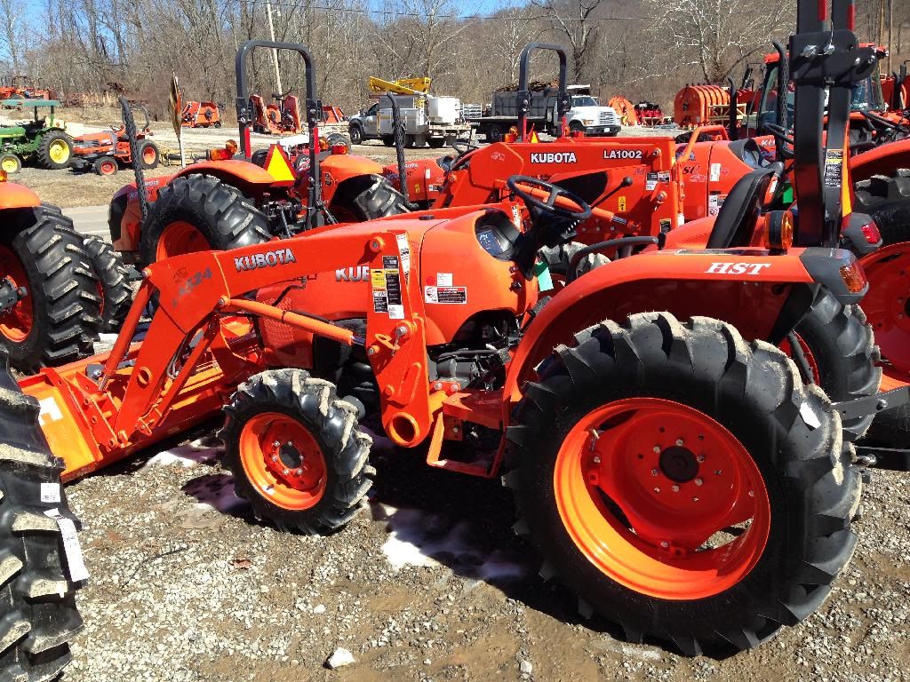

Hey folks. New here to the forum and I just bought a new Kubota L3800 with FEL. I haven't got to play I mean work with it yet but I'm getting excited. Anyhow I was wondering what size trailer I need to look for to put this tractor on with the FEL and a rotary tiller. Also will my Ford F150 with the 5.4 V8 pull this setup around? I won't be going any long distances just mainly 5-8 miles from farm to home. Also does it hurt to drive these tractors on the road for a few miles in 2WD? I friend told me it was hard on it to drive it on the highway. Looking forward to all of your knowledge!

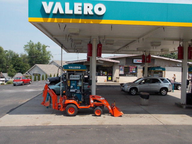

Elmer,
Good luck with the new tractor. Your F-150 should be fine for short trips. I would get a 18-ft construction trailer and add a braking control device to your truck.
I drive my BX-25 around town in 2wheel drive with no problem.
