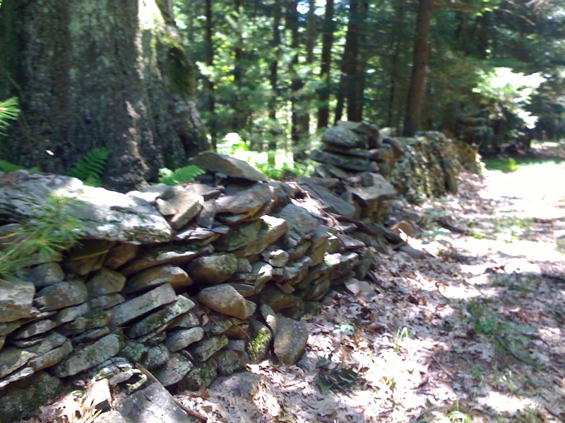

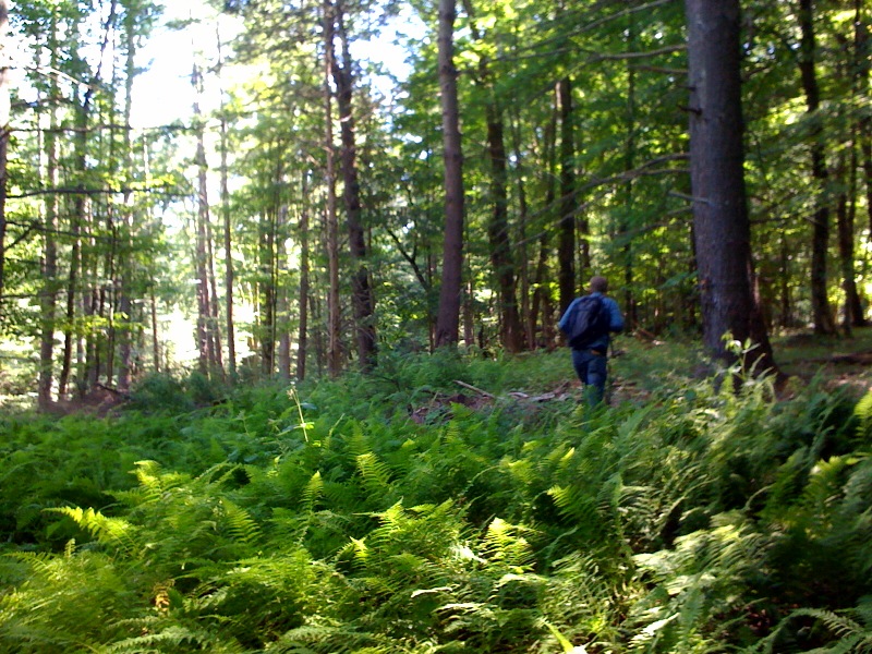

Seems like the general consensus is pics are needed so here you go. Not completely comprehensive but this is all i have with me and should give a general idea what I am up against. Thanks everyone for the feedback so far.
The land is generally pretty flat to rolling. This is one of the steepest slopes and one of the less dense sections of woods. This is probably the area I would cut a new driveway through to the new home site.
Some good-sized access roads run from the existing house through the property. Some timber has been cut off parts of the property and I suspect that is where a lot of the mess comes from.
This is typical of the type of debris that scatters much of the property although there are enough downed trees (probably Irene) to heat half of Canada.
Just a nice picture but the density surrounding the creek is pretty typical.

Clearing the five acre plot might best be contracted out as there appear to be some nice lumber trees involved. The clearing of that area should be carefully planned to make best use of of the existing features before they are gone.
The rock walls indicate you may have a lot of rock to work with so that should go into the tractor/implements decision.
