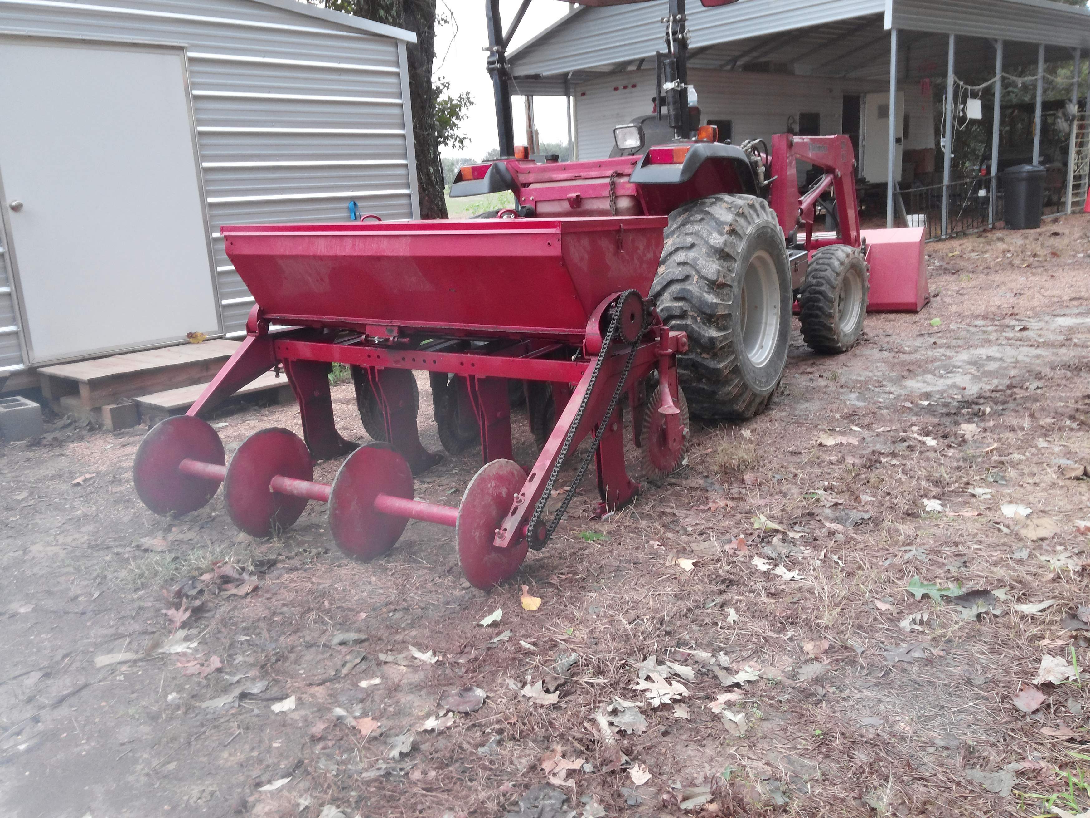

I can't justify that expense for the few acres I plant for Wildlife foodplots. I use a OLD Taylor Pasture Dream to plant commercial Deer Mix (50% wheat) in soybean stubble. It does a pretty good job.
Drilled

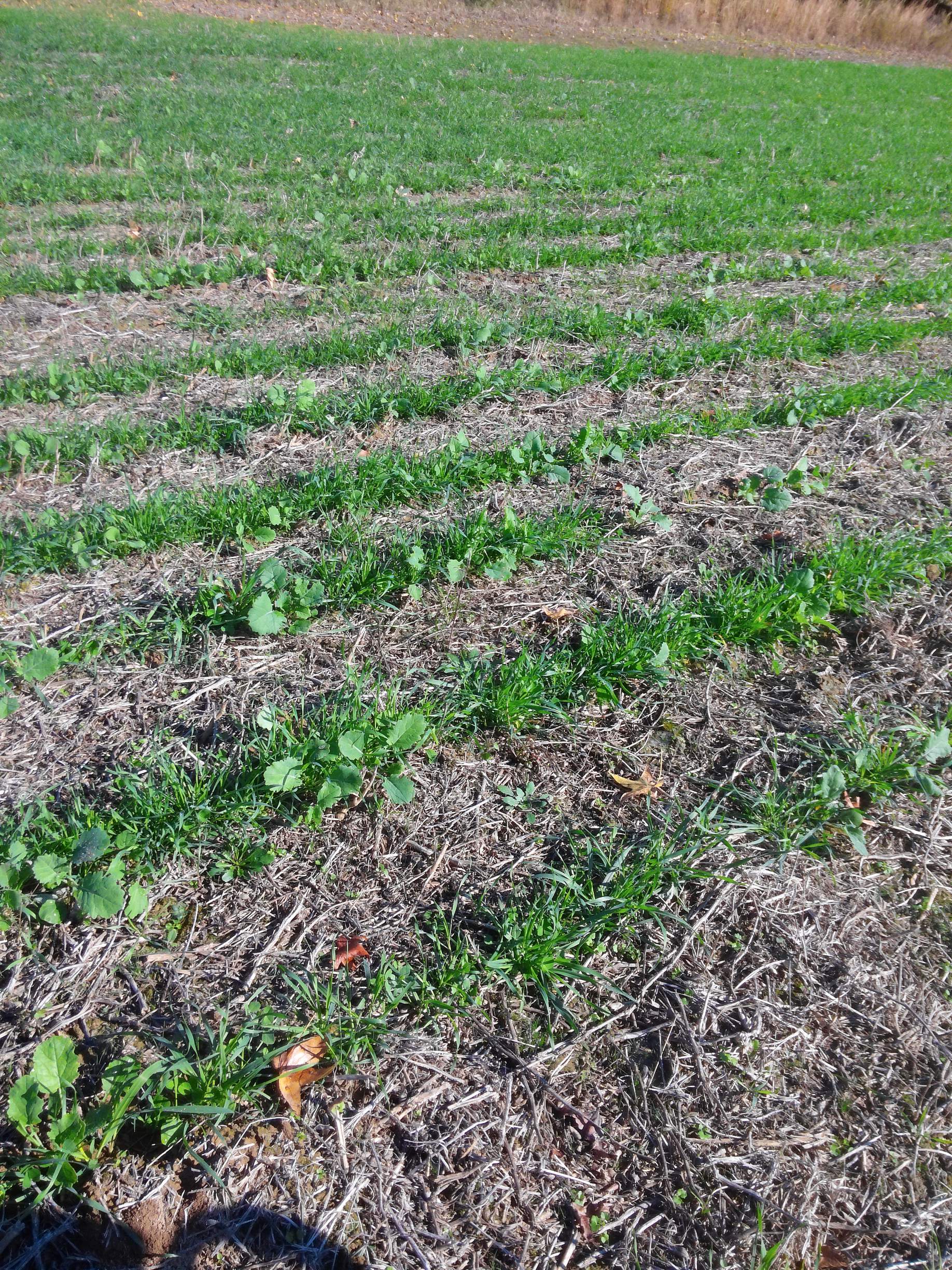

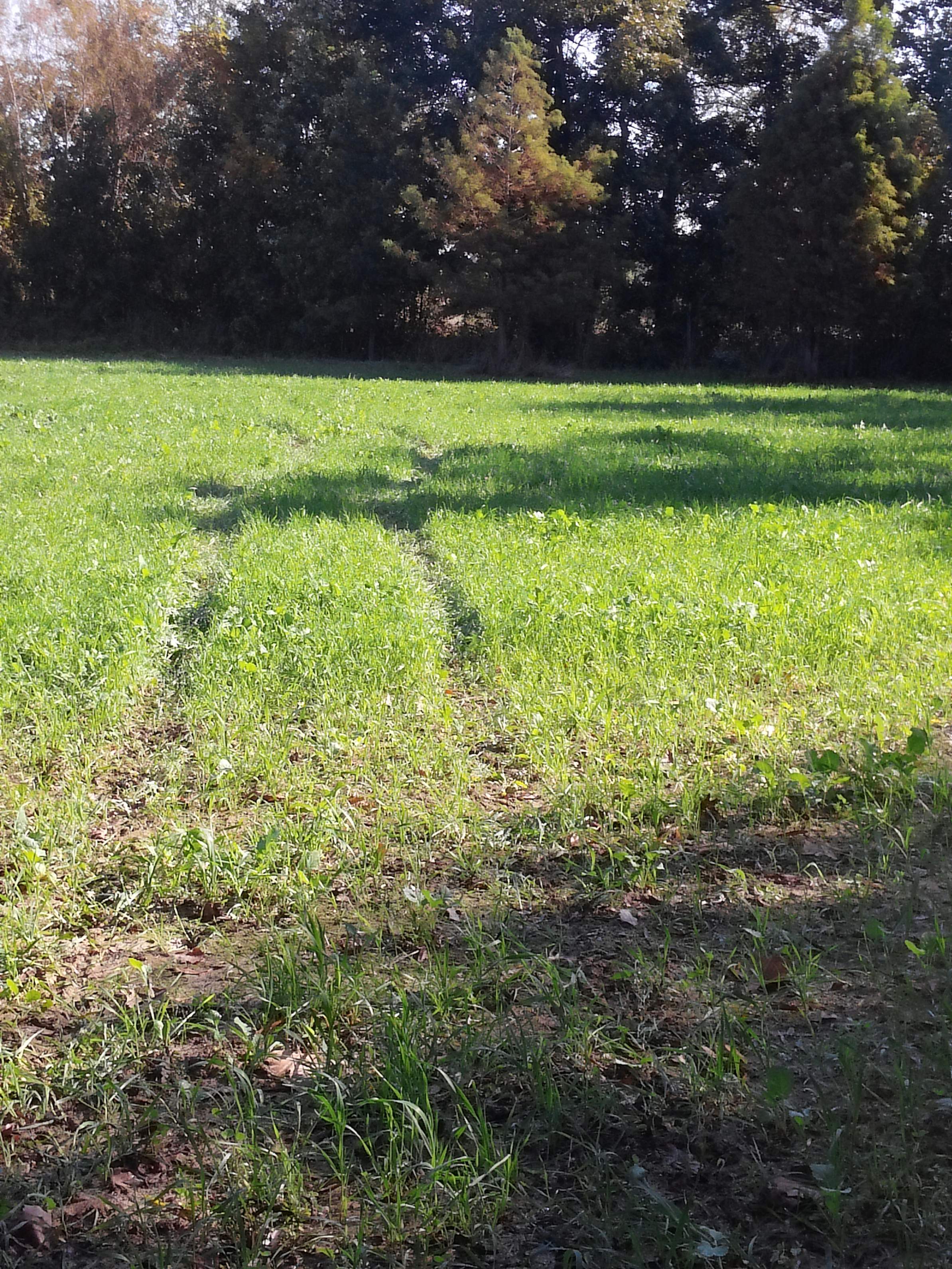

Disked, broadcast, cultipacker

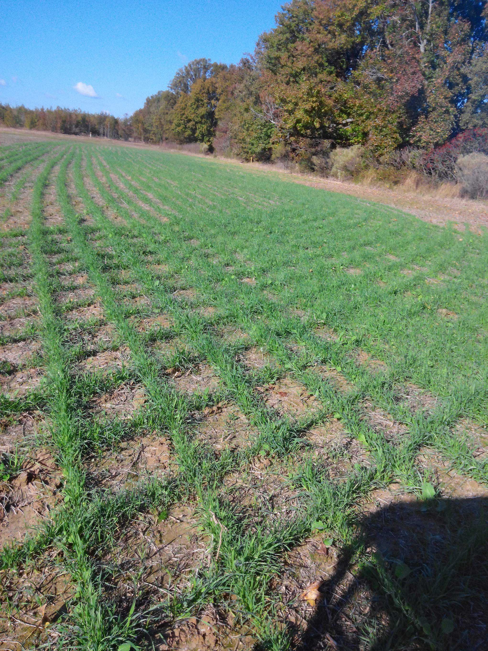

wen,
first time I used the drill, planted seed too deep and got about 10% germination. The fields in the pic were planted just in the furrow and what little dirt was on the seed was from the press wheel. It was up in 5 days after a 1 1/4" rain the second day. If you don't see some new growth pretty quick with moisture and ground warmth, maybe the seed is too deep. Also you are planting into existing sod as well. Good luck, when you get that bad boy right, you're planting is going to be quick and fun.
