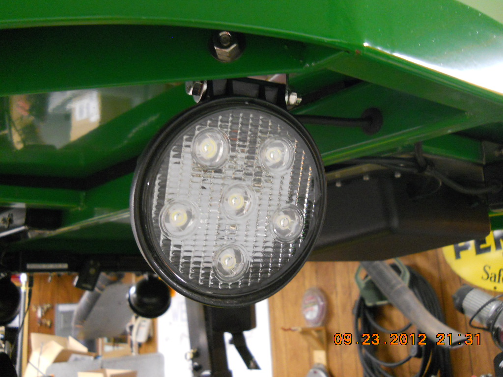

2x 18w High Power LED Work Light Lamp 4x4 Offroad Tractor Truck Flood/ Spot 12V | eBay

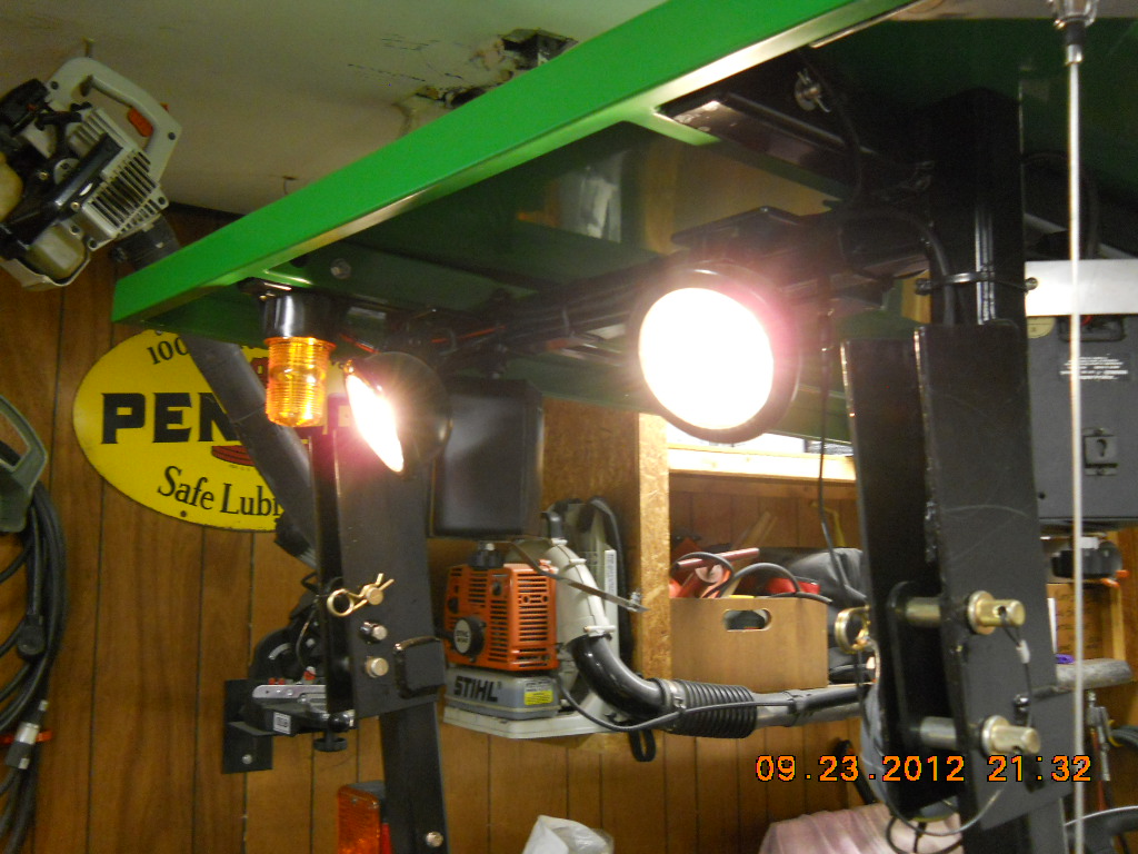

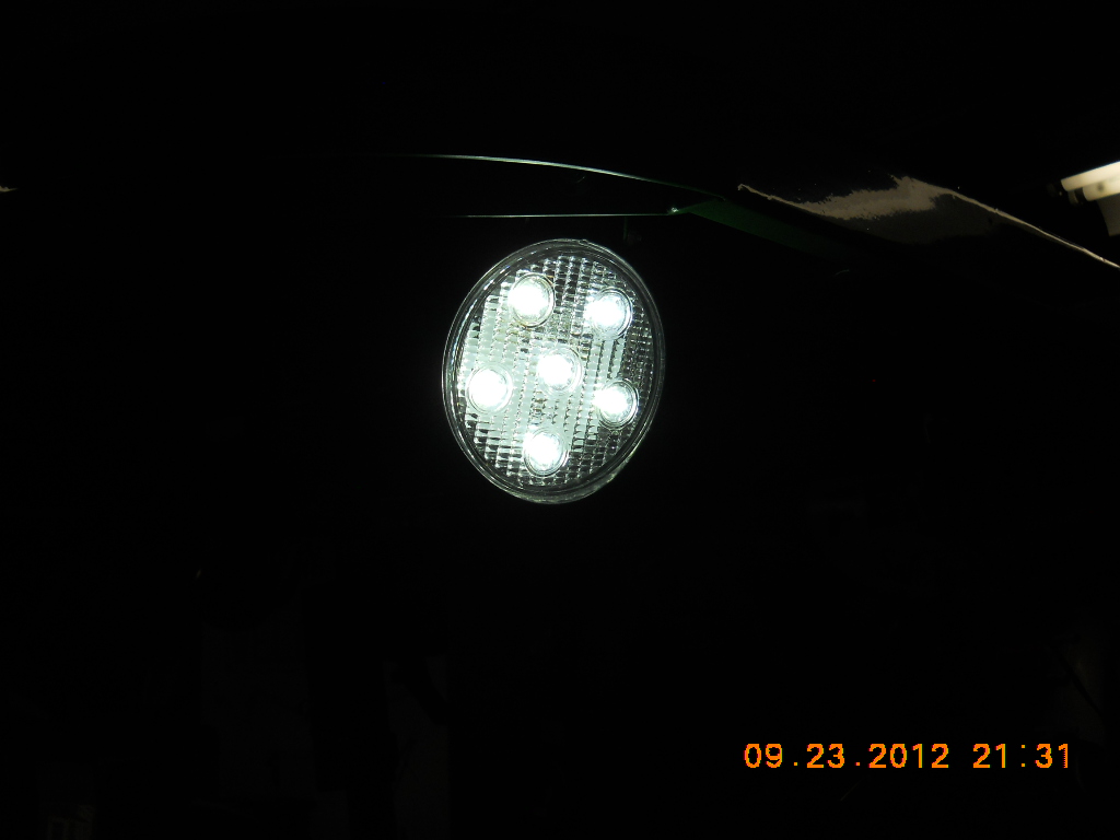

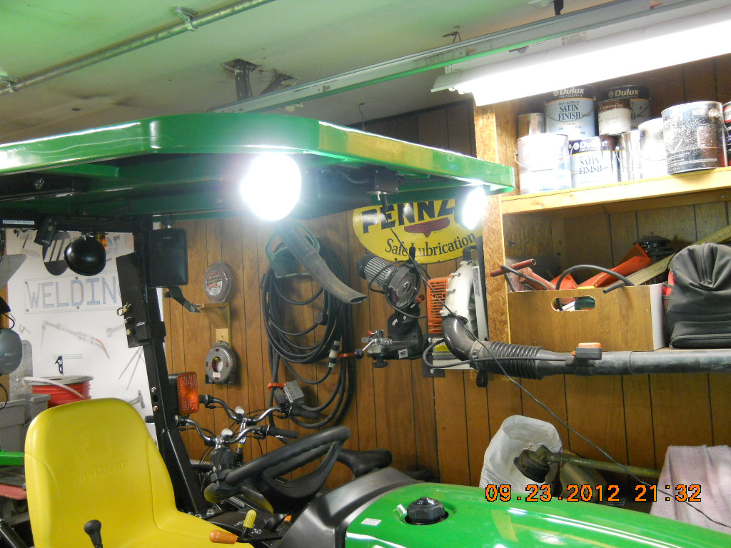

This ebay link is where i purchased my new lights and they are very bright and very well made.
My factory lights on my 2012 model JD2320 fail in comparison to these lights and they are only the small 18 watt version.
my rear work lights are tsc 12 volt sealed beams. they might as well be lanterns when comparing them to the new led lights.
save yourself some money and buyers remorse.

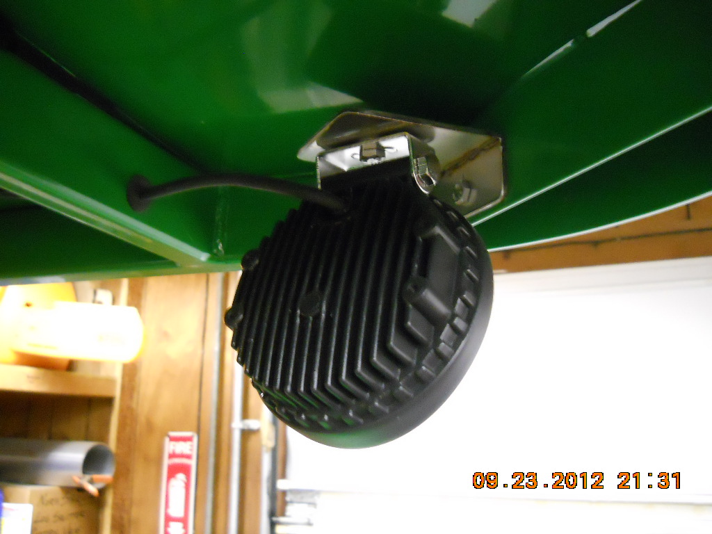

stainless mounting hardware included in the (2) two light set. not one light most sellers offer for the same price.

these models are a flood light than a spot light or pencil beam.
just perfect for my snow plowing needs and yard work after sundown.

the amperage draw on the alternator is much less than halogen or sealed beam.
i am going to replace the rear work lights with the same models.
