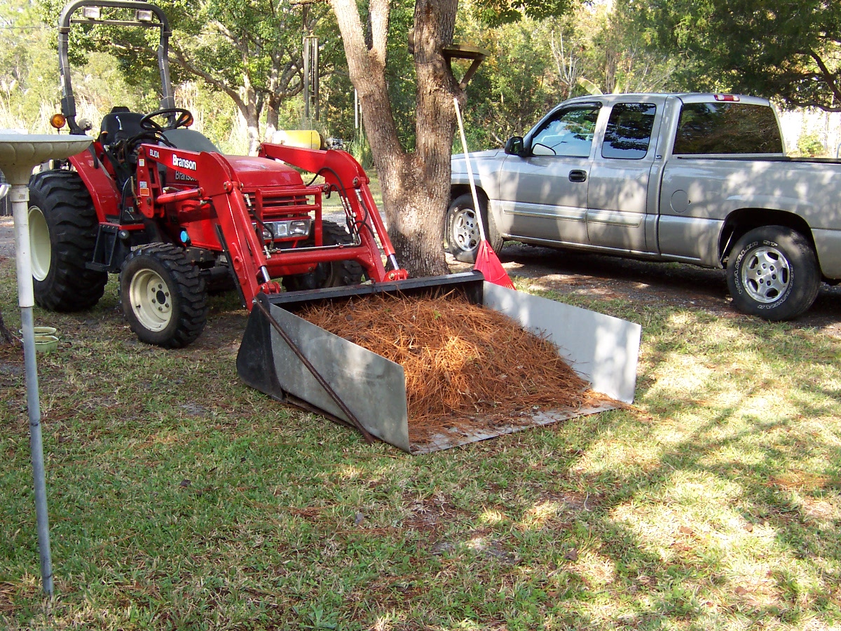

So I'm looking for a lager bucket for my loader, it does not have a quick change mount, any ideas on what size and where to get it?, I move around a lot of dirt and think I can lift and move more than this stock one will allow. Anyway, any help would be great! Thanks Bob

You could make something like this for your bucket.

Hello Stimw, I like how you improvised on your bucket to pick up more items. I have a ton of mature oaks that I have to pick up leaves for every year and your idea may save me a lot of time. Are your support rods bolted to the bucket or do you have the stud welded to the bucket and just attach rod and tighten with the nut? Also was wondering what is the material in the middle holding the straw made of? Thanks in advance
   / new loader bucked for 4720 with BL20 a loader #4
I had an old frame piece that I modified to go under the scoop for support.
The rods just have 3/8" bolts that I place in drilled holes in the sides of the bucket.
I use a small ratchet strap underneath attached to the frame and around the back of the bucket to hold it in place.
I can have it on or off in minutes.
I threw it together kinda fast but it works great. I can't scoop with it but I didn't want to. I just place it on the ground and rake into it.
   / new loader bucked for 4720 with BL20 a loader #5
Excellent, exactly what I need to do to mine. Thanks for your help. Have a great day!
