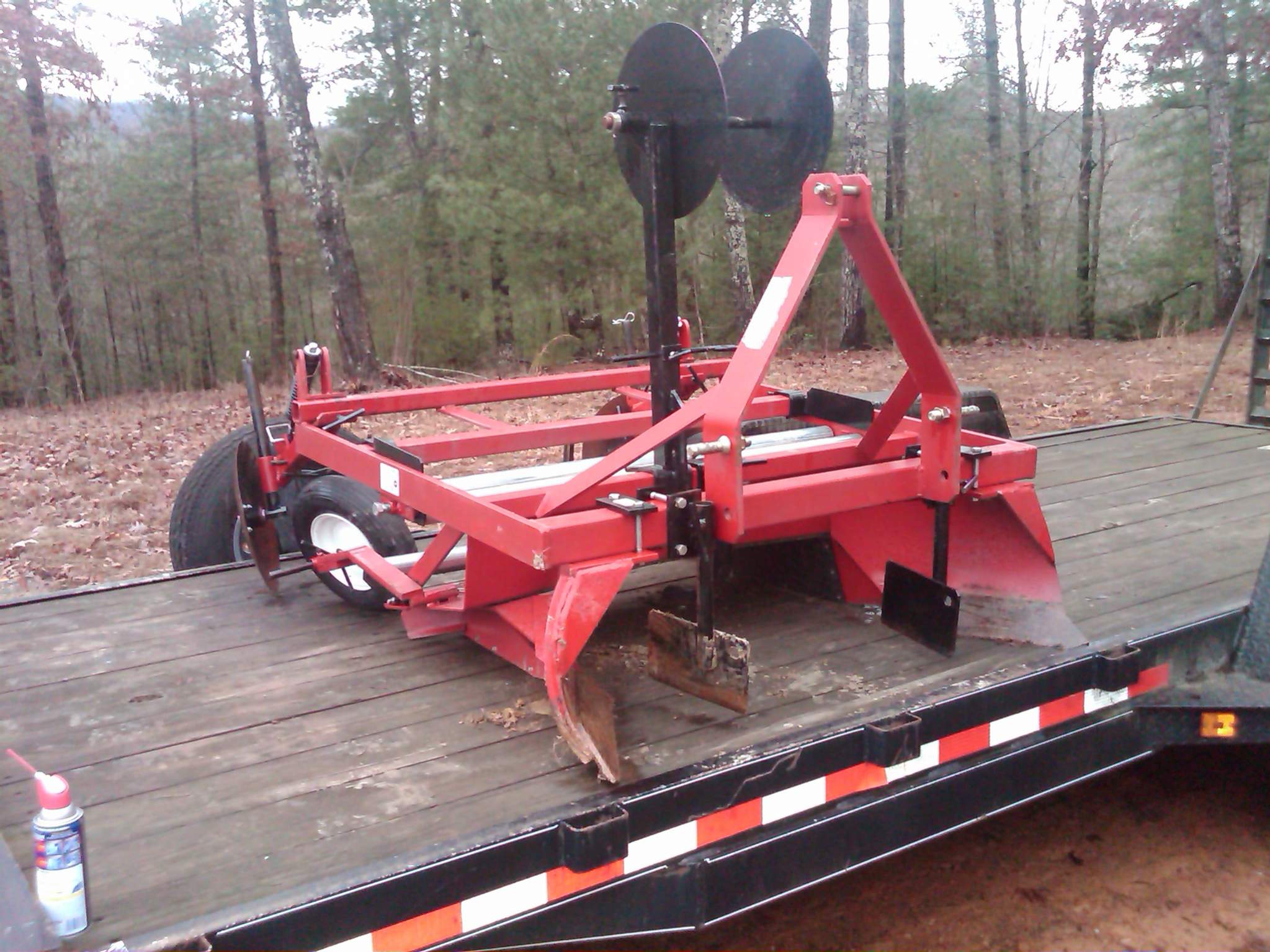

This year we found a great deal on a used plastic mulch layer for a compact tractor that I believe will save me 75% of my labor weeding. Because of this we will plant 3 total acres but not all on mulch.

Motownbrown what do you grow on the 1.5ac?
David
