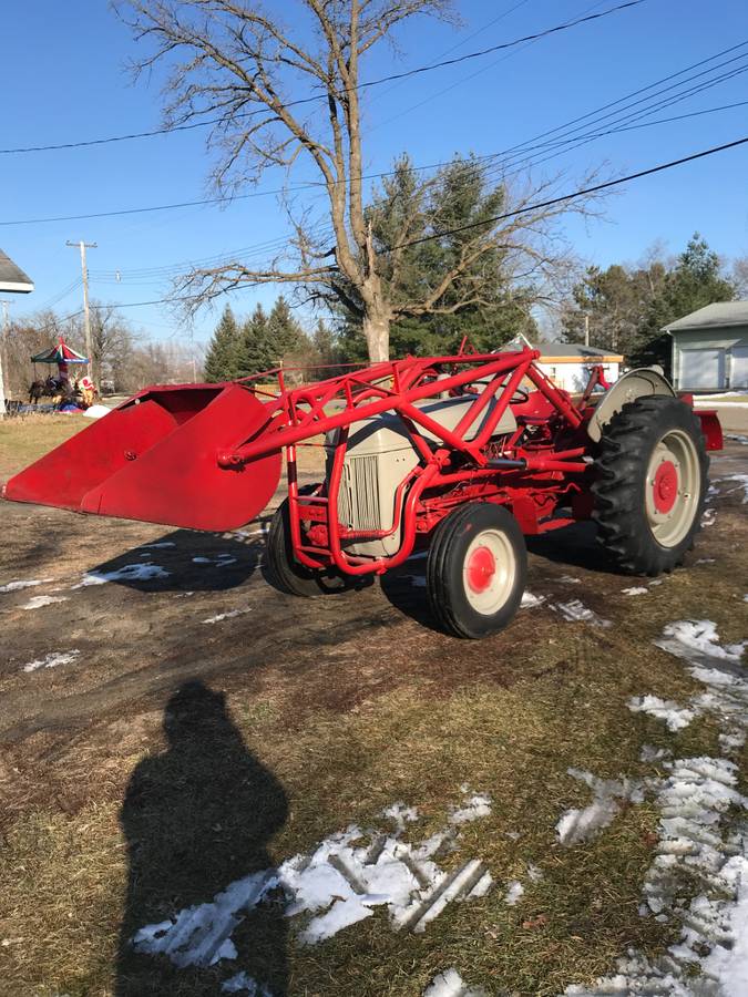

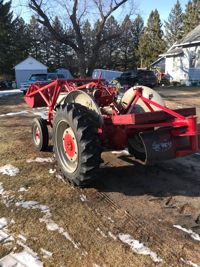

This one here is one we are thinking about looking at. It looks clean. It has the 12 volt system, 4 like New Tires, back blade and Front Hydraulic pump for live power on loader. They are asking $4,000. I was going to contact the seller for more pics and info as they did not state the year.

That is a clean looking 8N, but at $4,000 also is at the top of the price range.
If you load that bucket with anything heavy, and are in your soft wet ground, you will not be able to steer.
8N's do not have power steering!
   / New Member Looking At First Tractor - Ford (9N/8N) #3
Old tractors are neat and you can get things done with them , But fried is right ,that loader is useless and 4 wheel drive is a must on small tractors. Spend a little more and get something newer and more capable especially with that much land. Good luck in your search.
   / New Member Looking At First Tractor - Ford (9N/8N) #4
The old Ford tractors are kind of cool and easy to maintain but do have shortcomings. The 8N was an improved version of the 9N and the NAA was next in line with even more improvements. One might be nice for pulling a mower or trailer but you need to evaluate on what you plan to do with a tractor. An old Ferguson TE-200 would be cool, too. If you want an older work horse look into Massey Ferguson. If you opt for a newer import tractor avoid gray market - they can be hard to maintain due to low parts availability.
