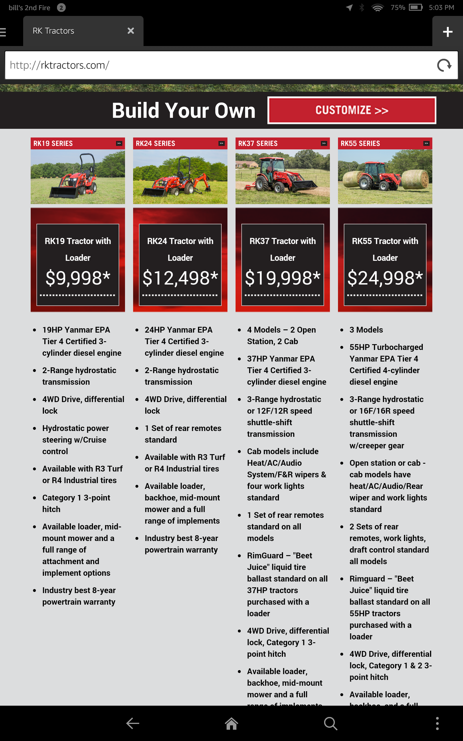

RK are rebranded TYM. No dealer in NY but they are in process of negotiating w/ ind repair shops. For warranty work, 8 years by the way.
Outdoors with the Morgans, A You tube channel has series of reviews, attractive prices,
