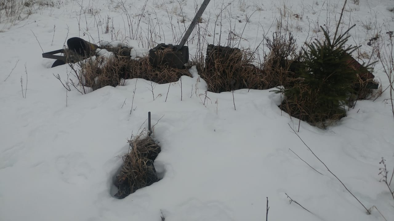

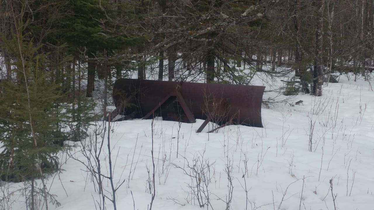

Unknown home made plow

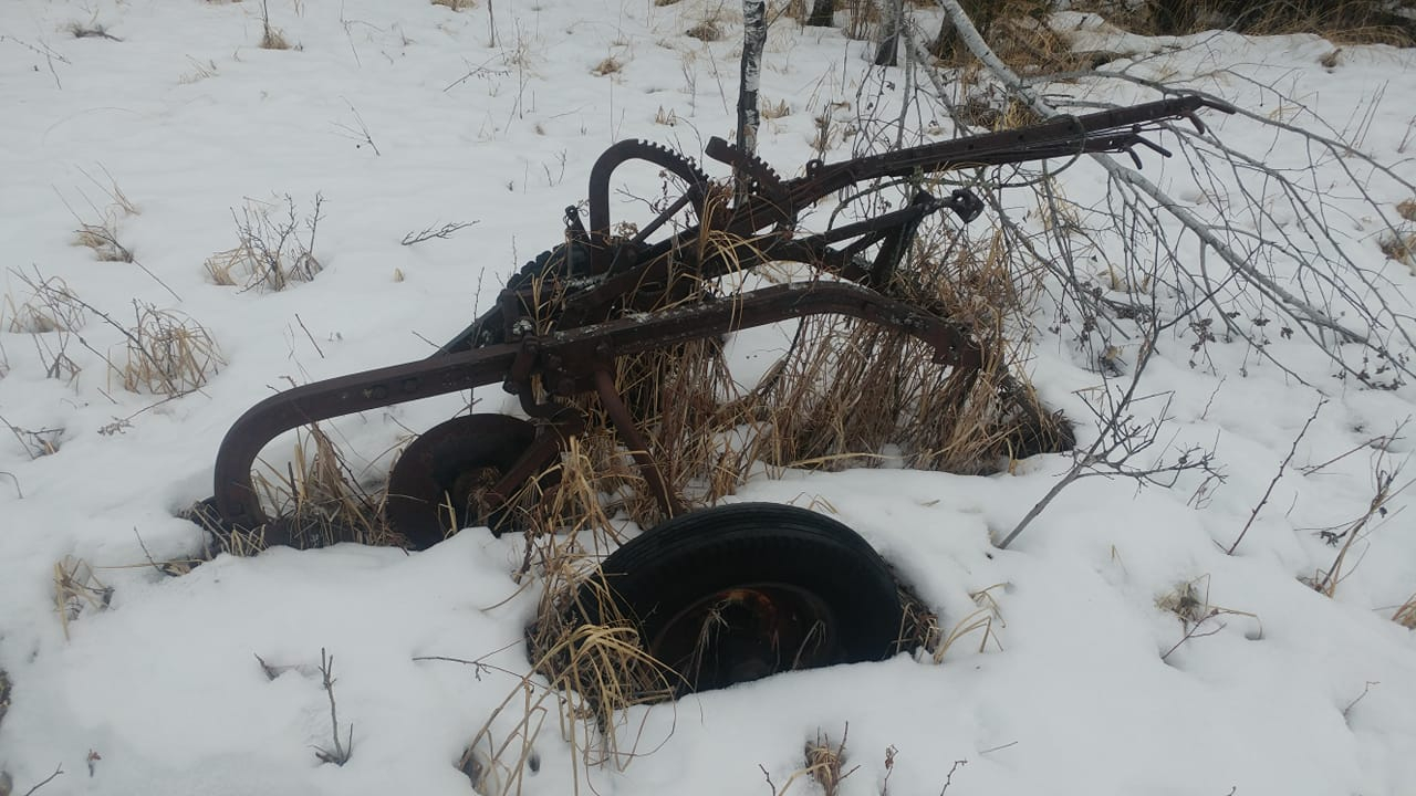

Some sort of moldboard plow?

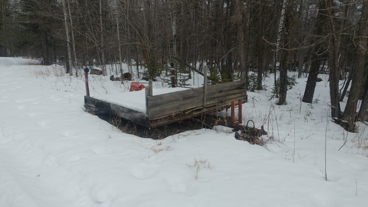

Large 8x8 trailer

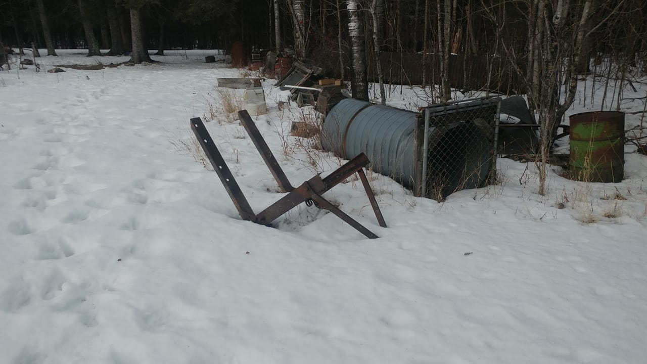

3 point forks homemade

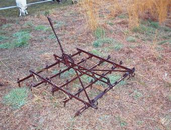

pic of similar item i found a Drag Harrow?

Photo #5 is a TPH Spike Tooth Harrow. Most often used to smooth and cultivate kitchen gardens before planting.

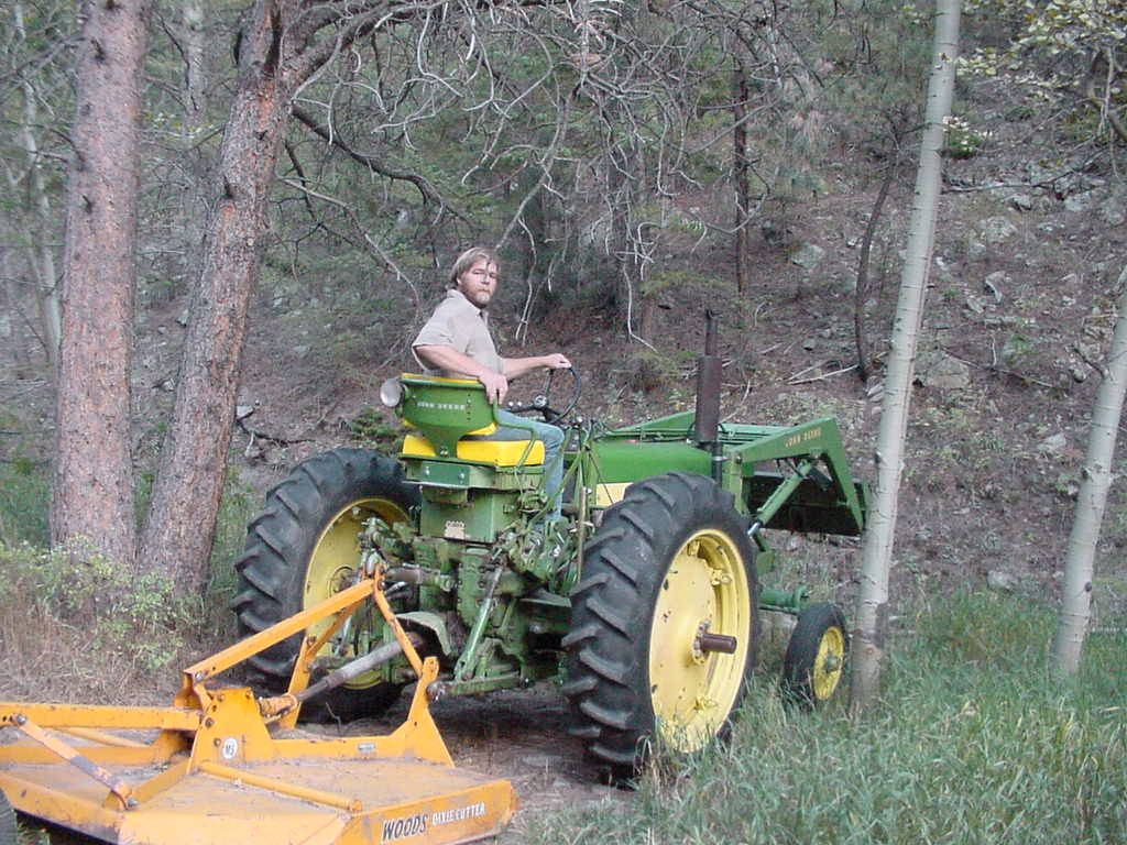

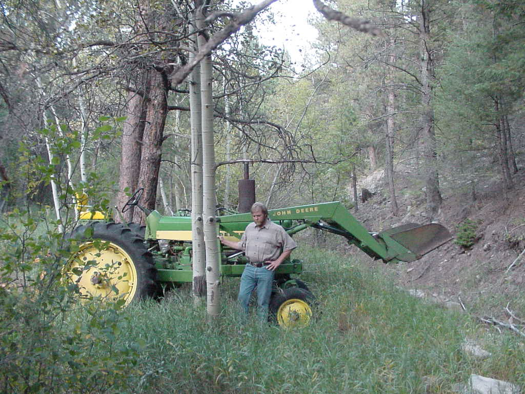

Here's a picture of the one that finally ended up working for us. It's a 1958 JD two cylinder gas engine tricycle we got for $2500. It came with power steering, independent PTO, remote hydraulics, and the nicest 3pt hitch I've ever seen. Over the next few years we added a FEL and the wide front end off of an old JD model A donor tractor. That all came to about another $4500. Almost fourty years later now, and has lived outside (tarped) the whole time. It still works fine and has only required normal maintenance. I just turned down $12K for it.
