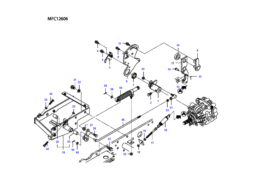

So, I got the GC1705. I have put 6 hours on it and I like the machine a lot, however one thing I am noticing with my machine is it has very stiff forward hst pedal, reverse is not stiff and feels good. During all my research I never saw this as a topic or concern, at least for this machine. Basically, I have trouble keeping speed while mowing, as the pedal is stiff and my leg relaxes some and i find my speed slowing down. I am constantly trying to get back to speed. My knee hurts after 10 minutes (i have healthy knees). The pedal feels even more stiff at higher RPM or under load, going up an incline etc. I have spent time doing searches for this complaint and found nothing. I checked the obvious things and I can confidently say the issue is not binding linkages or pivot or roller/cam, or return spring. Dealer stopped out and also agreed. Dealer asked Agco about it and they didn't have any answers. I am going to test drive other ones at the dealer to see what those machines are like.
Thought I'd ask the TBN community if anyone has noticed this with their machine, stiff fwd and smooth reverse?

Thanks, I did check the zerks and grease. What makes this unique is that the rear pedal is easy and the forward is stiff. The stiffness seems to be affected by hydro load, as it gets even harder under a load situation. Since both pedals use the same linkage it seems like a hydro issue to me.... or maybe (wishfull thinking) the fwd linkage design doesn't give as much mechanical advantage as the rear....
   / New Member / new GC1705 / Stiff forward pedal #5
Just a guess. There is a oil damper connected to the pedal linkage. It is to prevent sudden shock to the HST. If it's not working properly, you may be constantly trying to compress the damper. Best a dealer serviced item. #54 on the diagram.
