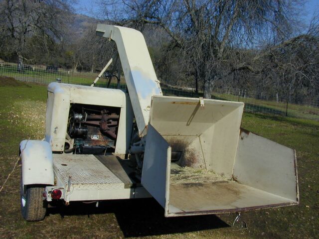

Due to the **** Air Resources Board in this area, most ag burning has been outlawed and, for us mountain residents, "hazard reduction" burning of brush is getting nearly impossible for air quality reasons, they say.
To get rid of brush, I decided to look for a chipper and was unable to find anything appropriate for my little BX for a reasonable price. I found this 1962 Fitchburg for $3K. After reading, on another TBN thread, that Chuch & Ducks may be more dangerous than other options, I decided I needed it. I bought it from the local Arborist. The chips it throws come out at about 0.030" thickness and it gobbled a 6" inscense cedar easily. The old Ford Industrial 6 cyl starts on the first piston up. Very cool old machine!!!
If anyone happens to have a source of info on old Fitchburgs, I'd be appreciative of anything you can throw my way.
Cheers!

   / New member of the Chuck & Duck club #2
"After reading, on another TBN thread, that Chuch & Ducks may be more dangerous than other options, I decided I needed it."
-I like the way you think. It looks to be another one of those "no ******* around" type of tools.
"The chips it throws come out at about 0.030" thickness"
-Woops, you mean like three quarters of a millimeter? Potato chips?
That's cool.
   / New member of the Chuck & Duck club #3
Seems like a pretty darn good purchase to me. However, soon you will find that the real work is the cutting and dragging the trees/brush to the chipper. Of course, you could pull the chipper around behind your tractor, but that never has worked that good for me. I'd rather make a pile and then go "attack" it with my chipper/shredder.
Two words of advice..."ear protection" /forums/images/graemlins/smile.gif
Yep, potato chips ... guess they'll decompose pretty quick that way.
The deal was even cooler than just the machine. The tree guy is downsizing his business to get into other enterprises but still wants to do some tree work. So, he'll "borrow" it from me from time to time in exchange for maintenance/repair work or rental cash.
Cheers!
