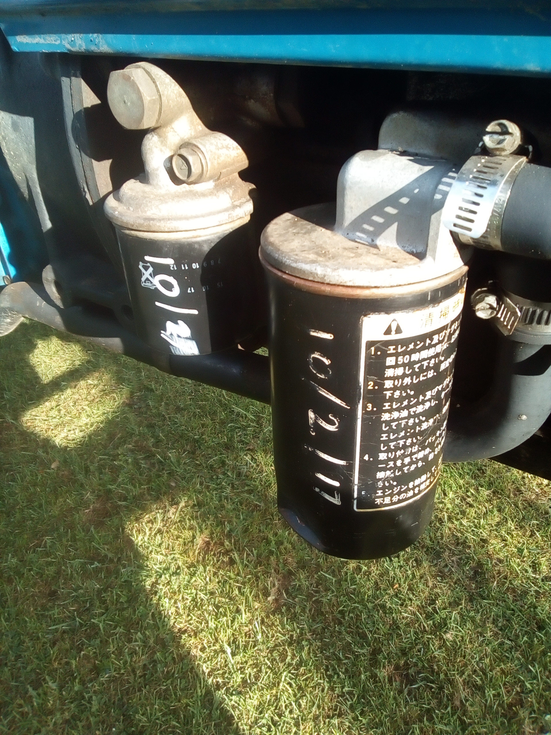

Now in ownership of TL2700. I guess cos its a 4WD its actually a TL2700F.
Been over it looks ok. Previous owner seems to have swapped out oil but not filter.
Fun bit is that everything is in Japanese so identifying filters etc is a challenge.
I appear to be able to source a filter set for the TL2700 from Tracpartz in the Netherlands but ideally would like to find equivalent in UK from from someone like Baldwins.
I am still looking for the engine id on the block as I am confused if its a Isuzu 3AG1 (as stated by TractorData) or a E3AG1 or if in fact if there is a difference.
Does anyone know.
Edited later.
Further thrashing around has led me back to the Southern-Global.com site which has a filter kit FK-TSL listed that appears compatible to the TL2700 and TL2700F (well its listed in the Vehicles tab for the product) it also shows the engine as a E3AG1.
By pulling the oil filter product code of 6913-240-804-0 from that site and using that to cross reference to Baldwin filters it throws up Baldwin Filter B7139.
This I can source in the UK for under a tenner.
Just to confuse things Amazon.com lists the B7139 as a replacement for ISUZU filter 8944637151.
Cross referencing this Isuzu filter gives me the Baldwin B131 which a shorter filter. Diameters etc are the same.
Maybe I am labouring the point but I have to presume the incorrect filter is not a good idea cos of oil flow and pressure.
So (subject to me looking harder tomorrow at work) is it the E3AG1 engine in the TL2700 not just 3AG1 assuming that is a different engine and not a typo on various websites. That should read as a question.
Has anyone had the same experience re the TL2700 and can advise if I am on the correct trail.
