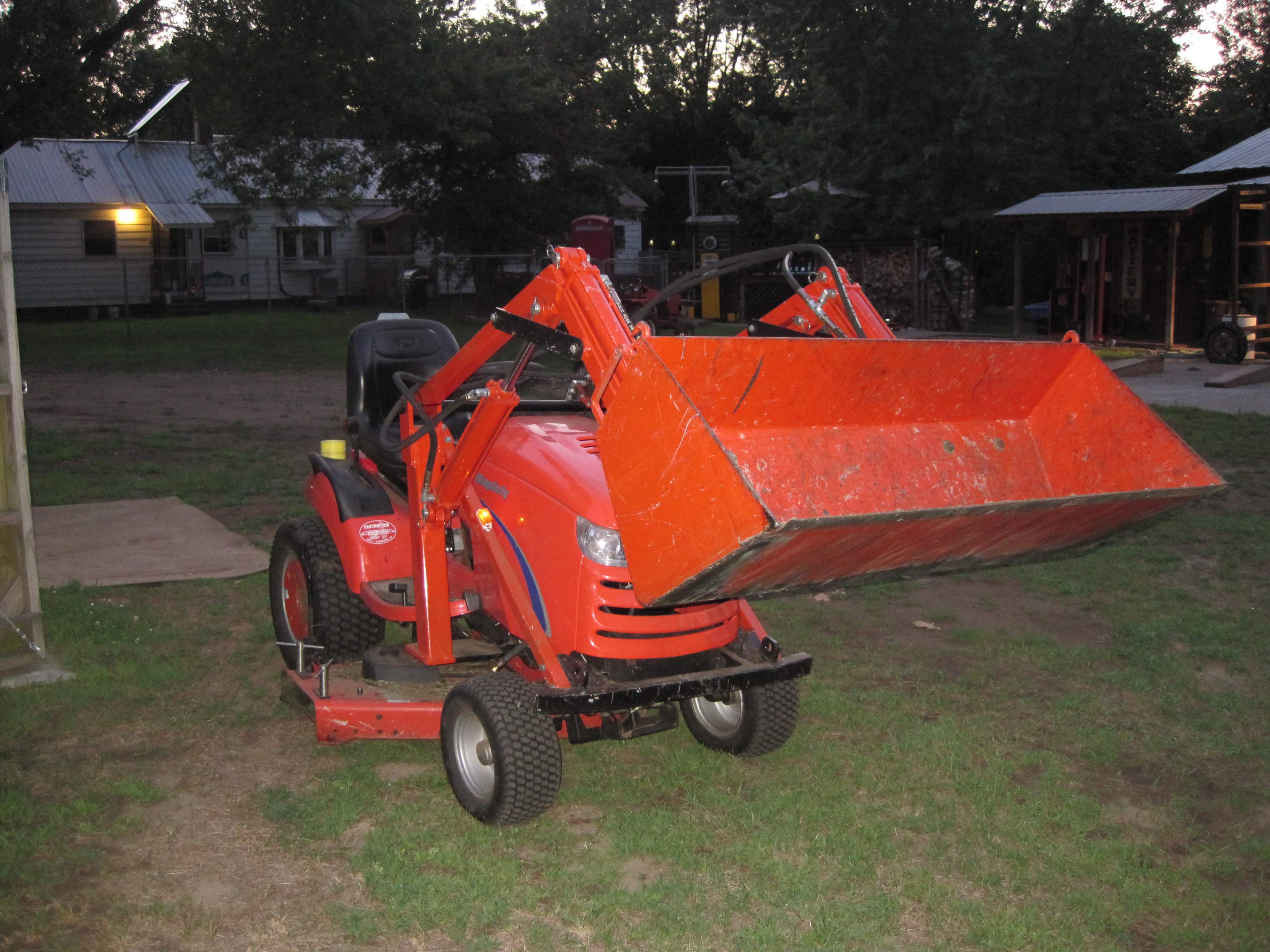

recently built my own FEL for my Simplicity Conquest 23 hp based off plans from PJ Eng.
Its fully hydraulic 1 joystick 4 rams 4 foot bucket can easily hoist 500 lbs
Had to modify Pauls plans quite a bit as his plans based on older large Cub Cadet
My first experience with hydraulics (must say Paul was VERY HELPFULL as I had a bunch of
questions but nearly everyone remarks "it looks factory" and that I musta bought it

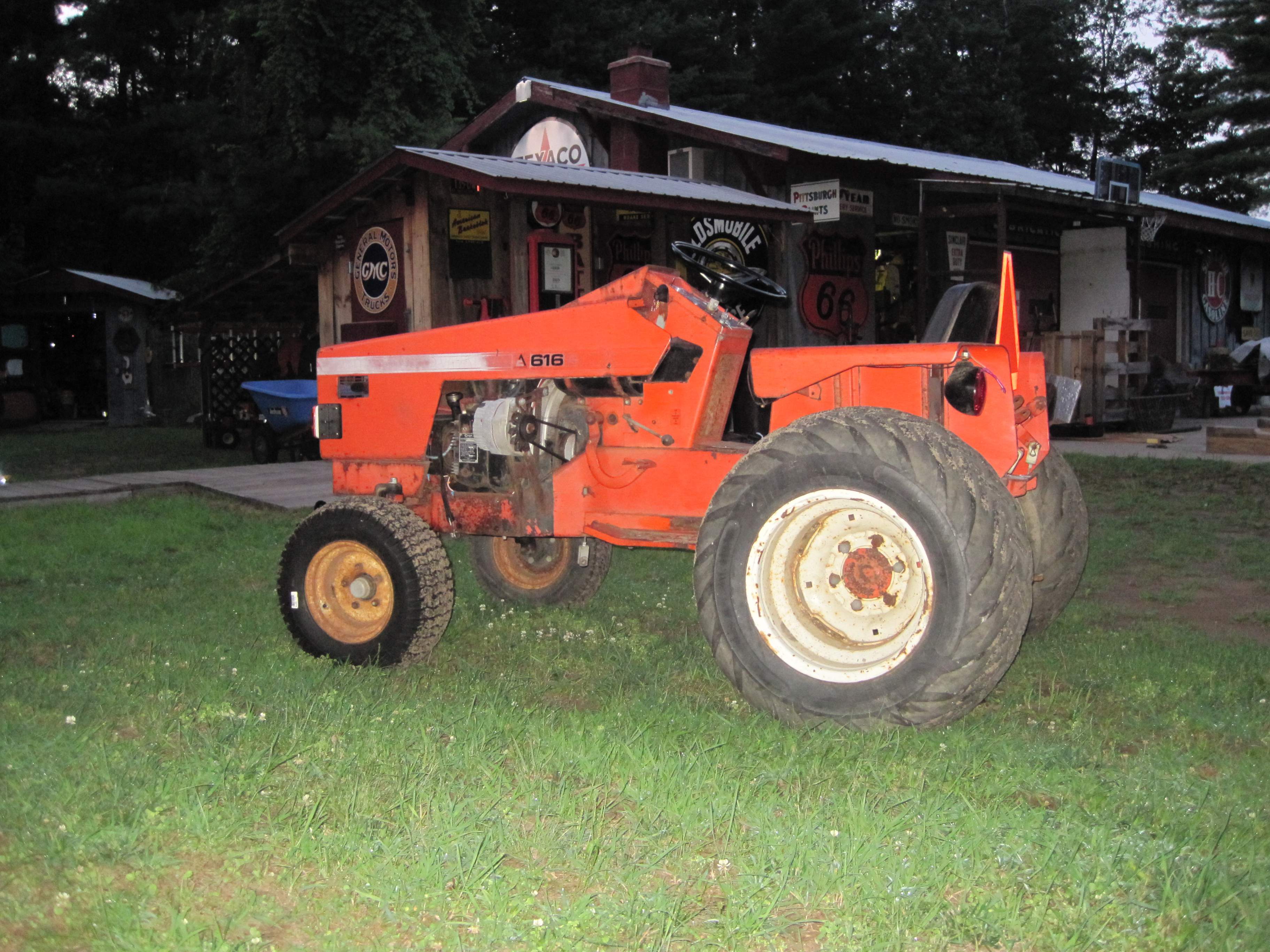

My latest a 1972 or 3 AC 616 of course these where built by Simplicity
I have two 60" mower decks both need work tractor runs well
has both front and rear PTO and 3 pt cat O hitch plans for AC are
blasting "unboltables" and repainting them ( running boards, fenders, hood)
trying very hard to avoid tearing all apart!

Welcome to tbn, never thought of putting a FEL on my Conquest how did you run the pump?

   / New member Simplicity / AC fan
Hi my pump is driven off the front (deck) PTO I have to manualy change the belt from either the mower deck to the FEL hydr pump it takes about 5 minutes to go from one to other yes deck stays on all summer pump and filter under tractor was a tight fit but it works as good as it looks
