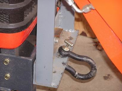

My first question for BX owners....what does everyone use for front weight when using rear implements like rotary cutters or tillers? The weight bar on front is so close to the grill and frame that it's hard to imagine weights fitting on it, and I hate the thought of scratching such nice shiny unblemished paint. /forums/images/graemlins/wink.gif

Congrats on your "new" BX.
If you search the Bota forums for "grill guards", you should find some that guys have made and/or purchased. There are some nice ones out there, like BX23 imitations, that can be had for cheaper than OEM.
I built my own grill guard, but since I have an FEL, I didn't make it to attach weights. A decent welder should be able to fab you something pretty easily that can be both a grill guard and a weight bracket. If I were to take my FEL off and need more weight, I could easily mod my guard to hang some steel off of for weight.
See pic (nevermind the spacer I have in there right now--new to do a little torch trimming!)

I do wish that I had a front loader, then this wouldn't be an issue. I assumed the front steel was a weight bar but it may just be part of the frame and not intended for weights at all. In the picture attached to the last post, the steel I'm referring to is what Ron bolted his brush guard to.
I will most likely look into making my own instead of buying. Thanks for the info.
