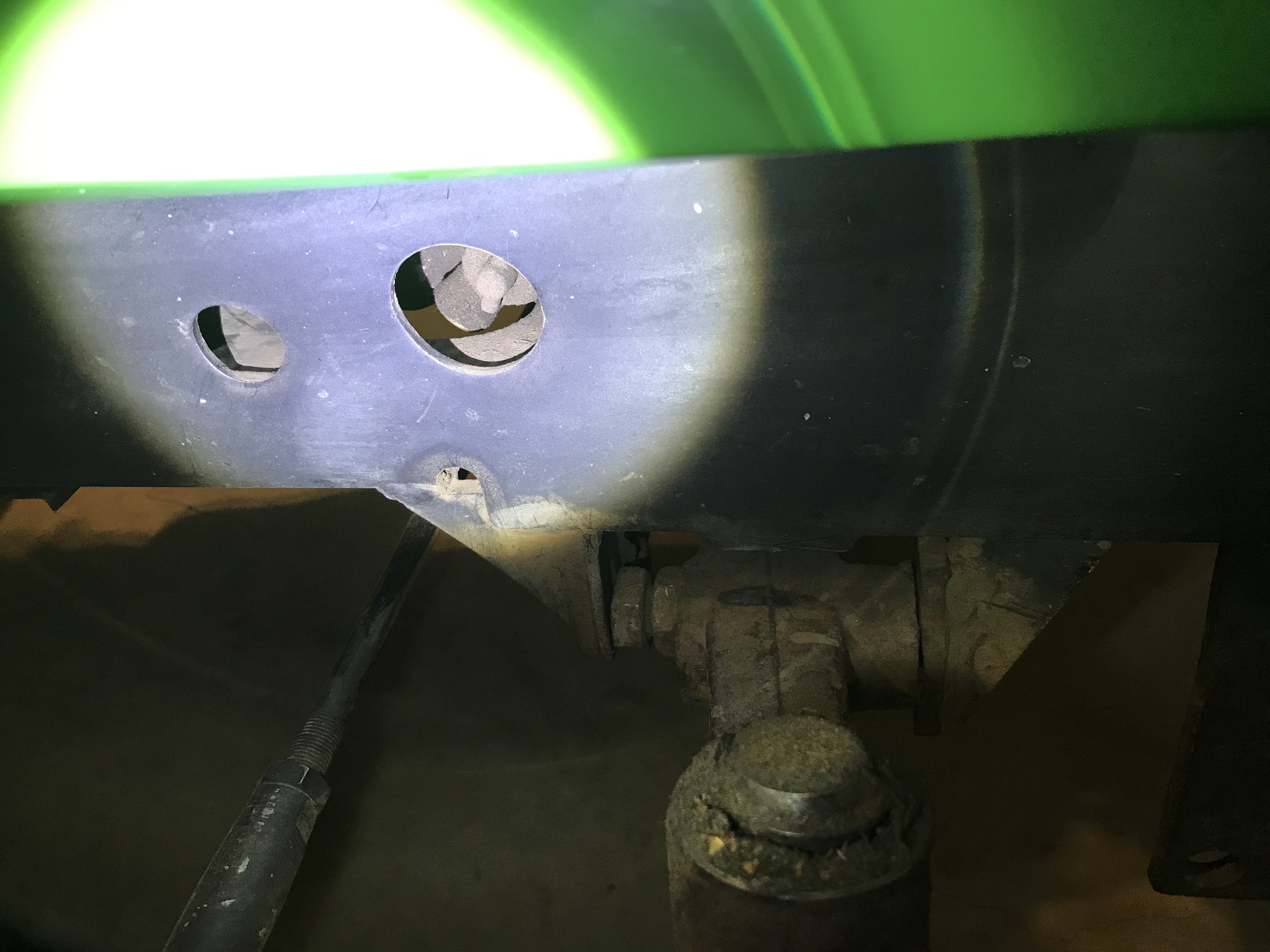

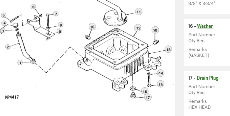

Joined to get some help with a 1983 John Deere 318 I recently purchased, I want to change the engine oil and can't find drain plug. I watched some You Tube videos and all that I found had a access hole on right side of engine with a drain valve, I don't have that hole. Any help would be appreciated thank you.

Think you will find the plug underneath the engine.. Here is a parts drawing showing the drain plug..

There is an access hole in the tractor frame on the right side just above the tie rod. Brass valve and nipple. I put a 6” long piece of tubing on the nipple, I think it’s 5/8”, and open the valve with a pair of needle nose pliers. Many revolutions till oil comes out.
   / New Member
Thanks for the help I was able to figure it out, the oil plug was replaced with an expandable rubber frost plug type. I did get it out only to find that the threads in oil pan are damaged. Looking into repair options that I can do with out pulling engine hopefully. My 318 doesn't have that extra side hole for the brass valve.
