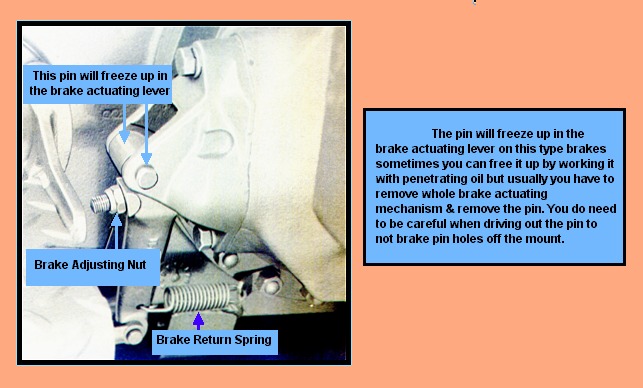

1) How do I adjust the brakes? They don't seem to be doing much.

Block the front wheels so it can't roll, jack up the rear end until the tires are just off the ground, and block it up. Un-hook the rods going the brake levers, turn the tire while tightening the adjusting nut until you feel brake just start to drag. Put the rods back on, and adjust them so both pedals stop in the same place (you want about 1 inch of free play in the brake pedals). Lock the brake pedals together then test the brakes to make sure they stop evenly. You may have to re-adjust the brakes to make it stop evenly, if they won't adjust, or stop evenly you probably need new brakes.
