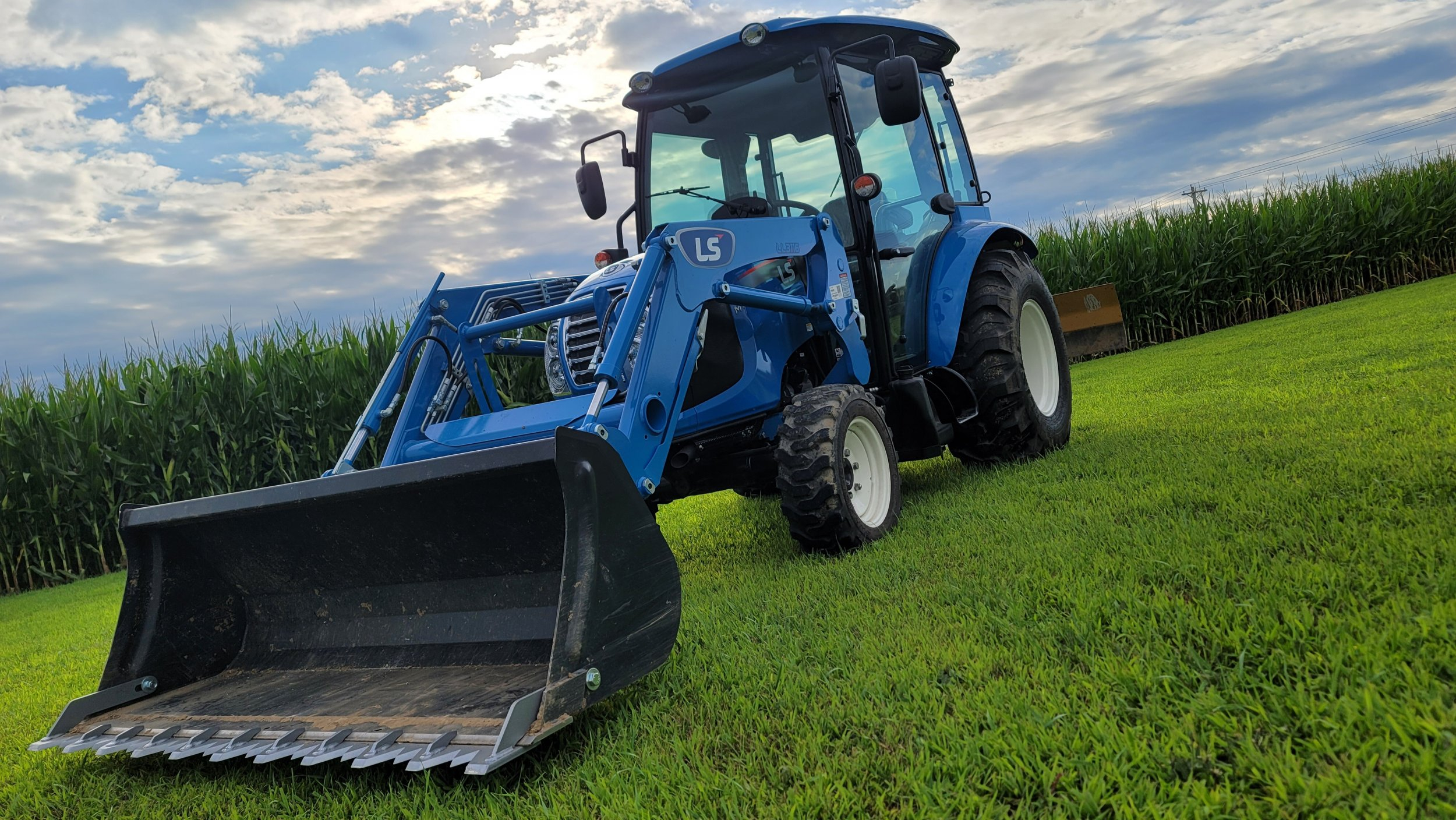

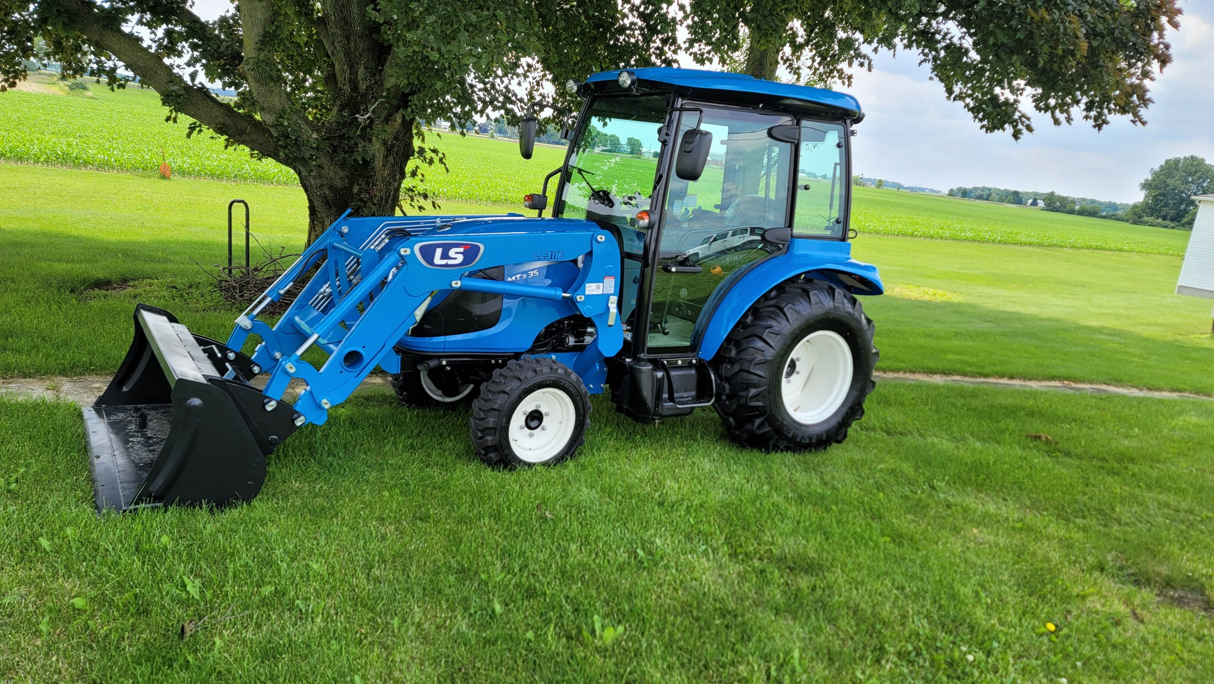

First post, new mt335HC.....first off.....this thing is fantastic. Second, just went into regen at 12.2 hrs...give or take, thats when i saw it at least and started my stopwatch, and she stopped at 9 minutes. It definitely started earlier but thats when i noticed it. I kept the rpm's at 2400. Since I took ownership, I've tried to keep rpm's up(over 1500 but usually over 2000) until I stopped, then I'd let her idle and let the temp smooth out. Always let her idle around 1000 on start up for a few min and let her idle down around 1000 before shutting off...as recommended. I know this is pretty much a rebadged xr3135...at least that's what I've gathered. Is this normal or is there no normal regarding these things? I need to make another post with a review of this thing but I wanted to throw some hrs on her beforehand...until this random early regen. Also, I was running her pretty hard digging a slope and backstop for a shooting range...also, another thread but I was working her 10 times harder than the first 11 hours. Should I be worried or just let her eat?!?!

Just keep on working it! Sounds like the regen occurred without a glitch and completed. See when the next one happens.

Roger that, I guess no harm no foul....just made me nervous. I was under the assumption it wasn't suppose to regen until around 50 hrs. Who knows, maybe I was running too low at first and babying it. I'll reply back when she regens again. Thanks LS Tractor Owner.

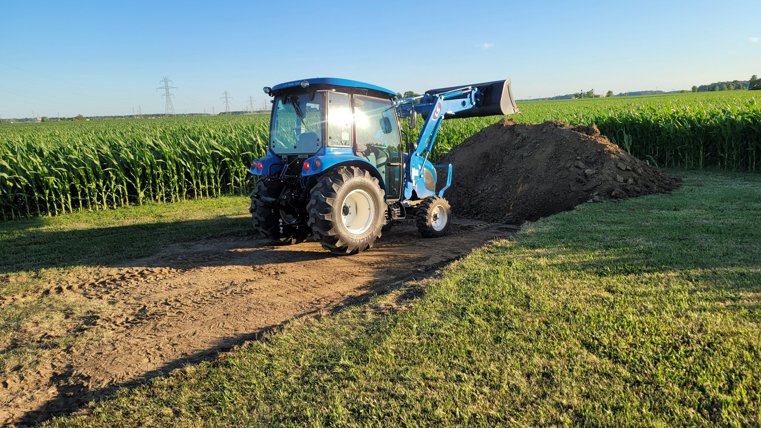

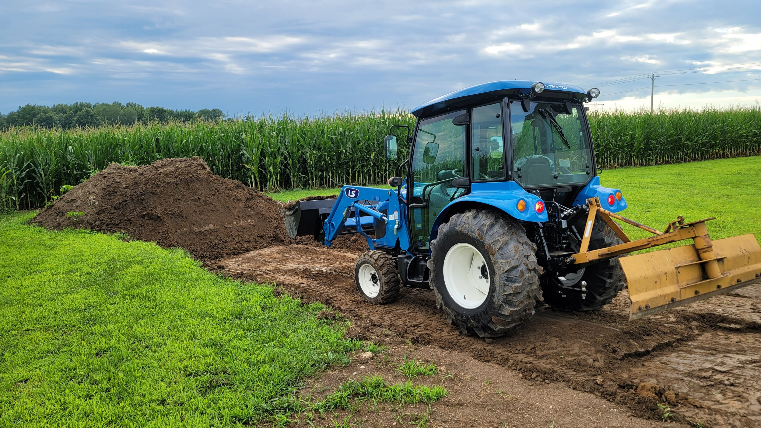

Hey there gents, just wanted to give an update. I'm at 29 hours and haven't had a regen since the one at 12 hrs. I may have been babying her too much in the first couple weeks and clogged up the filter a little too prematurely. Ever since I've cranked her up over 1500 rpms, usually in the 17.5k+ and she's running like a champ. Just got my Piranha tooth bar after exactly 5 weeks and it's pretty sweet. I have great dirt but the new Piranha really helps cut through the deeper compact stuff. Not too mention it looks bad*ss haha(as long as I don't accidentally whack my ankle on it walking around it...damn that thing is sharp!! Like razor blade sharp!!) Here's some pics of the shooting backstop I'm digging out. I also had the rear tires filled with Rimguard. That really helped with traction. She's got more power than weight when digging. Even filled she spins all 4 wheels like nothin. When the backhoe comes in it'll help even more! I'll update again when she decides it's time for a regen. It really hurts me to crank up the throttle but hey....if that's what baby wants....nobody puts baby in the corner lol

First regen may have been from the tractor being started at the dealership and transporting it. A lot of starts, short runs, and stops. No time to heat up. No way to know how many customers wanted to start it.
