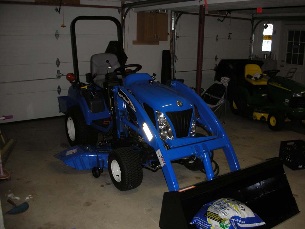

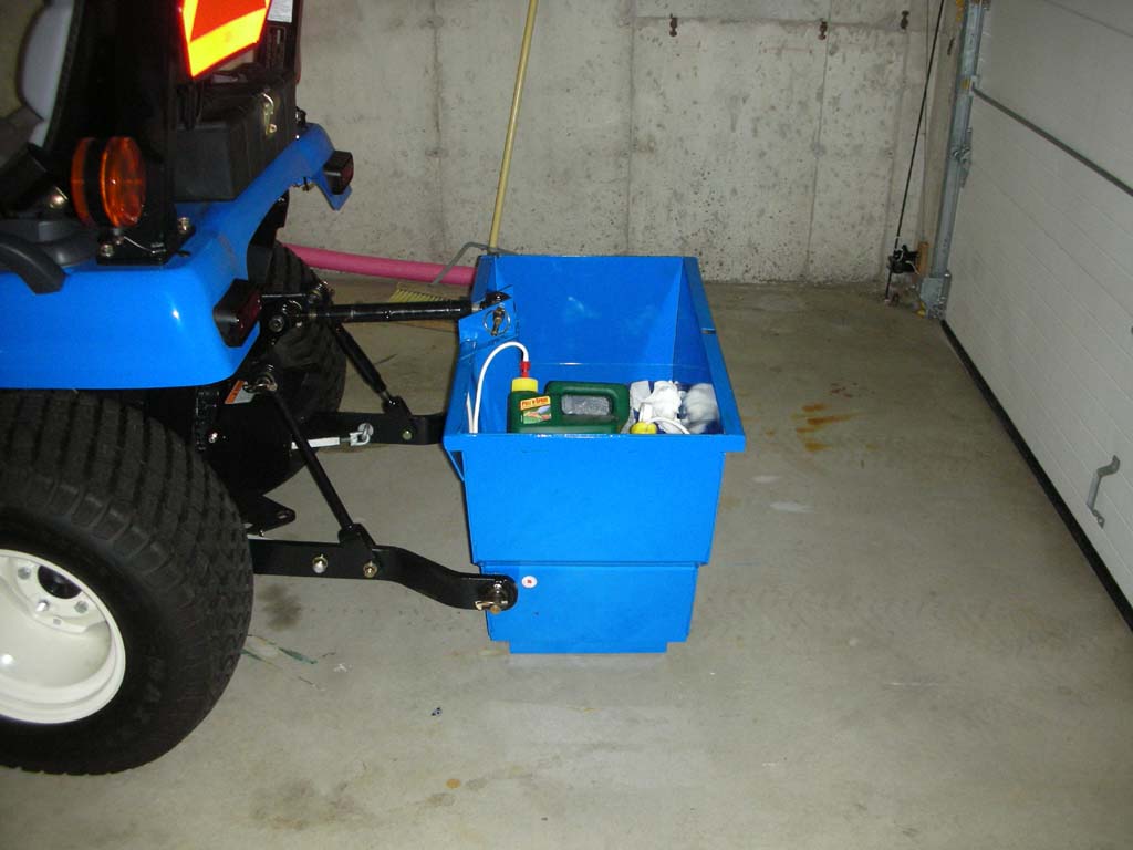

Tractor arrived yesterday...
Love the power-steering, cut quality and am very impressed with the power and quiteness of the engine. Neighbor has a BX2230 and he commented on the size, quiteness and general ergonomics of the tractor. I drove his last night and it's definetly not a TZ!!
Buying bricks for the ballast box. Already had the loader off and back on very easy to do. Going to drop the mmm tonight and spread 14 yds of topsoil I am having delivered today.
Should have bought this years ago....

There's something not quite right about that thing. Wait a minute, I've got it -- you need to get it dirty!
Very nice looking machine! Have fun.

Something to consider...I think block will be cheaper than brick, quicker to load/unload and the voids in the block can be filled w/ concrete to add xtra weight. I went that route and am certain they weighed well more than 60lbs/. Before filling the voids I drilled a hole across both voids (thru the side walls) about centred on its H & W and stuck a scrap rod thru it and a loop of junk chain I had laying around. The void got filled w/ the chain embedded in it which made handling them pretty easy. Just a thought in case it sounds interesting....
